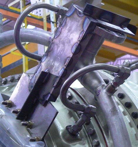

                        Here is a recently designed and made gauge plate jig. The piece with the 4 holes on a PCD was welded to the long broad plate then the four holes were drilled in accurate positions relative to the top edge. The plate that positions the flange was also accurately drilled. The only requirement then is to position the two drilled plates together and tack at 90 °. Tack remaining plates to secure and then stich weld to complete. There is a 6mm step in one stiffening plate and two small recesses to clear the flange in two side plates as well but these just need to be clearance so no great accuracy needed. For this item speed of production was the most important factor so not having to machine all over was an important point.
                        Martin

                                    Posted by Martin Connelly on 14/02/2017 09:19:24:
                                    Martin
                                    Welding gauge plate? Hmmm! Obviously you got away with it but the heat affected zone will likely be pot hard and brittle

                                          You are correct Duncan, hard as it gets but not a problem if you don't plan to do any more machining on it (or drop it). I did not do the welding, it was done by an excellent welder who's job is tig welding stainless usually. As long as he is warned in advance that it is gauge plate he seems to have no problems welding it. If I wanted to I could have it heat treated in an inert gas oven. As stated above this was an urgent job but it has two more occasions in the coming year when it will be used again then if need be a less brittle one could be made at leisure.
                                          Martin

                                          John Rudd
                                            @johnrudd16576
                                            Martin
                                            That looks like the fuel rail on a gas turbine? Correct me if I'm wrong please…
