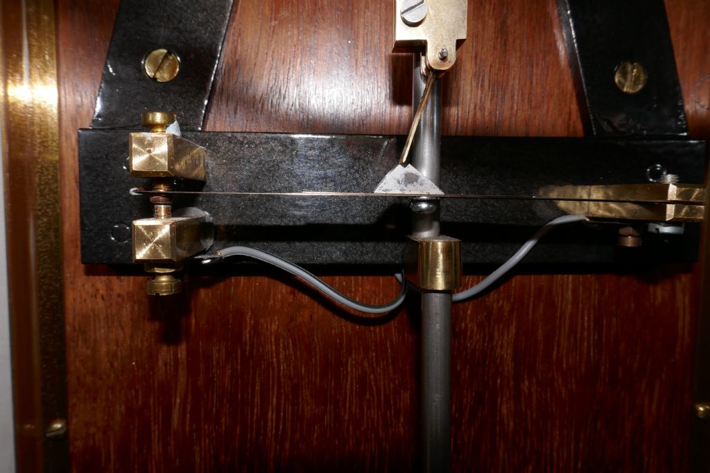

      Rather a long time ago I made my first clock. It was the Wilding Hipp Clock, published in Model Engineer. It was my millennium clock. It has been going more-or-less continuously since then but I can't say I'm happy with the Hipp toggle action, so I'm looking for ideas/advice. The toggle and the notch were both made from hacksaw blade material, which I think was as originally described. Occasionally the toggle would would stick on the exit edge of the notch, making a loud thump. I made the spring lever that holds the notch more resilient and that improved things a bit, however, steel on steel is not a great idea and so I replaced the notch with one made from phosphorbronze. Not bad for a while, but the steel gradually cut grooves in the notch and it started to play up. I went through two versions of the phosphorbronze notch, with different exit edge geometry – no improvement. I then decided to change it all around and I've recently made a notch from silver steel and left it dead-hard. The toggle is brass. It still grabs the exit edge a lot of the time. I guess my next move will be to return to the steel hacksaw blade for the toggle, but has any one solved this problem? I've watched the mechanism in action on the tower clock in the BHI museum. Works every time, despite fairly gentle curves on the edges. Why does mine sometimes stick and that not?

          There is an "improvements to the 3/4 second electric clock by J Wilding" article in ME that shows at least one resolution to this same problem in the 3/4 second electric clock which also has an Hipp trigger- the geometry of the notch is apparently not the best in the original design – this may point you in the right direction for a cure to the problem in your Hipp clock. Not sure of the volume of ME but an index search should show it soon enough.

            I suspect that your present problem will relate to friction in the trigger mechanism, or the geometry of the notch.

              Thanks for your comments. Since my post I've thinned down the edge of the brass toggle and it has helped a bit; it now only sticks on the edge about once in 5 or 10 (approximate, I know, but I've spent an uncomfortably long time staring at the clock; a hidden cost of infrequent pulsing). My collection of Model Engineers occupies a number of cardboard boxes in random order so finding Wilding's article on improvement will take a while!
              My clock differs from Wilding's design in a number of places, mostly to reduce friction and raise the pendulum Q a bit, but the only variations that affect the toggle action are making the lever springy (I don't think that will come into play until after the the toggle has caught on the edge or not) and lightening the toggle. On thinking about it, by removing most of the brass around the toggle base and therefore shifting the toggle's centre of gravity away from the pivot I will have lowered the frequency of it's swing and slowed it's movement away from the the edge of the notch. However, a bit of blue-tack at the base doesn't seem to have made any improvement.
              If all else fails, I may try adding a light spring to the toggle.

                              My daughter tells me that this is a link to a picture of my toggle mechanism:
                              **LINK**
                              I tried clicking on the likely looking icons but couldn't work out how to post an image using the tools on the forum page. Not intuitive for me I'm afraid.
                              Meanwhile, she also lost all my text so here we go for the second time.
                              I feel a bit of a fraud. The toggle mechanism has healed itself and in a few days it has gone from sticking every other impulse to not sticking at all for the last 6 hours while I've been monitoring it. It remains to be seen whether this is permanent. One reason for using a hard notch block was that any material removed might make things better rather than worse – but it might be luck.
                              Assuming the image is available: It's fairly self explanatory. The notch block is a corner of 3/16" silver steel, milled to clean up the edges and add a 90 degree notch. Polished in the immediate vicinity of the notch. Tapped 3mm and then coated with soft soap, heated and quenched in brine with some oil on top. The lever is a piece of clock spring, a hole punched in the middle for the block. There is a shorter piece of spring below it that extends a bit less then half way from the mounting and another shorter piece between the main piece of spring and the block to change the way it bends. The contact is at the left end. The toggle is a bit of brass sheet (not engraving), soldered to a brass tube drilled 1/16" for the arbor. Brass hammered to harden and filed to thin the edge. In the image, the pendulum is moving left to right.

                                  Thanks Michael. Sorry, "if all else fails, read the instructions". I'll try your instructions to show a wider view of my version of the Wilding Hipp clock switch mechanism.
                                  Thanks for the link to that Hipp clock on Youtube. Rather more elegant than mine, although part of my excuse is that I've tried to minimise the weight of moving parts. My first notch blocks were very much lighter than the one at issue, which was born of desperation. I think my criticism of the Wilding design, viewed from where I am now, is that some of the moving parts are a bit massive.
                                  The image was taken with a Lumix on the widest angle, so the perspective is a little odd. The arrangement of the pieces of spring in the lever may be visible, although as I'm typing this it looks as though the resolution has been reduced. The observant may notice the BlueTac preventing the screw on the left from moving.
                                  The notch is offset to the left by rather more than I intended (yes, I should have measured more carefully) and the result is that the pendulum arc is quite large. However, it works! And without sticking for a good day and a half now, so I'm loathe to interfere. As a watch repairer said to me when I'd managed to re-assemble my wristwatch "quit while you're ahead". Maybe next time it comes off the wall for the decorating. Or sooner if the large swing continues to offends me.

                                    The clock has only made one loud noise (in my hearing) in the last few days. All other switching events have been quiet. So it sounds as if the toggle no longer sticks on the edge of the notch block.
                                    However, I connected a 'scope across the solenoid. The pulse is generally about 130ms with most events between 110 and 150ms. Occasionally though there are 300ms events. I recorded two of these and I was watching the second. The toggle caught on the exit edge and so pushed spring lever further down and closed the contacts for longer. It was quiet because the toggle didn't slip off.
                                    So, the noise is cured, but not the fault. Has anyone out there made similar measurements on a Hipp toggle?

                                        I suspect what you are seeing is an inherent problem with the Hipp toggle – unless everything is precisely aligned, the trigger and notch are perfectly hard and have very sharp edges, there is always the possibility of the trigger "catching" on the edge of the notch rather than in the base of the notch as it is supposed to do. My version of the Wilding 3/4-second pendulum clock has always exhibited this behaviour, and I pretty much gave up on fixing it; the clock keeps good enough time so I ignore it. However, that is one of the reasons that eventually led me to build a pendulum with a similar drive mechanism but which uses Hall-effect sensors to detect the pendulum swing amplitude, which removes the problem altogether – see link. I am tempted to retro-fit a similar solution to the Wilding clock at some point.

                                          Regarding the original post. Not entirely sure the steel on steel aversion is relevent. Fair comment regaring bearing surfaces but in the toggle the action is either batting the lever out of the way or sliding into the notch with very low friction. I would be interested to know if the toggle block or lever or both become magnetised to any extent. I can see that messing things up and creating unexplained issues that dissapear after a while.
