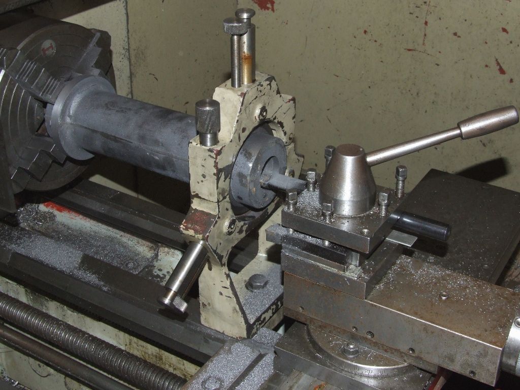

      am planning on getting a steady for my Clarke lathe.
      which one should I get first travelling or fixed steady?

          For me it would be a fixed steady, in fact I have two fixed steadies (different capacity) for my new lathe and wouldn't be without them. I rarely use the travelling steady that came with the lathe.

              I've used the fixed steady that came with the lathe quite a lot:
              As yet I've never used my travelling steady, other than to check that it fitted as it was bought separately.

                  Fixed steady always first, unless your cutting a long thread.

                      Consider what you might use it for would be my advice, are you going to be turning long thin stock quite a bit? Or you might have a very large piece of stock, say bigger than an inch dia. so it wont fit through the chuck but you don't want to use a shorter length and need a way to support it whilst turning, use a center of course, but how are you going to center it?
                      This is precisely the occasion it would be used for and many might not consider the fixed essential, but definitely important but the traveler could be considered for later.
                      Also, if you're going to use a different style tool post than the 4 way that comes with the clarke, your new toolpost may not correlate with the position that the traveler bolts to, so you'd need to do more moddery before that worked, but the fixed is pretty much timeless provided you dont change the bed!

                        I agree with the above. I hardly ever use a travelling steady. The fixed on the other hand is used now and then. On lathes with small spindle holes they can be used for working on long bars that wont fit through the mandrel, which saves waste.

                              Unless your stock is perfectly round, it would need a bearing surface cut before using a fixed steady, so would need a centre as the first operation(?) and only needed for internal work on a long workpiece. If you turn long thin sections a travelling steady is good.

                                  If the stock isn't completely round and you can't think of a way of centering it (usual way is centre square, punch and drill a centre by hand) you can make up a tube with two sets of 4 radial screws. Slip this over the component and adjust the screws so it runs true, then put the steady on that. Yes it's a right faff, but it might be all you can do if say you want the steady in the middle of a long forging

                                        I regard a fixed steady as essential particularly when working with long bars that will not fit down the headstock spindle bore,the travelling steady is very useful on long thin work to stop deflection,but can take some job planning as the steady always gets in the way of either the chuck or a fixed part of the lathe.and not easy to use when working up to shoulders. I use my travelling steady occasionally when cutting long threads on my Colchester Triumph,particularly square and acme threads, full size traction engine brake shaft threads and a threaded shaft for a sluice gate come to mind in recent years.my work covers agricultural , full size steam and stationary engines plus some models so my machines must be well equipped to cover a variety of work
