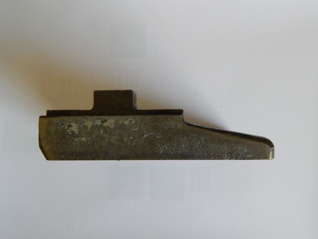

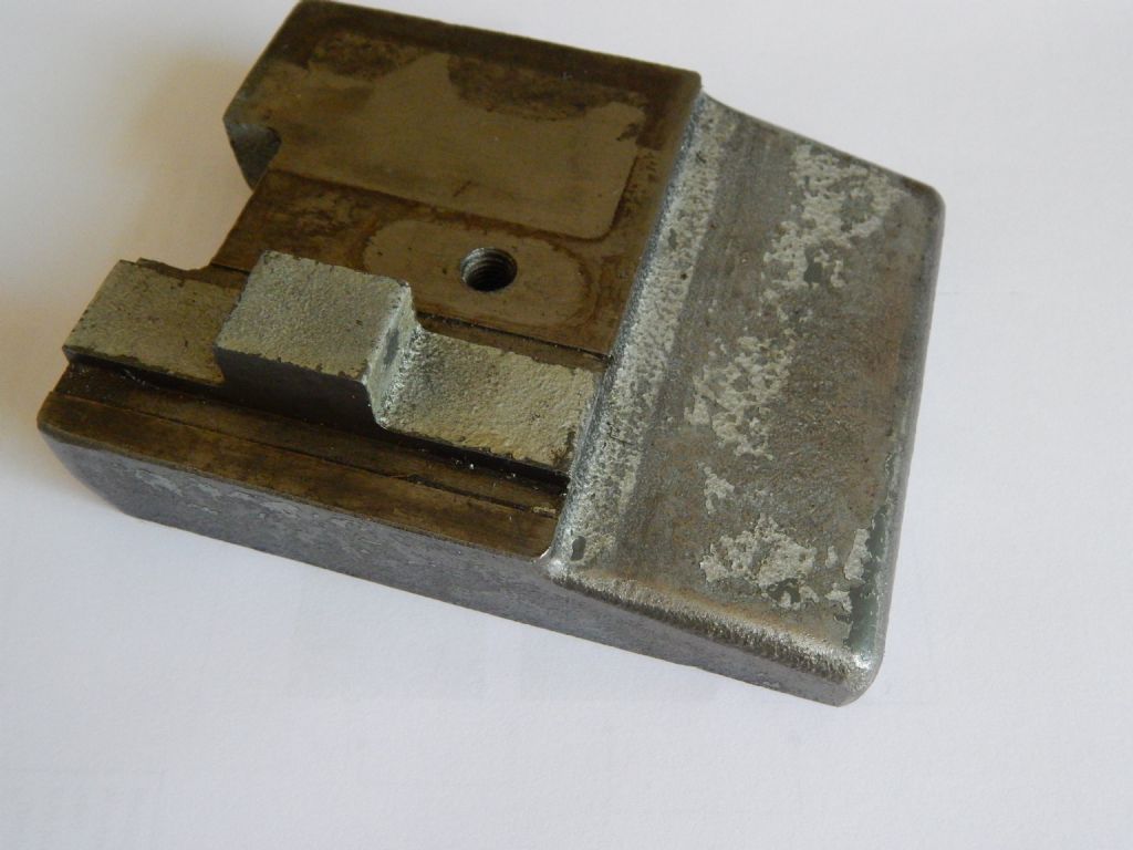

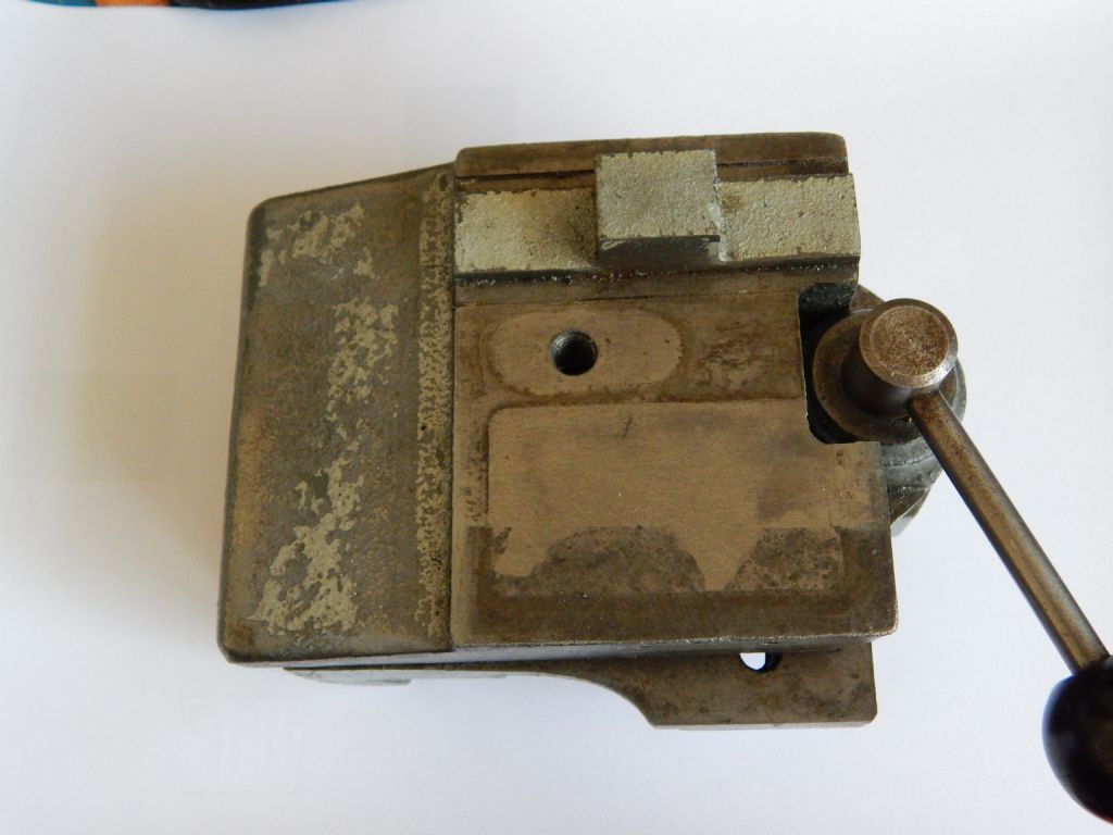

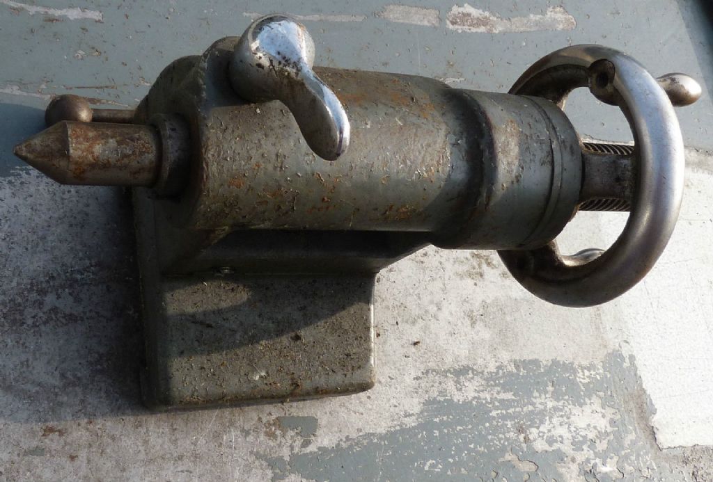

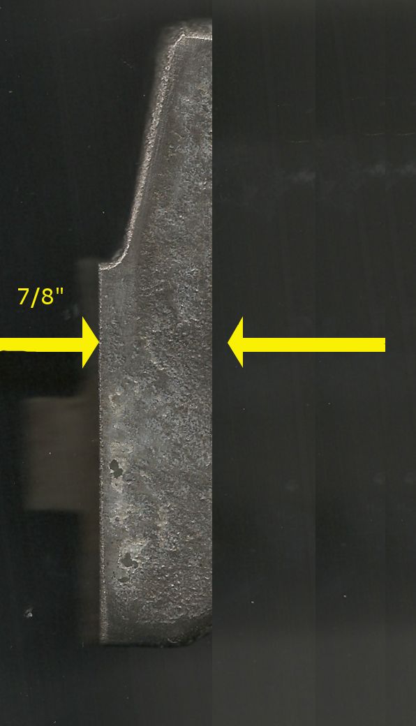

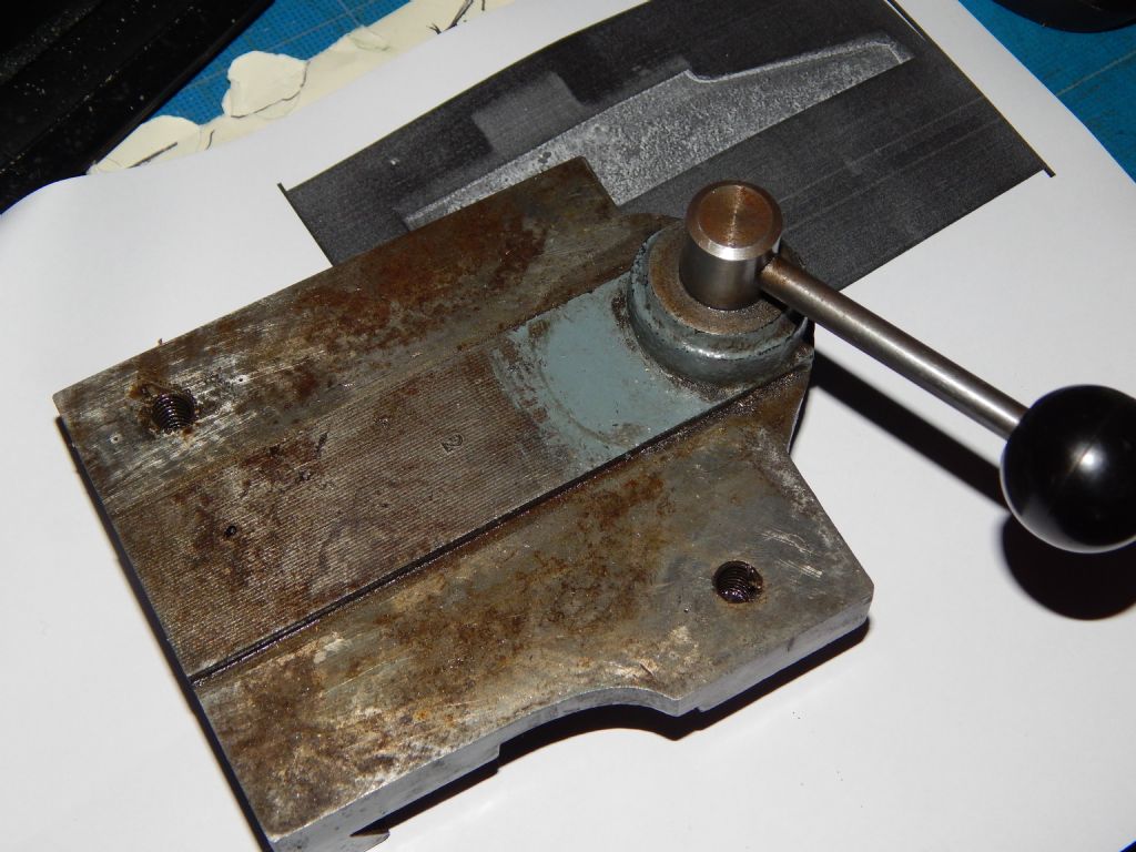

                Thanks a bit late am working on a new project to convert ML10 tail stock to Drummond 3.5" bed. This is the first idea i come up with to cut down the ML10 saddle to bolt onto the Dummond Saddle kike the old one did making a mating surface for the new MT2 tailstock.
                Here i s what i started with
                Original ML10 Tailstock
                Here is the bottom part
                Here is it cut down on image software
                cut off for saddle first try in picture editor
                Cheers
                MN
                Edited By Martin Newbold on 08/10/2016 18:48:36
                Edited By Martin Newbold on 08/10/2016 19:07:51

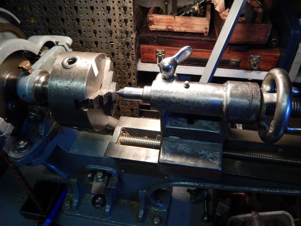

                  Here is what its going onto
                  Existing tailstock Saddle
                  #260017
                  Martin Newbold
                    @martinnewbold
                    I am hoping at least one of the screw holes will line up.

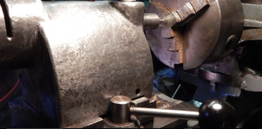

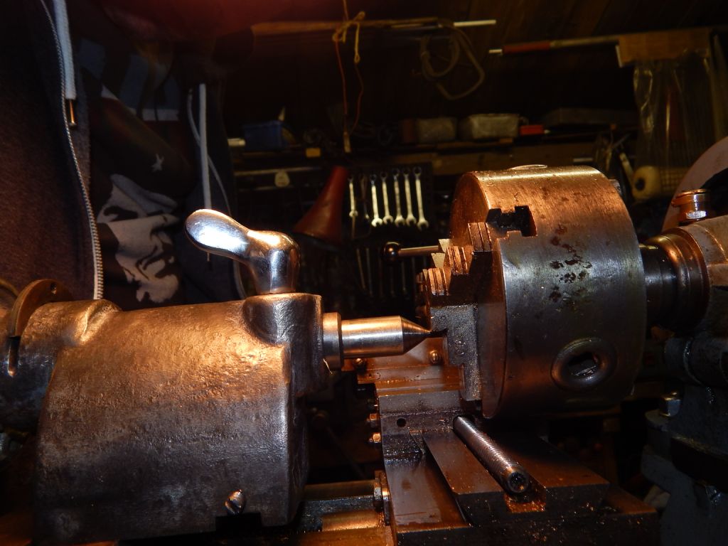

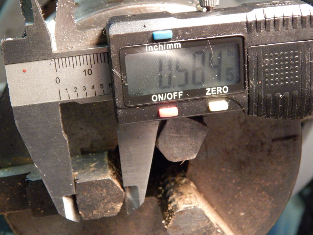

                      #260173
                      Martin Newbold
                        @martinnewbold
                        chuck tooth
                        Mocked up on tailstock saddle to measure vertical displacement
                        Try to see if the top was put on teh saddle where the vertical centre came
                        Difference from Drummond tailstock saddle to center calculation
                        Chuck Jaw height: 0.5845”
                        Tail Centre Dia: 0.1135”
                        Chuck Hole ½ Dia: .039/2”
                        Total .7175"
                        First cut will be .08” leaving difference from block to correct height .0825" to remove if all goes well. Does this seem right?

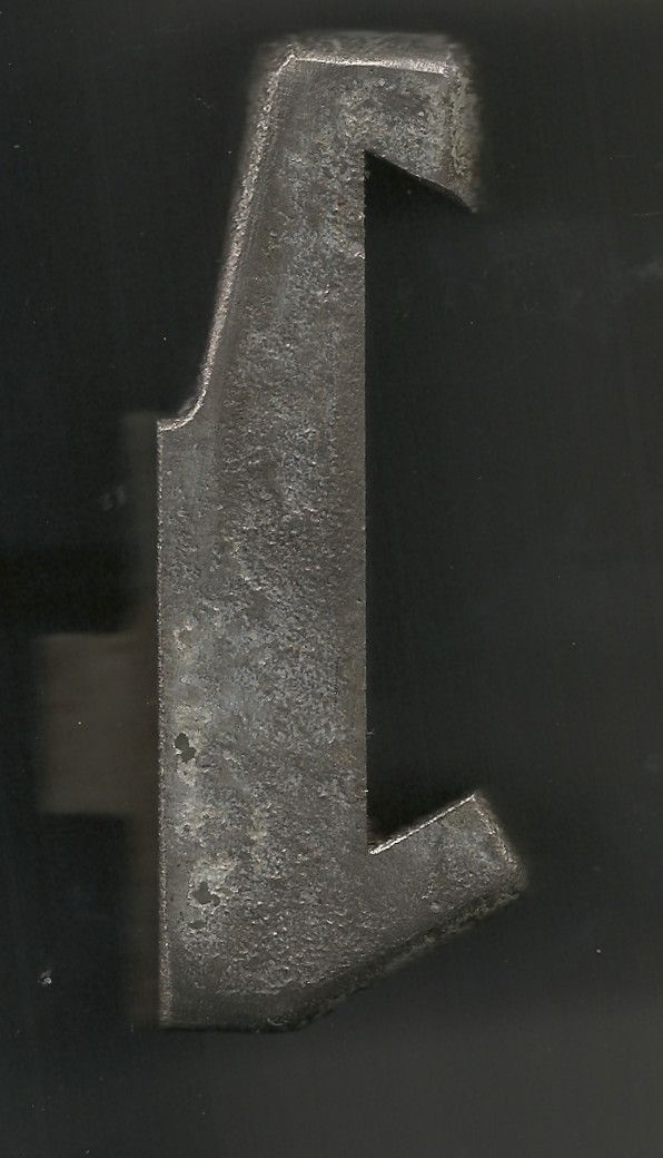

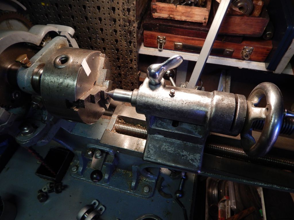

                          Some cutting down today much more to cut around 5mm to get centres same as mt1 tailpiece. Intend to take some from top and some from bottom.
                          first cut removal of the lower parts
                          flat bottomed now
                          #260332
                          Martin Newbold
                            @martinnewbold
                            Here is first try much more to cut down
                            first trial to see how it will fit
                            #261543

                                #261695

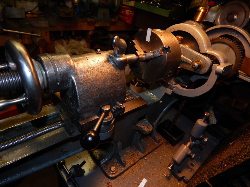

                                Martin Newbold
                                  @martinnewbold
                                  Did a bit more to this got horizontal in the ball park and just vertical is out now . Will remove 1mm and see again
                                  Getting closer only out in horizontal now
                                  horizontal is great adjusts up nicely
                                  Still have some material to remove . Going to remove 1mm next and then  try again
                                  MN

                                  Steven Greenhough
                                    @stevengreenhough56335
                                    A bit late to the party but…
                                    It might be worth using a center in the spindle nose rather than a chuck? Might be that bit more accurate?

                                    Martin Newbold
                                      @martinnewbold
                                      Here is the reverse showing the ML10 interface with the old Drummond saddle which was under existing tail piece.Provision has been made to retrofit the MT1 tail piece should it ever need to be. Stil have approx 2mm to remove from top was able to remove approx 3mm from bottom. Am going to take it slow here so i can get it as tight as possible 1mm at a time.
                                      Showing interface with ML10 and old saddle
                                      Regards
                                      MN

                                        Posted by Steven Greenhough on 18/10/2016 13:35:46:
                                        Yep Steven , thanks for the tip . I am still considering how to get it dead accurate . I need a 5/8 16 MT2 for my chuck to get the big chuck on it to hold something other than what I have . I have about 2 mm to remove approx so am going to take another 1 mm before I get into working out how to get it exact any ideas would be really helpful. Wont do this until next week.
                                        MN

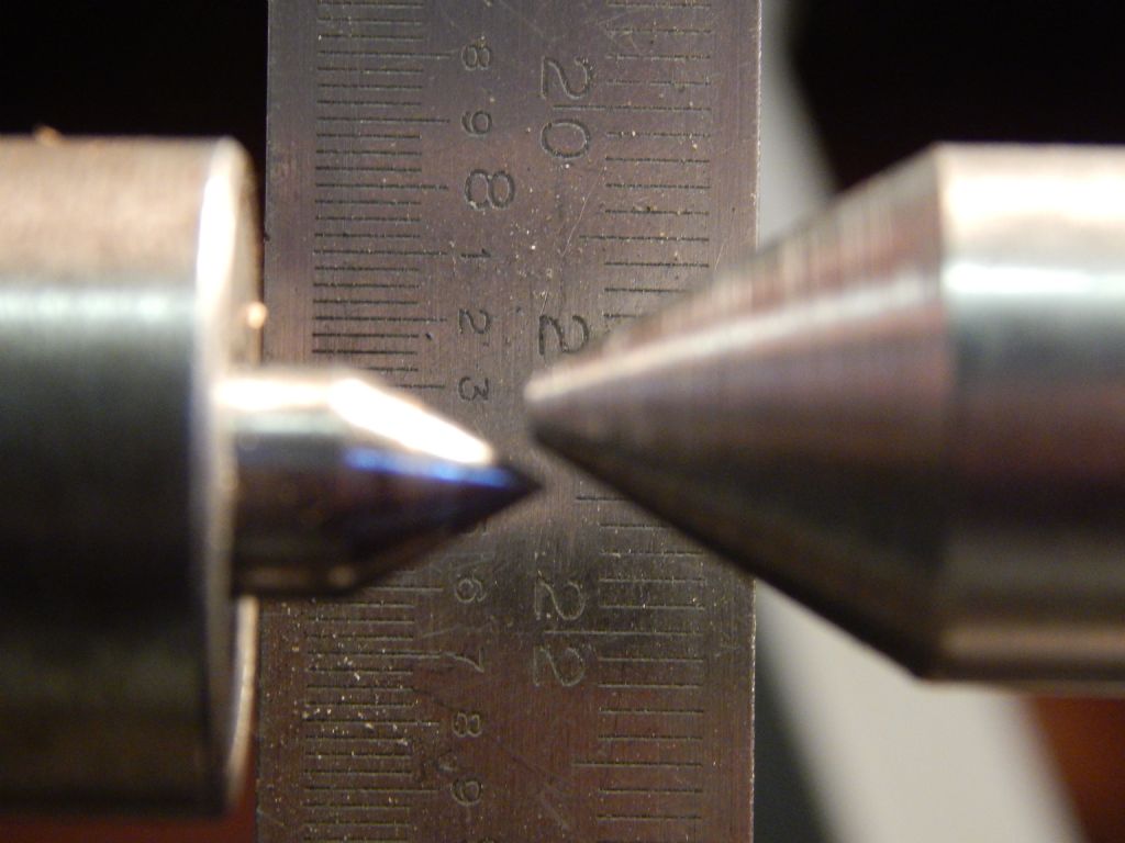

                                        Martin Newbold
                                          @martinnewbold

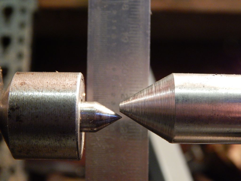

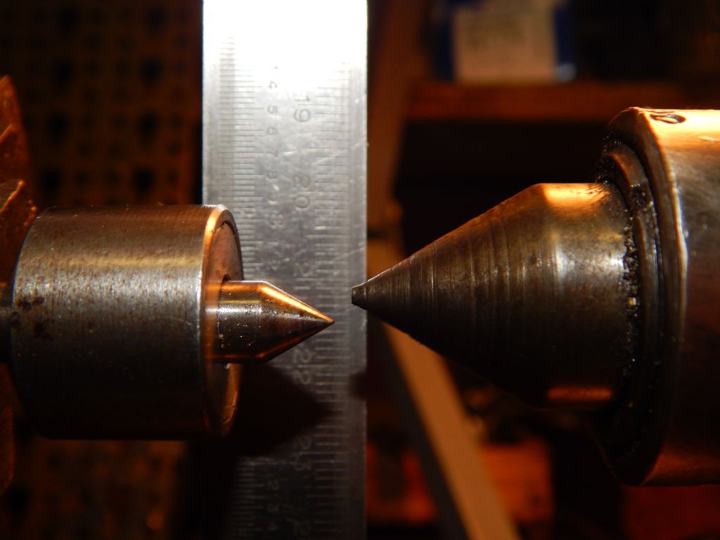

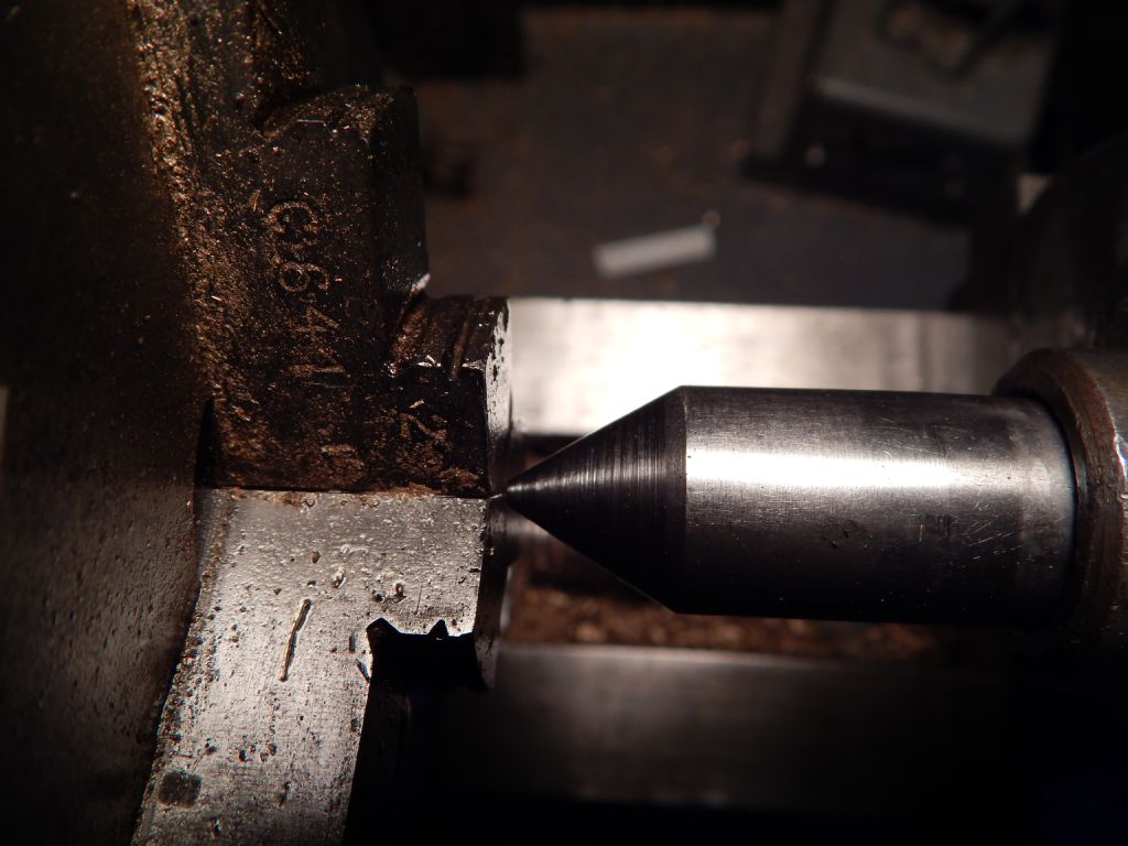

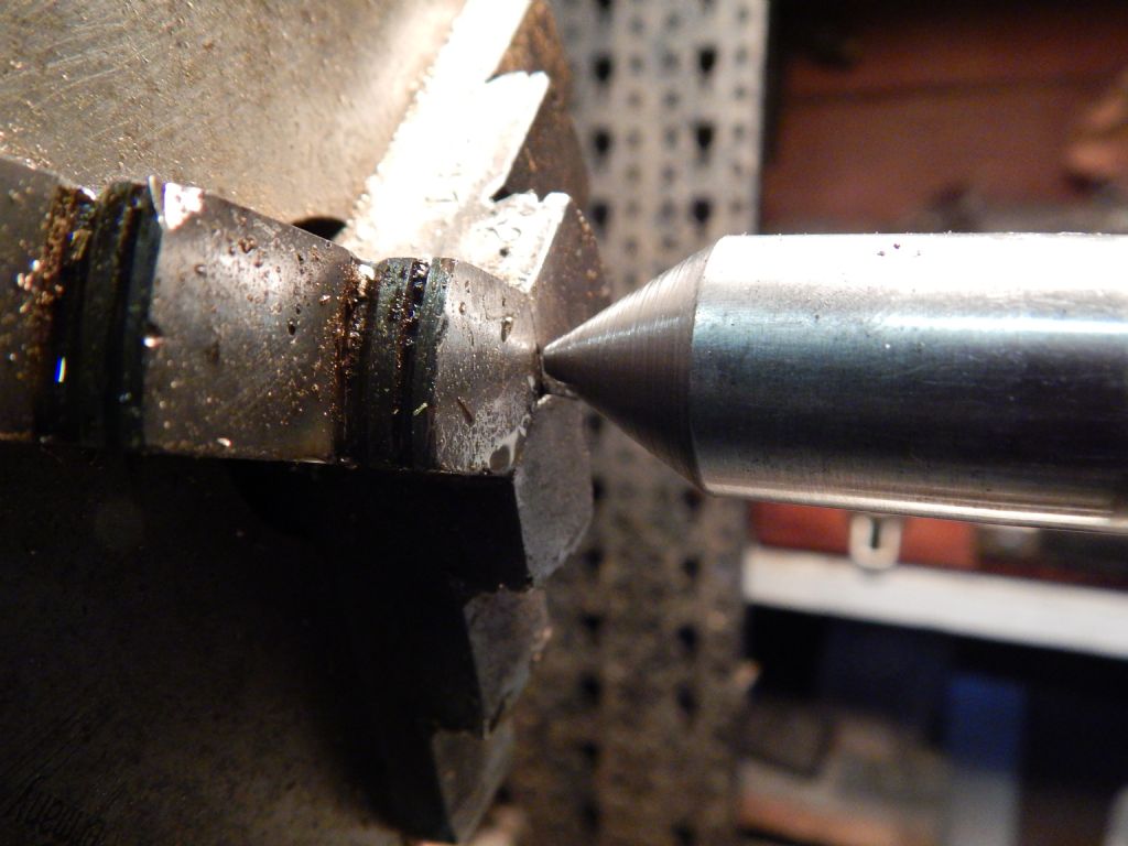

                                          Here is a ruler behind them in focus on the ruler then on tips
                                          In focus on ruler
                                          In focus on tips
                                          #261709
                                          MadMike
                                            @madmike
                                            All very interesting, but are we not missing the obvious here. The centre height of an ML10 is a known dimension. So why are you messing about trying to match a centre to the centre of a set of chuck jaws, or to another centre mounted in the headstock or a chuck?
                                            Why do you not simply assemble your tailstock, then measure the position of the centre and simply machine the base, however constructed to match the known ML10 centre height? It seems so straightforward to me, or am I missing something here? It almost feels like you are all trying to re-invent the wheel to me.
                                            #261710
                                            MadMike
                                              @madmike
                                              I have just looked at the photos again. Is it me? You don't even have a complete centre in the tailstock, so how do you hope to match up the tips of the 2 centres when of them is not actually available to line up?

                                              Muzzer
                                                @muzzer
                                                Posted by Martin Newbold on 18/10/2016 13:54:37:
                                                If you turn a taper onto a piece of bar stock – or better still, take a skim cut on a dead (ie soft) centre – you will end up with a dead accurate indication of the true centre. Doesn't matter what the spec sheet says or even what you measured – the point you cut will be at the actual centre height. If you remove the bar or centre, you should probably re-skim it each time.

                                                Martin Newbold
                                                  @martinnewbold
                                                  Posted by MadMike on 18/10/2016 14:26:12:
                                                  Hi Mike,
                                                  It’s going to need the surface milled off to line them up. I have not an MT2 dead centre at present as one is on order but has not arrived.
                                                  I might be able to borrow one before i start taking more material away on Monday. The ML10 may be a known dimensions but the Drummond is not known by me. In addition this is made from a construction of the ML10 tail piece to mate onto the existing Drummond 3.5" wide bed slide. Thanks for the criticism I think http://www.model-engineer.co.uk/CuteEditor_files/images/emsmile.gif do i get dinner with that http://www.model-engineer.co.uk/CuteEditor_files/images/emsmilep.gif
                                                  MN

                                                    #261928
                                                    Martin Newbold
                                                      @martinnewbold
                                                      I put a ruler next to a sharper dead centre and found it was 2.75 lower this gives an eventual height for he conversion of and final height would be 15.75mm.
                                                      final drop is2.75 after removing 3mm from bottom
                                                      MN
