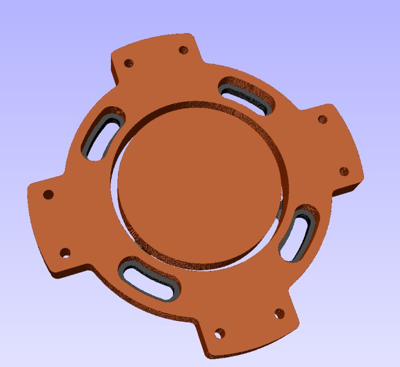

                                          As part of my job I have to make brush rings for DC motors, usually fork truck motors as some of these can cost £3,000 each so well worth repairing.
                                          What normally happens is for various reasons they catch fire and burn the insulation ring that holds the brush boxes so new ring needs machining out of Tufnol and the boxes re-riviting back on.
                                          This is a typical ring.
                                          This is the simulation of it from Cut2D which is a cheap ~ £100 program.
                                          At one time I would have band sawn a blank out of a sheet of Tufnol then using the lathe, mill and rotary table would have knifed and forked one out, Realistically between one and two hours to do one.
                                          Now days I draw it up, that takes between 10 to 15 minutes tops as you only need to draw the detail in one quadrant and mirror it twice to get a complete drawing. Programming is done in Cut2D and I use one tool, the biggest that will fit into the smallest slot. Tool changes take longer than extended cutting.
                                          Literally nail a sheet of Tufnol to the bed of the router as it has a sacrificial MDF bed and press go.
                                          That ring is about 7" diameter in 8mm Tufnol and will take about 18 minutes 44 seconds according to the program, so in under 30 minutes I have a one off that would have taken me 2 hours in the past.
                                          Another 20 minutes I have a spare if needed.
