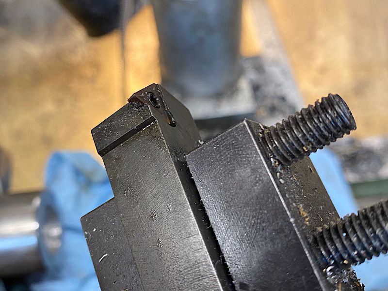

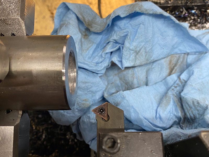

                                                Ian Parkin
                                                  @ianparkin39383
                                                  When i started this thread i suppose i was looking more for a tool for 45 degree chamfering rather than deburring
                                                  anyway after all your thoughts i bought this tool from chesterfield machine tools on eBay….it works a treat and can do perhaps a 3mm internal chamfor.and much larger external chamfor3a17f94f-b230-4ef5-a756-f2ad7ed0618c.jpeg
                                                  #489414
                                                    Does not look like it gives a 45deg chamfer to me unless you were to mount the holder at an angle?
                                                    Something more like this that holds square inserts at 45deg would give what you say you wanted
