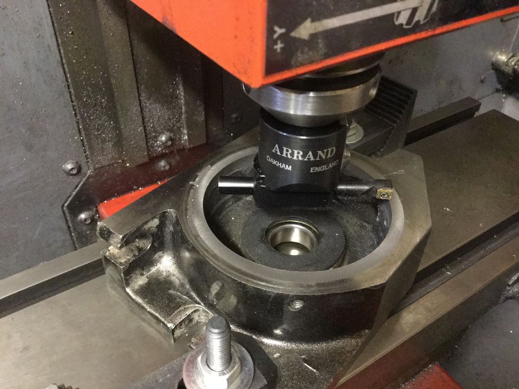

      hi, I purchased a boring head and some tooling for it from rdg tools. the thing is that when I put the cutting into the head the cutting face is the wrong way round to the cutting face. my milling machine is a tom senior e type and the mill cuts clock wise, but the boring head only works anti clock wise. is this normal ?

          Sounds more lihe you have the tools in backwards, can you post a photo
          Should look something like this

            I can't remember where I got my el cheapo boring head from, but it had the same issue – tooling ground for the wrong hand. My mill will run either way, but clockwise is the normal. I simply reground a cutter. Note the singular – I don't use it very often and have only needed one tool. In order to make it useable I also replaced the tool and slide locking grub screws with proper US/UK ones.

                  Just noticed that RDG sell normal and "opposite hand" sets of tools. Did you order or have you been sent the wrong ones?
                  The brazed ones can be reground no matter what hand they are, just grind the curved surface until it is straight. I have done this on a few cutters for when I use the head to turn external diameters rather than bore holes

                        I also found that I needed to buy a left hand boring bar for my boring head. Confusion prevailed for some time before I sussed what the "problem" was with the supplied RH tools!

                          Thanks chaps, yes I had the wrong side cutters send. More delay added to the job.
