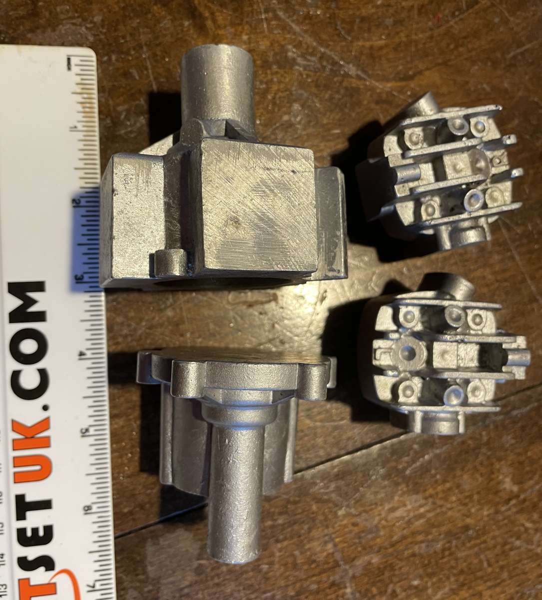

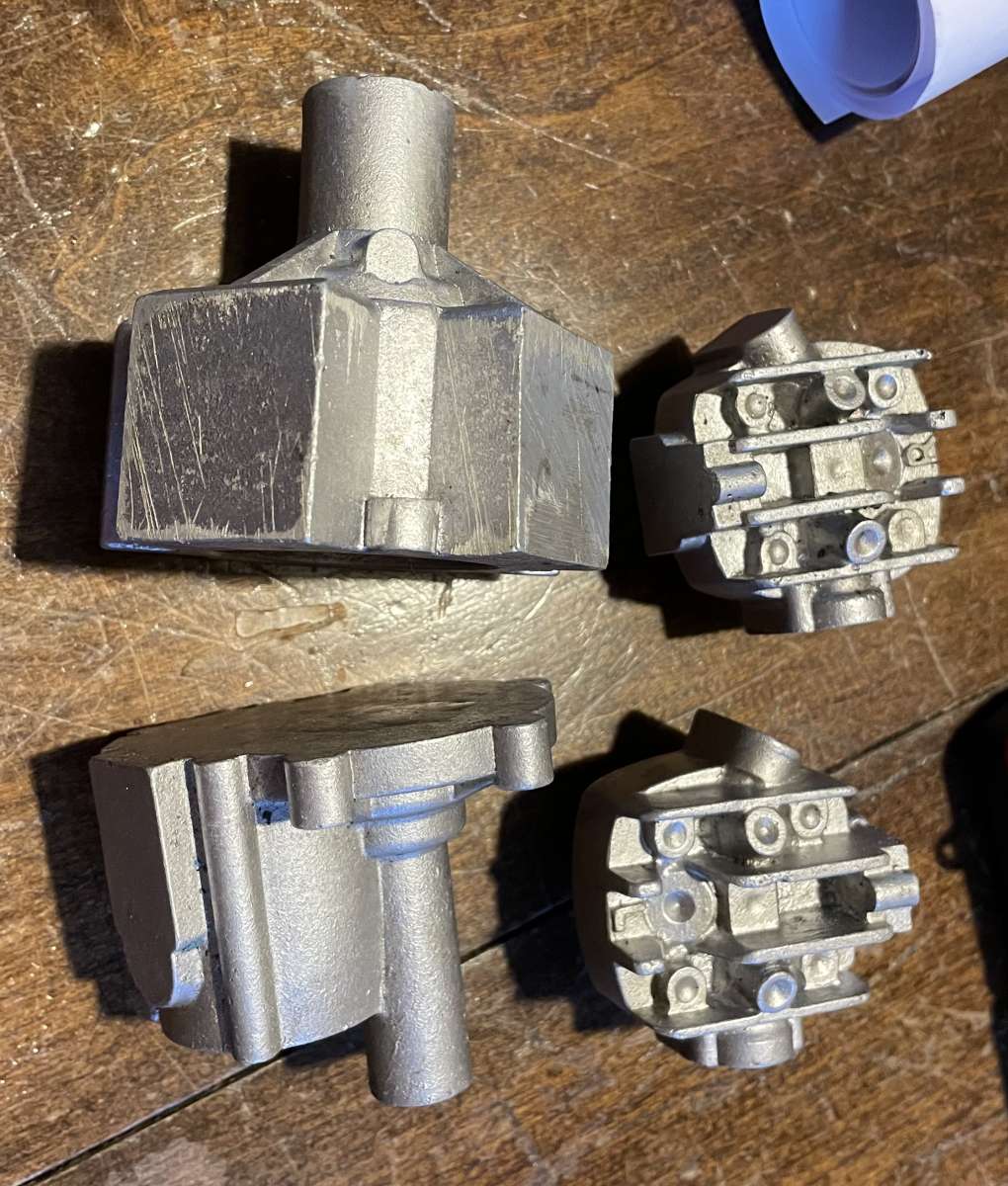

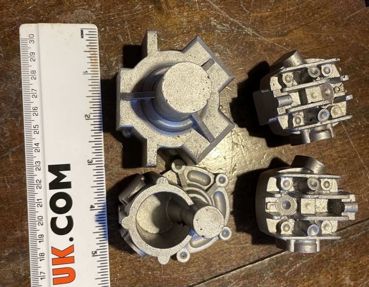

      I bought a job lot of castings from a recent auction, one is a small V twin anyone recognise them and could I get the drawings.IMG_1363IMG_1362IMG_1364

        Chenery 15cc V twin I think, His son should be able to supply the drawings

          They are definitely Les Chenery’s 15cc V Twin as Jason suggests. The build was serialized in Engineering in Miniature starting with the Dec 1983 Issue.

            Thanks Jason it certainly looks like it, have you got the contact details for the son please.

              Try this for his son John [email protected].
              Hemmingway did list the engine at one time so you could also try Reeves who have taken over Hemmingway

                They look a reasonable set of castings. I made this engine from a Hemmingway kit some years ago, but I notice they no longer list it. I have the set of drawings in A2 size, so not easy to copy, but if you have no success with obtaining  a set, I am sure we can find a way for me to copy them. If you are serious about making it, I also have the table of off-set figures for milling the cams. These were produced using the Cam-Calc programme, originated by Rod Jenkins, a frequent visitor to this site.

                    Thanks for all the help, I have ordered a set of drawings from John Chenery amongst the information he sent are the dates of the article in EiM which could be useful.
                    i bought the casting because there is a Sugden Special casting amongst them which i have always wanted to build.
