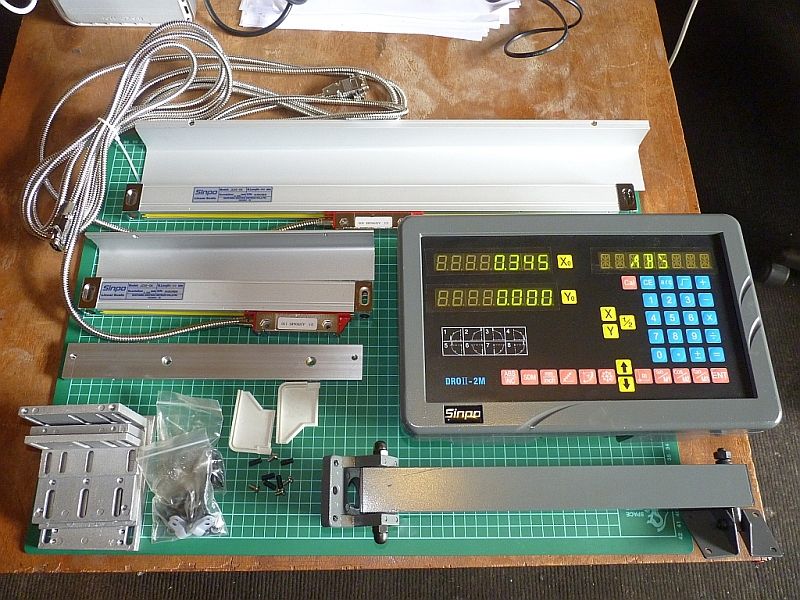

                                            Hi Ken,
                                            Yes, I went down the direct from China route as the cheapest option. I bought a Sinpo 2 axis for my Chester Eagle 25 mill as Sinpo seem to get good reviews.. My logic was that most of the ones that you can buy in the UK come from China anyway.
                                            I paid £264 which included the postage and had to pay another £20 VAT when it went through customs. Took a couple of weeks to arrive but have been very pleased with it. Best thing that I have ever bought. The DRO and fitting a VFD drive to get rid of the tedious belt changing have made the mill a pleasure to use..
                                            It's been fitted for nearly a year now and is in constant use with no problems. There were a couple of plastic end caps for the covers missing but that was no big deal.
                                            Edited By John Baguley on 17/04/2019 23:42:58
