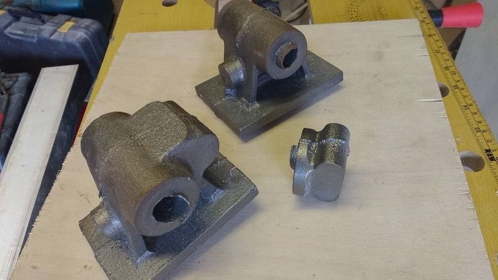

                                          Hopper
                                            @hopper
                                            After the long and laborious task of making my own fabricated version of GH Thomas's Versatile Dividing Head some time back, I scored a full set of the castings on eBay UK today for just 30 Quid. Brilliant! Then of course there is the 30 Quid for shipping to Australia. crying But still a fraction of the cost of buying the castings new. And this lot includes the tailstock, an added bonus. Very pleased with my day's work.
                                            So now the lad and I will be able to make a second VDH body with the correct centre height to suit our ML7. The first, fabricated version, was bored out on the Mighty Drummond and so its centre height is about 1/8" too high for the Wimpy Myford. Will just make up the new body and a spindle to suit and equip it with a disc with 24 holes for use in general indexing of common numbers. If we want to use it for gearcutting etc int he ML7, will swap the worm gear and index plates off the Drummond's fabricated VDH onto the new one. No way I'm making a second set of index plates with 814 holes to be drilled!
                                            Eventually, I'll get around to using one of my growing collection of dividing heads to make the 14 gears to drive the cams and oil pumps in the quarter-scale WW2 Harley engine model that's in the works. One day…
                                            #368422
                                              Posted by Hopper on 22/08/2018 09:27:37:
                                              So do I have to bin your article now…
                                              #368423
                                              Hopper
                                                @hopper
                                                Posted by Neil Wyatt on 22/08/2018 10:42:13:
                                                No way! 30-pound VDH castings come up but once a lifetime. So there's no chance of any dear reader being so lucky. cheeky

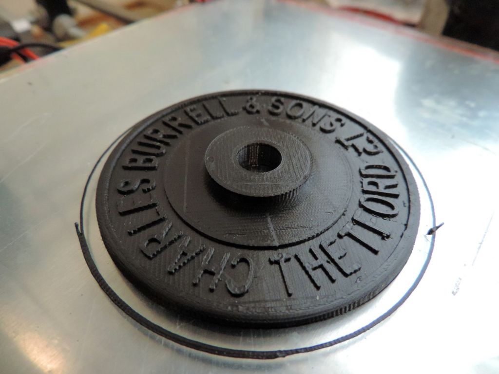

                                                  Here's my print of Andrew's Burrell nameplate.
                                                  Two faults – first I forgot to recoat the bed with PVA so there's slight curl you can see at the front edge – my error.
                                                  Second, the descenders on the T and D in Ltd haven't printed. I did have print thin walls ticked so walls thinner than the 0.4mm nozzle diameter should have printed, but I think that with the very fine 0.06mm ~2 thou layer height this was expecting too much.
                                                  I could use a 0.2mm nozzle but then it would become a ~20 hour print instead of a five hour one…
                                                  If doing again I would speed up with thicker layers as there is very little vertical detail and use thinner walls, I had it on a robust setting better suited to 0.2mm layers.
                                                  #368449

                                                    #368548
                                                    Anonymous
                                                      Posted by Neil Wyatt on 22/08/2018 13:58:11:
                                                      Looks good, although I'm not surprised it didn't print the T and D. Pity really because it means you can't show it and go ta da! Some of the letters seem well defined, but it seems strange that others, like the A, seem zigzig? If I get time over the weekend I may have a go at printing it myself.
                                                      Andrew
