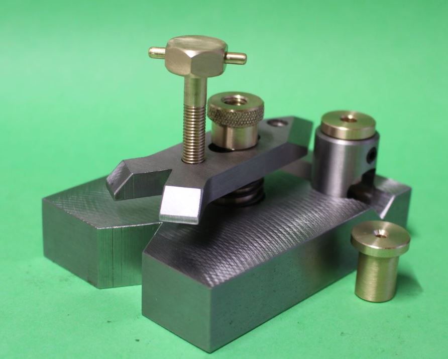

          Today I completed this tool which I believe is called a finger plate. No drawings just based upon what I can remember seeing from time to time.
          I wanted a quick simple project with some nice milling and turning. This is a tool I have wanted for some time to help hold small parts for drilling and linishing etc. I think it should be useful.
          A cross drilling feature is included with 2 aluminium bronze bushes to suit 2 sizes of spot drills I use, 3mm @ 5mm.
          All materials from the scrap box and sizes determined by the size of the piece I used for the base block about 3" x 4". I think these tools are usually made much smaller.

                Nige
                Nice finger plate. I've had a notion to make one of those for some time but always managed to find a way to do what I needed without one so put it off. I'll bet it proves very useful and I really must "get a round tuitt" and make one of my own.

                  Very nice, would you mind sharing how you cut the sharp cornered vee on the front? special milling tool or just a matter of good old fashioned bench work?

                      Hi Micheal W, cutting that vee shape was an opportunity to use my Elliott Omnimill using a vee shaped cutter in the horizontal spindle arbour. So that cutter that came with the mill has found at least one use.

                          And how did you line up the cross drilling round bit with the vee groove? My best guess is a wiggler, but is there a better way?

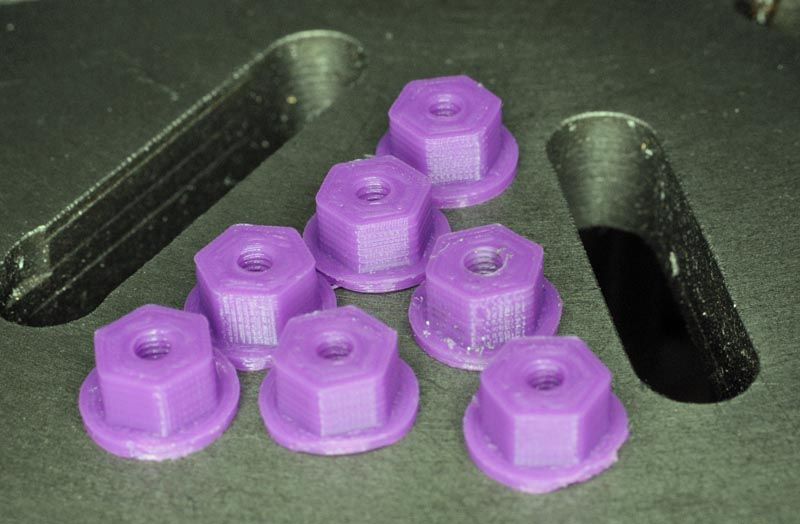

                            3D printed some nuts:

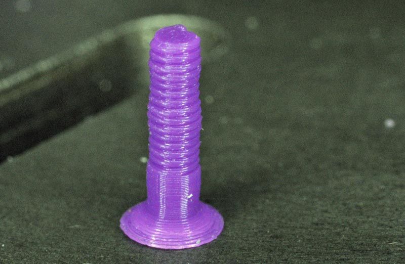

                            The thread is M3 x .5. Very easy to do in Fusion 360 – you just point at the hole and it puts in the requested thread. A bolt will go through but better to clean up the thread with a tap. Screws were less successful in this size.

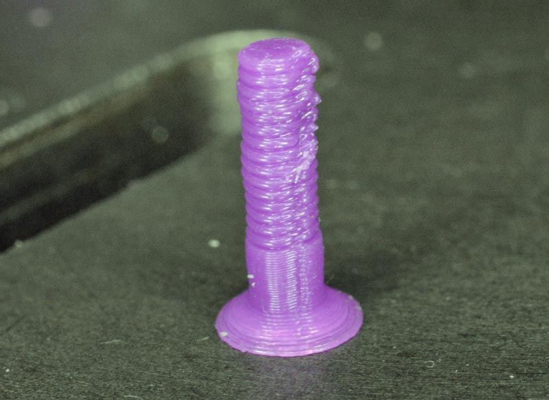

                            A bit wobbly but the other side is worse, the join where the printer head reverses direction is obvious
                            An interesting exercise.
