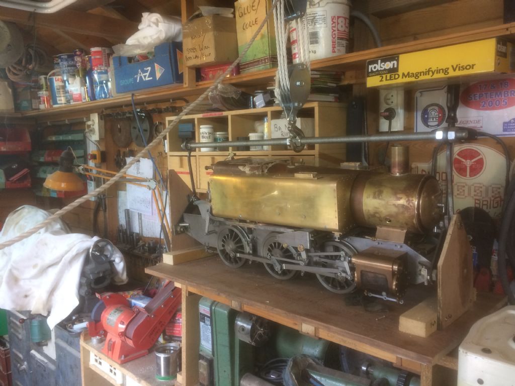

            Yesterday installed a 70mm deep RSJ with 2.5M span and today made a lifting jig for 5" SPEEDY out of 18 mm allthread.

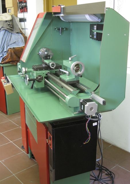

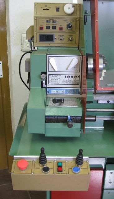

                I will make these the last pics of my V10 re-furb – All done now, and I am sure folk are now quite bored with these pics…
                Front view, with Swing down viewing guard in place. DRO fitted, but X Axis Rotary encoder still to be fitted..
                'Electronic' controls for threading, auto feed, etc all fitted.
                Control Consoles
                Feed/Threading Stepper motor still to be wired in to control box below it.
                Well, it was a fun journey. The alignment of headstock turned out very well indeed, so I am looking forward to using what is now basically a brand new lathe!
                Thanks for indulging me..
                Regards
                Joe

                  Bored?
                  Only boring ting about seeing mill's n lathes is the use of drills n mills to do boring Joe.
                  Its come up a treat very pro looking set up.

                                I hope Joe isn't going to actually do work on that nice looking Emco, shavings will spoil the good looks of it!sad

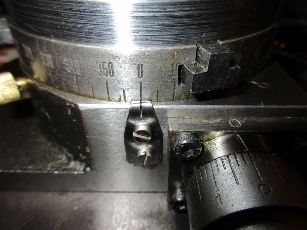

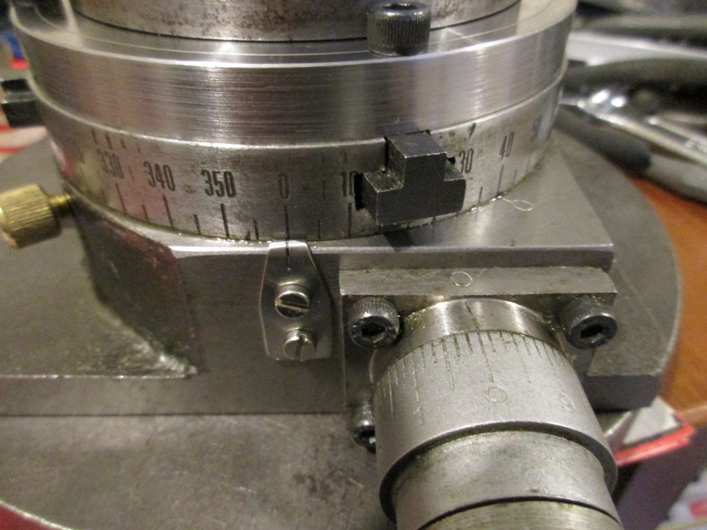

                                                    Hi, today I went to Doncaster MEX, but yesterday I made a small modification to my 4" Soba rotary table and cleaned out all the old tacky grease inside it also. The mod was just adding a additional zero index point, as I find the position of the one that Soba has engraved into the casting, most inconvenient. All I did was to cut a piece of 1mm thick St/St., shaped it a bit at the top and engraved a short line on it and drilled a couple of 3mm fixing holes. I then drilled and tapped the bottom of the RT casting just to the left of the operating handle, the top mm or so of the new index was then knocked over with a brass hammer so that it came close to the graduations on the edge of the table. The assembly was then re-greased and re-assembled and adjusted for minimum backlash.
                                                    You can see the original zero index to the right of the operating handle, near the 40 degree graduation above.
                                                    Regards Nick.
