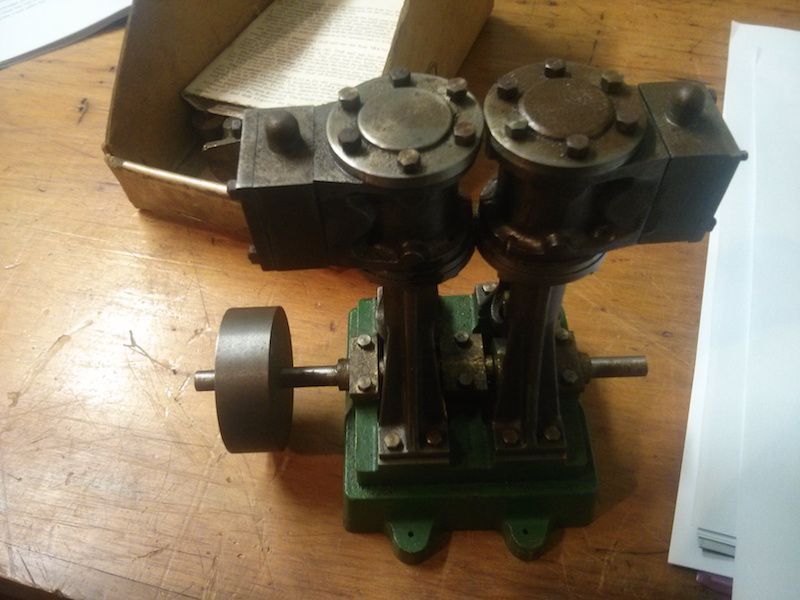

      Productive day today
      Purchased a partially completed Stuart D10 a couple of weeks ago.
      Stripped it down and bagged it all up to see what I needed to do to it.
      Left cylinder had been bored but that was it and the right cylinder had been bored and the steam passages drilled. One of these passages had been done quite off centre and quite poorly so it was out with the JB Weld.

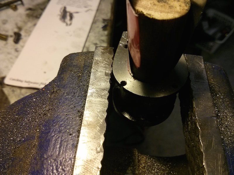

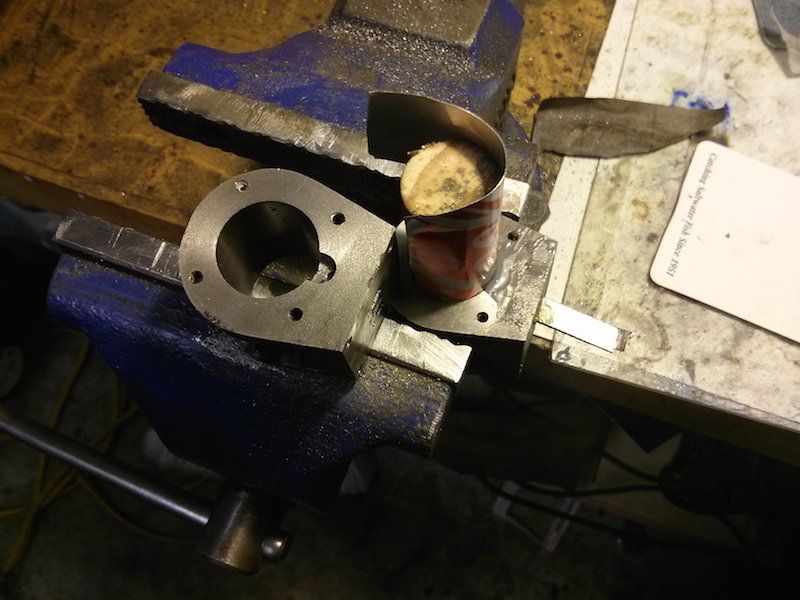

      The left cylinder has now had the steam passages milled and drilled

      I'm not too happy with the holes for mounting to the stand of the right cylinder either. One has broken through. Any suggestions? Or is it time to buy a new casing?

        Apart from the look, it will work OK with 3 studs if its just for show.

          Thanks Jason
          I want it to be a working engine and look as nice as possible.

            Pardon my ignorance Bruce but what's the JB weld for ?.

              I didn't like where the hole was drilled nor where it came out in the steam port so I decided to plug it and redrill

                Bruce, tap the offending hole, make a threaded cast iron plug, a good firm fit and Loktite it in, redrill in the correct place.
