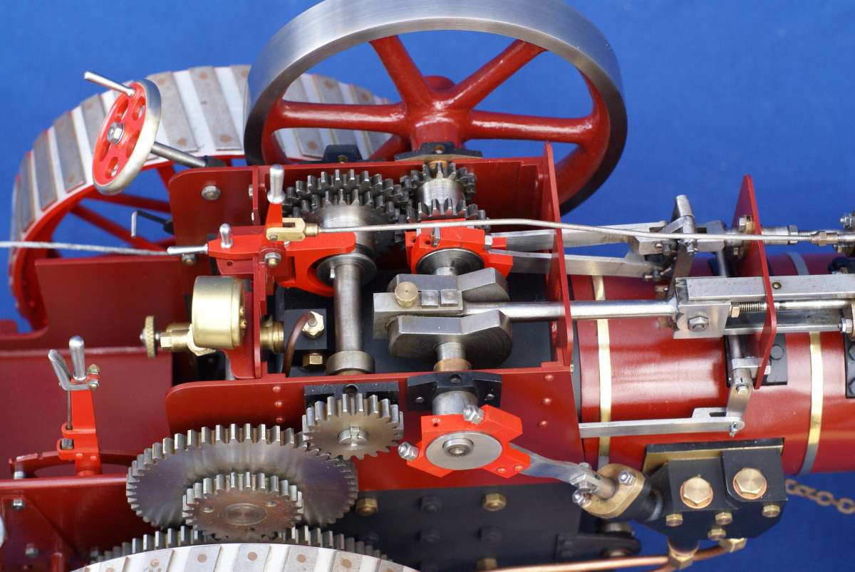

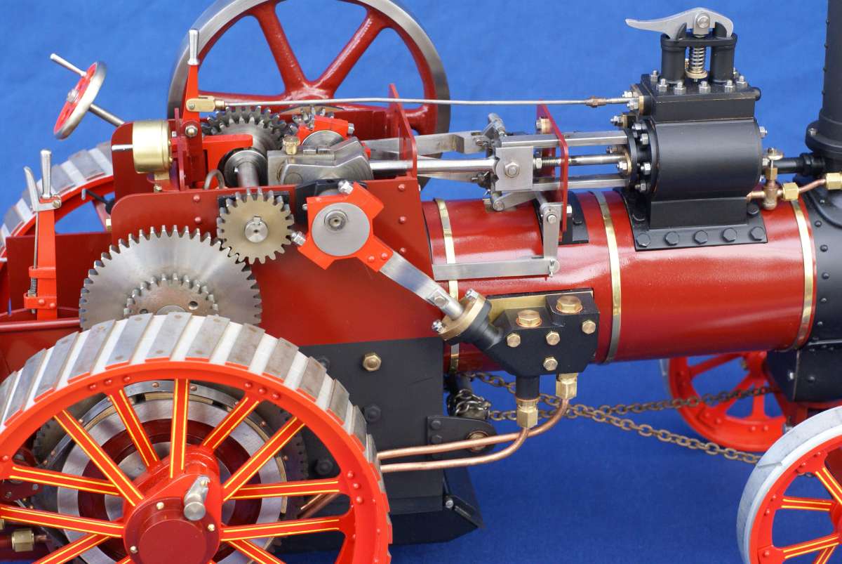

                              I’ve not had problems grinding carbide on a bench grinder with green grit wheel so no need for diamonds. That is shaping new tools from broken carbide milling cutter shanks or grinding brazed tip tools.
                              On the Subject of Brazed tools although some here may not get on with them the Minnie in my Avitar was mostly turned using 1/4″ sq shank brazed carbide tools so maybe they are not as bad as some would have you think.
                              DSC00159
                              DSC00163
