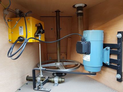

      Hi, I want to put together a Electric pottery wheel, I can build the body but need to source the motor etc. Below is a photo of what I need can anyone tell me what they are. The motor will be about half to three quarters horse power, I think the other box is a power regulator this is controlled by a foot peddle. 1. what power regulator and foot peddle do I need. 2. Where can I buy these parts from??
      Any other help you can give me will be much appreciated.

                    Hi, Here is the photo I could not load before. A quick recap on my question,
                    I would like to build a pottery wheel and would be grateful if anyone can tell me what the parts are I need and the spec so they all match up in size, amp, power, etc.
                    The photo shows the inside of the wheel, the spindle goes through the top and attaches to the wheel head ( the bit the clay goes on) You can see at the bottom a spindle goes out through the side where it attaches to a foot peddle.

                      I would use a 1hp 750watt 3 phase 4 pole (1440rpm) motor foot mounted wired delta …then a pulley of perhaps 50mm diameter on the motor. Then a pulley of about 200mm on the spindle connected with a v belt “A “ section this will give a 4 to1 reduction so when the motor is spinning at 1440 at 50hz the spindle will be going at 350rpm.
                      Then a 750w 1hp VFD 240volts in 240v 3 phase out with the foot pedal connected to a switch so when foot is off the vfd is off when the foot pedal is depressed then it allows the vfd to start at say a min speed of 10hz on depressing pedal more moving the potentiometer up to a max speed of 50hz.letting the foot off the pedal would make it go to stop condition.
                      Or the foot pedal just a switch to start and have the speed controlled by a knob…hand controlled…whichever type of control a potter would prefer

                          Actually looking again at your photo it looks like a brushed motor and a dc variable power supply…I would still go for the induction motor and vfd route as described but another option is a Chinese sewing machine servo motor which is powerful and with control gear all in for about £150 i’ll Try and find a link to one.I have one of these which is on a sewing machine that i use for leather works great and is vary easy to fine control on your foot.. or a standard sewing machine motor which has a clutch and starter gear all in for about £70.

                                    Depends a bit on how skilled and able to work round problems you are, and what tools are available. The quickest and easiest way of solving the problem is to buy a manufactured wheel.
                                    If not, problems to be solved are:
                                    • A moderately waterproof enclosure to hold the motor, controller and pulley system. It has to be strong enough to take the weight of the pot at a height that suits the potter and secure enough to keep passing toddlers from getting inside.
                                    • A turntable sat on some sort of bearing, perhaps a Lazy Susan.
                                    • A shaft from the turntable into the box with a large pulley on the end. An old washing machine drum pulley is likely suitable and they can be bought new as spares.
                                    • A motor with pulley. Note that the groove in the motor pulley must match that in the drum pulley.
                                    • A belt sized and the correct profile to fit between the two pulleys. It shouldn't be too tight or too loose, which is why the motor in your photo is mounted on rails allowing the belt tension to be adjusted.
                                    • A motor controller that matches the motor. This part needs careful attention because what suits one type of motor will be completely and wildly wrong for another. Wiring an unknown motor up correctly is a challenge especially if you have no experience. If you don't have a motor already, then I'd buy a 3-phase motor like this (other vendors available) and a VFD as listed on Amazon. (Motor HP and  VFD HP to match or VFD HP slightly bigger.)
                                    • A foot controlled potentiometer to control speed. A sewing machine pedal might do the job but I see the photo shows the potentiometer is inside the yellow box and controlled via an internal shaft and push-rod. This is almost certainly done to protect the electrics in a mucky environment : a sewing machine pedal plonked on the floor might not last, and you certainly don't want a wet potentiometer unstoppably spinning clay at top speed.
                                    None of this is rocket science but you will have to bring it all together yourself. Basic design, woodwork, metalwork and electrical skills working in partnership. I've found the forum to be very helpful. I doubt anyone will be able to provide a shopping list and detailed plan for a potters wheel but there are several who should be able to advise if you have a go and get stuck.
