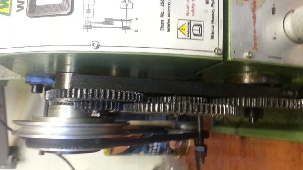

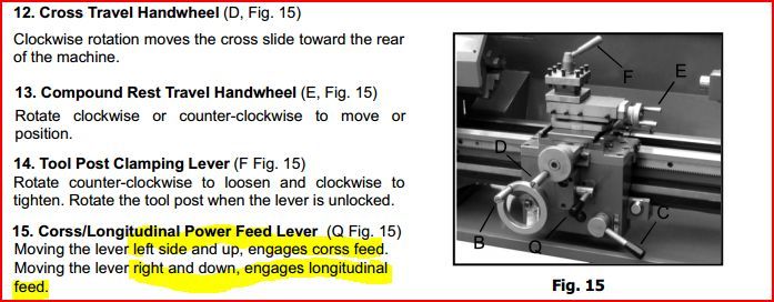

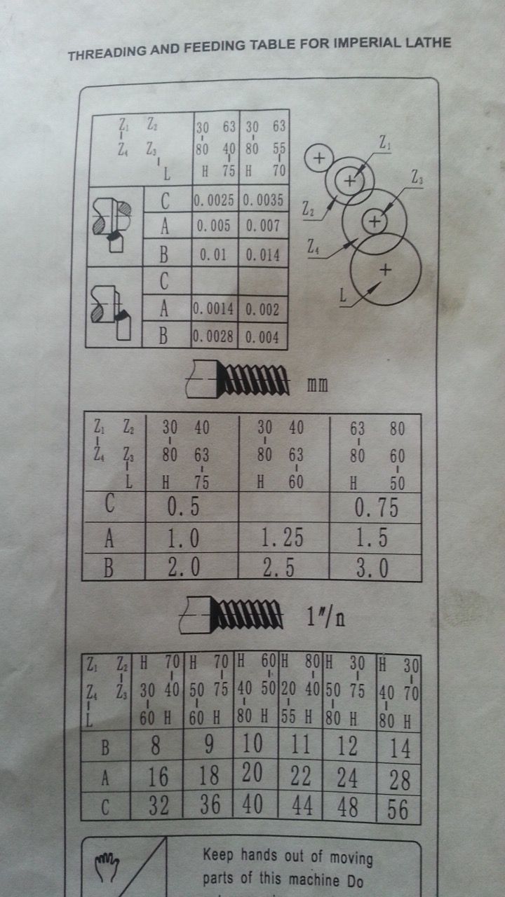

      Newbie here so go easy on me. I have bought this lathe recently hardly used and about 2 years old. I thought the feed rates were high so I checked the installed gears. They are as the table on page 14 of the manual and therefore feedrate should be 0.0025 thou per Revolution which is the finest feed. Unfortunately when I engage the feed and rotate the chuck one Rev the dro reads nearly 8 thou. Thinking the dro might be wrong I checked it with a Dti and I get the same reading. Tried doing 10 revs by hand and It still works out at 8 , 16 , 32 thou per Rev depending which position the switch is in either C A or B.

          Sounds like you have a gear or two in the wrong place, can you post a photo of te gear train and also the page in teh manual.

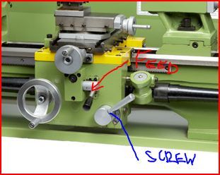

                  I was going by the thread title where you said a 250V-F which is what that photo is, this has the power cross feed which obviously can't be engaged with the same lever as screwcutting/lengthways feed.

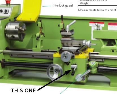

                      Hi Brian,
                      Jason got in first with his picture, but I was going to offer this one which is from the WM250 picture in Warco's Brochure
                      Are you able to publish a picture of your lathe? It should reveal all, especially if you don't have the lever marked 'THIS ONE'!

                        That manual you have posted also has cross feeds shown so can't be for a WM250question
                        Can you also post a photo of front of headstock which will say teh model and the front of the saddle which will show what levers you have
                        S.O.D, I also snipped my photo from Warco's catalogue

                            The gear train looks correct in your photo
                            Try the lever we have been pointing to in the down position, you will have to move it side ways before it drops down from the mid position.
                            I'll upload a photo of a VF manual that shows lever positions after my dinner which is just ready

                              Right just tried it with my 280 which although not quite the same gave more movement when the screw cutting lever was used than when the lateral feed lever was used.
                              Basically the gear train as you have said will give 0.127of a turn input into the headstock gearbox per 1 rev of the spindle. Selecting "C" will give a 2:1 reduction comming out of the box into the lead screw so 0.0.0635 of a turn .
                              With the 8 tpi spindle you will get 1/8" (0.125" )travel per turn of the leadscrew therefore 0.0635 x 0.125" = 0.008" when the carrage is driven by the leadscrew which is what you have measured
                              As I mentioned above the carrage can either be moved by engaging the half nut onto the leadscrew (righthand lever) in which case it will move teh 0.008" per spindle turn.
                              OR there is a permanently engaged wormwheel which via assorted gears drives a shaft which has a rack cut in one end. This rake is driven by a pinion on the feed lever (black or metal knob, middle of apron) so when the lever is raised the drive shaft engages with other gears that drive the cross feed leadscrew. When the same lever is lowered the rack moves the shaft the opposite way and engages with gears on the handwheel shaft which in turn move the carrage along via the large rack screwed to the front of the bed. These gears give the further reduction in movement that you desire.
                              From a 250VF manual
                              You can also see from the parts diagram in the pdf manual of the apron how the half nut is engaged by the R/H lever and the feed lever engages the gears.

                                I never realised the same lever is used for both feed directions and have been useing the screw cutting lever. Well three things I have learnt from this. How to calculate gear trains, read the manual first and three what a helpful bunch you all are!
                                Checked the feed rate and it is indeed 0025" per Rev.
