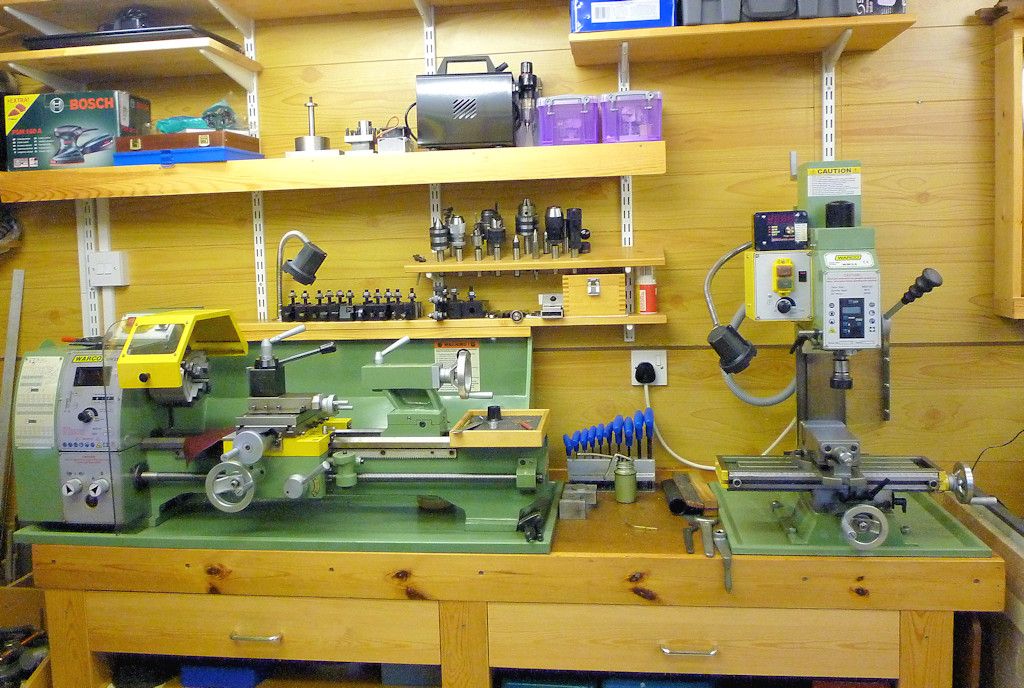

                                                  Yes, that's what I was getting at. My mill is much smaller and it can be quite an effort reaching up and over if the head needs moving a lot. I can get to the side of mine if the space isn't full of useful things (read junk storage)! My bench is 900mm tall and that puts the lathe cross-slide handwheel at elbow height for me ( I'm 6' 1" )The top of my mill is 700mm above the bench top and it is a baby compared to your new one. You could always make the bit for the mill a bit lower.
                                                  Picture out of interest and you will find the flat space between lathe and mill collect a vast assortment of tools, swarf, bits of bar etc. (I cleaned up before taking the photo). Drawers are very useful when you make the bench.
                                                  Happy machining with your new toys…

                                                      Hi John, looking at your photo I can see where your coming from, your mill is probably a WM14 (can't clearly identify) and the hand wheel of the vertical traverse is on top of the column, while on the WM18 the hand wheel is on the side.
                                                      Can't see any junk on your bench, I'd say it's very neat and tidy!
