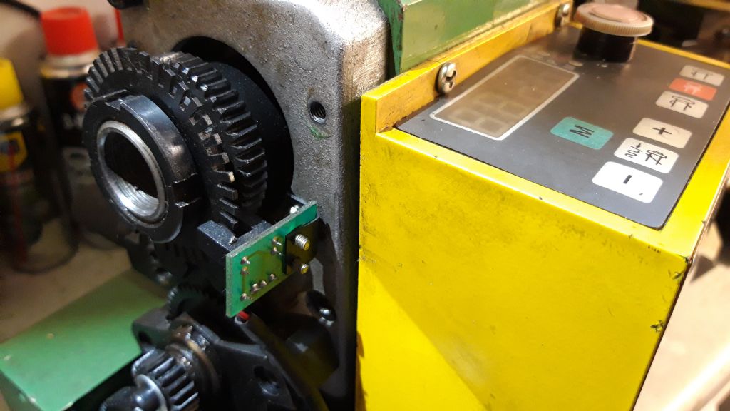

      I have one of the earlier Warco mini lathes that has the digital speed readout panel whereby the speed is set via touch buttons rather than a speed control potentiometer….
      It looks like the machine has been tampered with in the past…
      So before I start pestering Warco, if there are any owners of a similar machine, could they tell me where is the little speed pick up board secured inside the end housing where the change gears reside?
      I can see the slotted disc, but there's nowhere for the opto coupler device to be secured….I cant see how it attaches…
      A photo would be a great help…
      Many thanks
      J.

          I think I have the same model John, the one with the USA made main circuit board.
          Is this photo any use to you?
          IanJ

            Ian,
            Thanks thats great….Just what I needed.
            Do you have any idea on how the buttons work?
            I think the green M button switches the motor on, the Red one, off. The two either side cause a change in direction, but what about the + or – buttons…?

              Glad to help John.
              To turn the motor on you press the spindle rotation buttons either side of the red button (this is the spindle stop button) the left button is forward for normal machining and the right button is reverse. The + and – buttons regulate the spindle speed, you can use these buttons while the machine is running to adjust the revs to suit your job.
              I have never used the 'm' button I think it's a 'memory' function, I'll need to look at the manual to be certain. So I wouldn't worry about it.
              And there is the big emergency stop button, mine stopped working years ago, couldn't be bothered to fix it, so left it alone because the lathe works just as well without it. So I wouldn't worry about that either!
