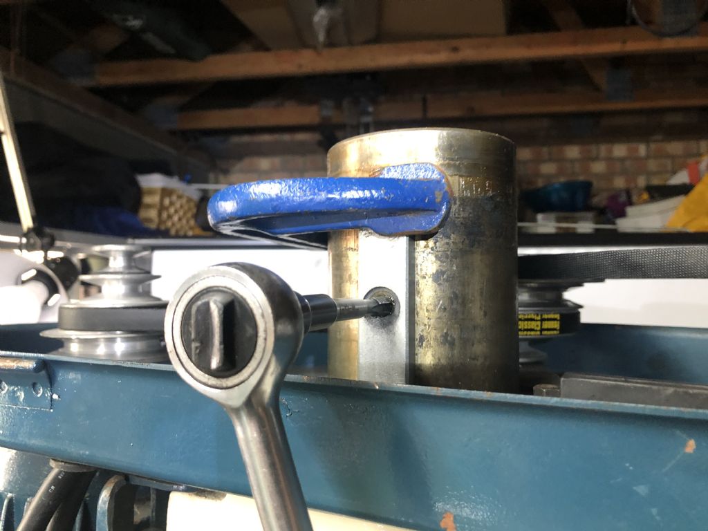

            The Edwin White 'improvement' appears to be a straightforward process capable of producing good results and greatly improve the head alignment problem with round column mills ..but… I found several elements of the work where I could have ended up with a poor outcome…
            1/. The prospect of hand drilling four holes through the rack ( 11mm) and the column ( 17mm) and ensuring that the resultant hole was an accurate tapping size, then countersinking those holes in the rack, troubled me.
            I removed the rack and used the mill to pre-drill two 6.6mm holes ( smaller than recommended for 8mm threads ) top and bottom ( 40mm apart ) and countersink them.
            How did I do that when there was no rack on the mill I hear you ask..? Support the spindle/head on blocks of wood on the table before removing the rack, lock the head clamps and then use the quill control to raise or lower it, ( it is heavy..! )
            I then had a pre-drilled rack which also acted as a guide for the holes I needed to hand drill in the column.
            I ended up with very tight threads and good countersinks.
            2/. My mill stand was actually 0.6 degrees off the horizontal so I had to incline my laser 'target ' by the same amount and I used an electronic gauge to do that accurately. ( Thanks to old mart for the ' heads up' on that. )
            3/. The next, crucial , stage is positioning the head before drilling/tapping holes in the column and I very nearly made a serious mistake here… !
            I drilled and tapped the lower of the four holes in the column and screwed the rack into position. I put the head into its lowest position and aligned the laser on target. I then raised the head to its highest position, moved it to align the laser/ target and prepared to drill / tap the crucial top hole.
            BUT… somehow ….I noticed that when I moved the head up the rack, the rack did not appear to move at all… ? I would have expected the upward movement of the head to 'shove' the rack across as it went higher and it did not…???
            There was a a 1.63mm gap between the head casting and the rack, which I was able to measure using feeler gauge blades and I then used those blades to make a shim to correct the problem. I recommend that everyone does this first. Edwin white uses a shim but appears to do it last…?

              More elements of the work that could have produced a poor outcome….
              4/. There are dangers associated with 'firing' lasers , even low powered ones, across a workshop but using one with a vertical linear 'target' proved to be very worthwhile. (If the laser is shone into an eye it can cause immediate, irreversible damage and when I was walking across my workshop I forced myself to look at the ground.)
              I used the laser/ target to determine the rack positions and when I had screwed the rack to the column I used the worm drive/ handle to raise the head.
              top clamp with tap.jpg When I raised and lowered the head I expected the laser dot to track along the middle of the vertical target but in the middle of the movement the laser was wavering all over everywhere ?
              I found that even when held top and bottom by two 8mm counter sunk screws the rack was simply not rigid/ strong enough and it was visibly flexing !
              Fixing the rack with another 8mm counter sunk screw in the middle of the toothed section would leave too little metal so I decided to use a 6mm screw with the normal socket head which I turned down to a tight fit on a 8mm hole, which I drilled free hand. That stopped the rack flexing and corrected the error.
              In the future I may consider using one of the other column mill head alignment projects that can be found on the internet but for the time being I shall stick with what I have.
