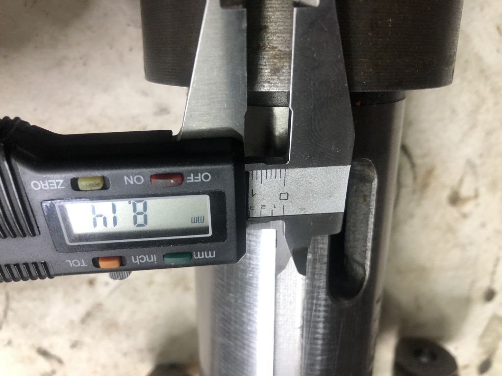

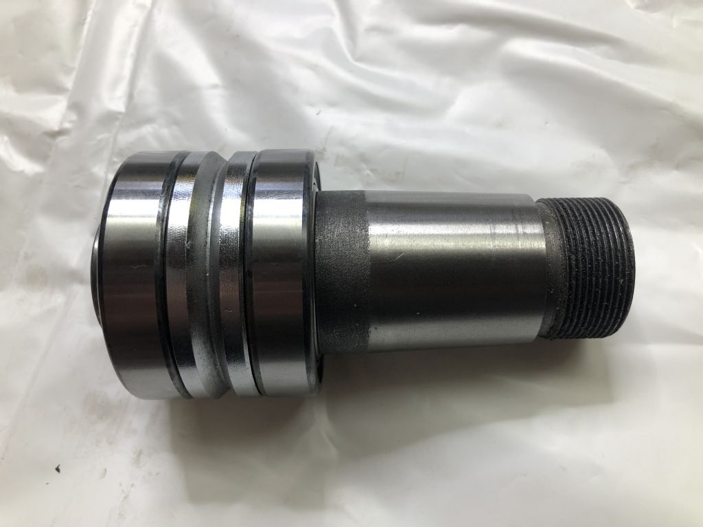

                #557710
                Terry Turner 2
                  @terryturner2

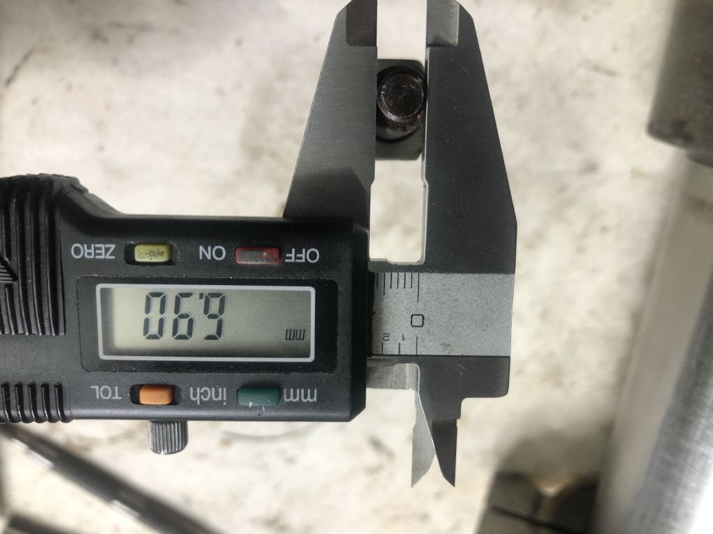

                  I have all four new bearings for the quill /spindle and the pulley shaft.
                  Whilst I was waiting for them ( 1 hour from a very local distributor ) I turned up a new anti-rotation ( 10mm ) grub screw as the original was very ill fitting.
                  anti rotation groove.jpganti rotations screw size.jpgSorry they pics appear upside down but you can see that a 6.9 screw will be very sloppy in a 8.14 groove.

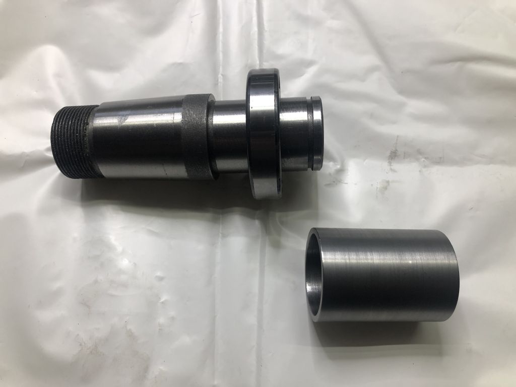

                  I then turned a sleeve to fit the pulley shaft bearing inner race so I could press them on to the pulley shaft without any fear of distortion or damage.
                  pulley shaft sleeve.jpg img_9777.jpgThe pulley shaft bearings / shaft are a snug fit into the top of the head, ensuring that you don't set them too far down in to the head ( there is no seating ledge) and feeling/ setting the grub screw on the side of the housing so that it is positioned in the groove in the bearing spacer.
                  #557775
                  old mart
                    @oldmart
                    That antirotation screw on the museum's Taiwanese round column drill mill is unusual in that it's thread is either Whitworth or UNC, not metric.
                    I notice that your spindle is Morse taper and there is an extraction slot for when larger drills are fitted directly to the spindle. That will prevent overpacking with grease alright. laugh

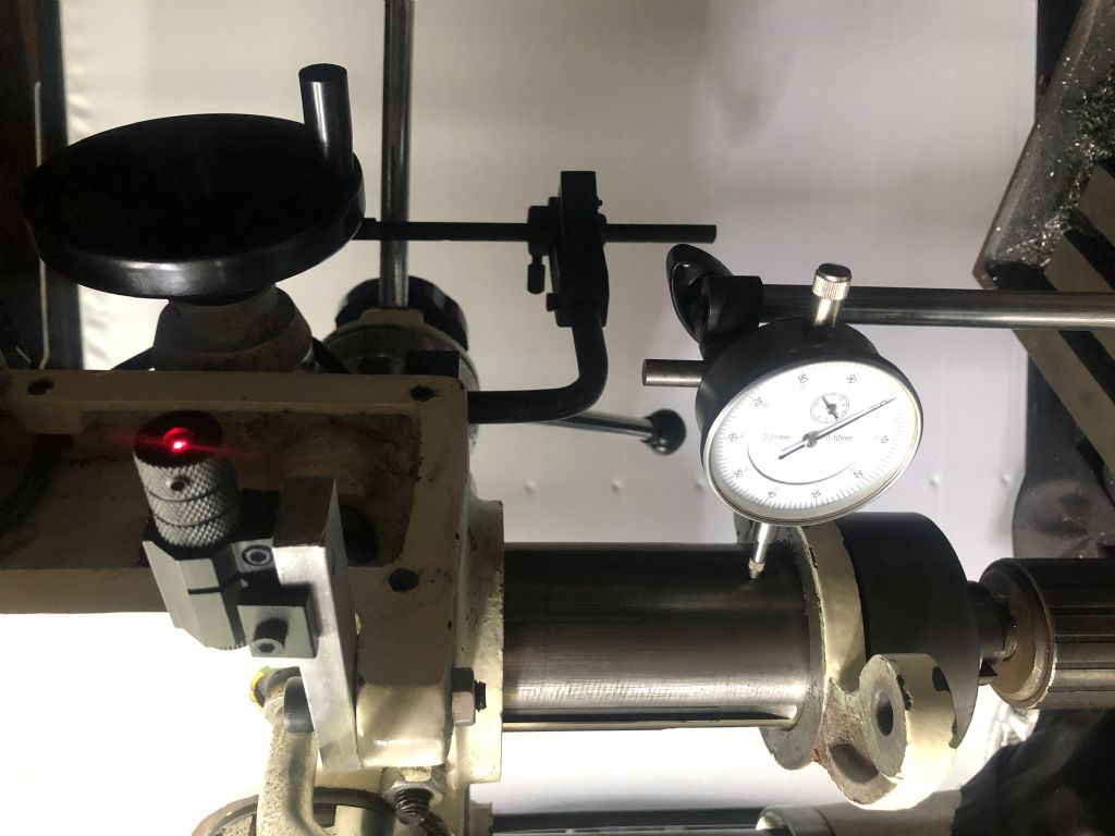

                                  The laser is bolted to the head and has a 4mm wide 'target' 6 metres away. The dial gauge is obviously reading the quill position
                                  laser target 4mm.jpgBoth methods have already been used by people to successfully reposition the head with good accuracy. ( Thanks to them for sharing the information ) I shall use those methods to measure angular error before I drill / tap the rack and column.
                                  The mill table is 1 degree off horizontal so that will have an effect on the laser measurement at the ' target ' but with both measuring methods working simultaneously , I thought it was worth a test to see what accuracy / repeatability I can achieve.
                                  Please tell me what you think…?
                                  As ever I greatly appreciate any advice and comment.
                                  Terry T

                                    Your tilt measuring device is not sensitive enough. I was going to suggest that you match the tilt of the line to that of the table, but a tenth of a degree would be on the coarse side.
                                    Assuming 4mm at 6 metres and reducing that to whatever your column to spindle distance is would give an approximate movement of the spindle sideways. Say the column to spindle centre distance was 333mm, then the angle moved would be 0.0382 degrees, and the spindle would move 0.222mm. I use the reflection back to the end of the laser which would double the effective distance.
                                    It would be nice to find a laser with a smaller diameter beam, mine is similar to yours. Estimating the centre of the beam should give better results. Make sure the lens of the laser is clean.
                                    Your dial gauge should be 90 degrees further around the quill, either direction, so that movement in line with the X axis is measured.
                                    Edited By old mart on 13/08/2021 20:09:23

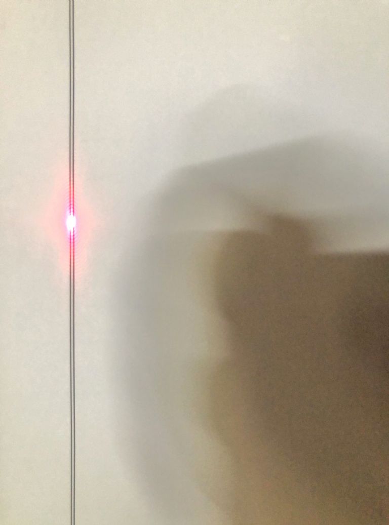

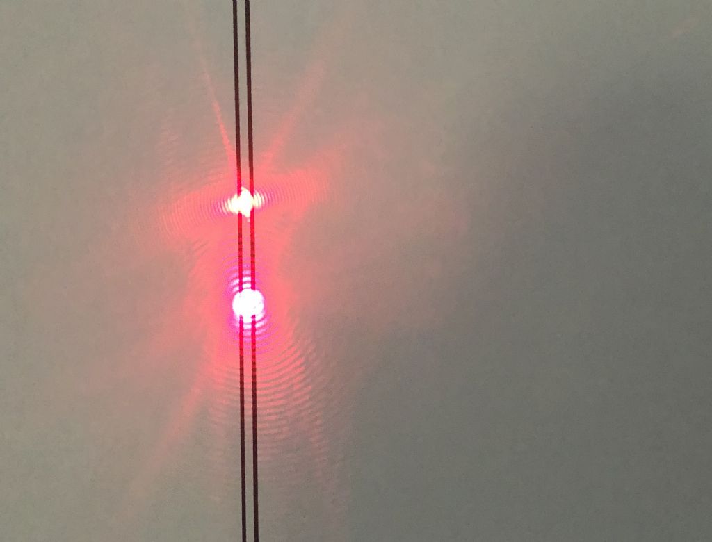

                                                #558384
                                                Terry Turner 2
                                                  @terryturner2
                                                  I spent my time today ensuring that my measuring systems were as good as I can get them before attempting to carry out any of the Edwin White process.
                                                  The ( expensive ) surveyors laser measuring device only gave a marginally better 'dot'.( The top one in this picture )
                                                  When used in comparison with the dial gauge on the quill I found that I could get results which allowed me to carry on.
                                                  I positioned the head .03mm off centre on the gauge and could see the core of both lasers displaced to the left line and return to centre when I 'zeroed' the head /guage position.
                                                  The object of the exercise is to measure the lowest position of the head and fix / screw the bottom of the rack there.

                                                  #558388
                                                  old mart
                                                    @oldmart
                                                    I have found that even with a large size laser dot, that it is easy to estimate the centre. Of course, a tiny dot would be nice if possible.

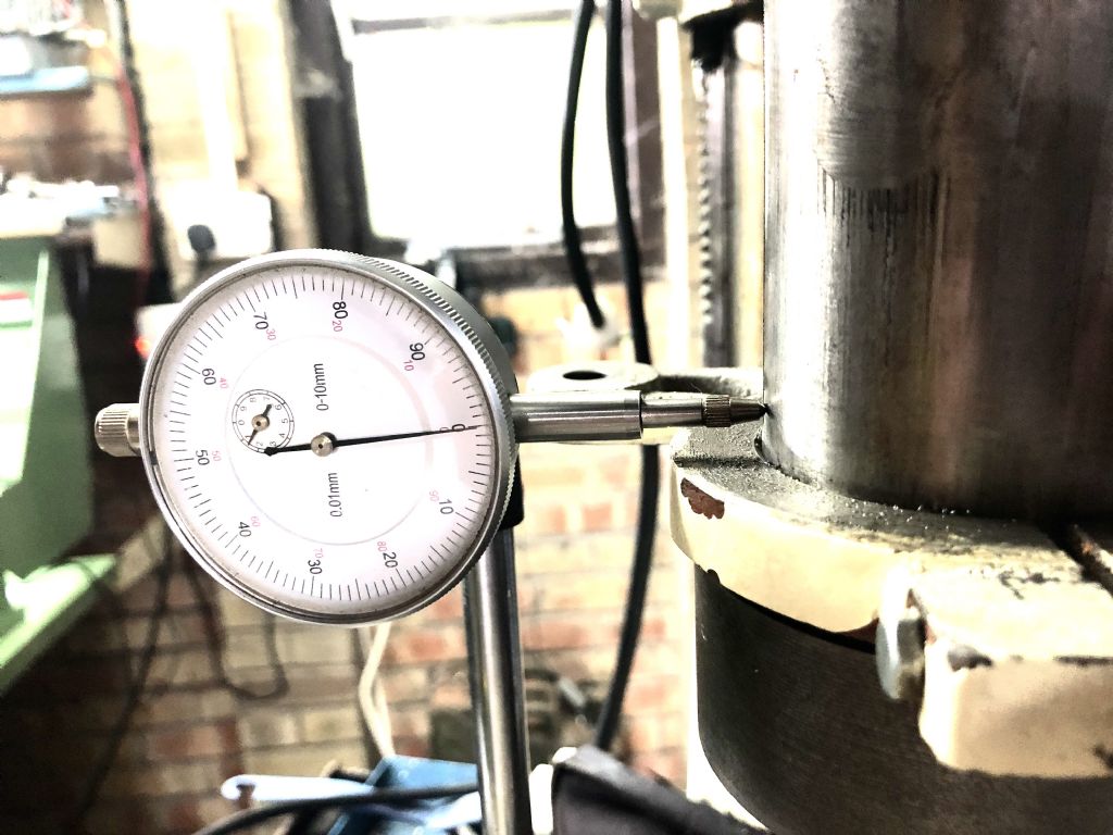

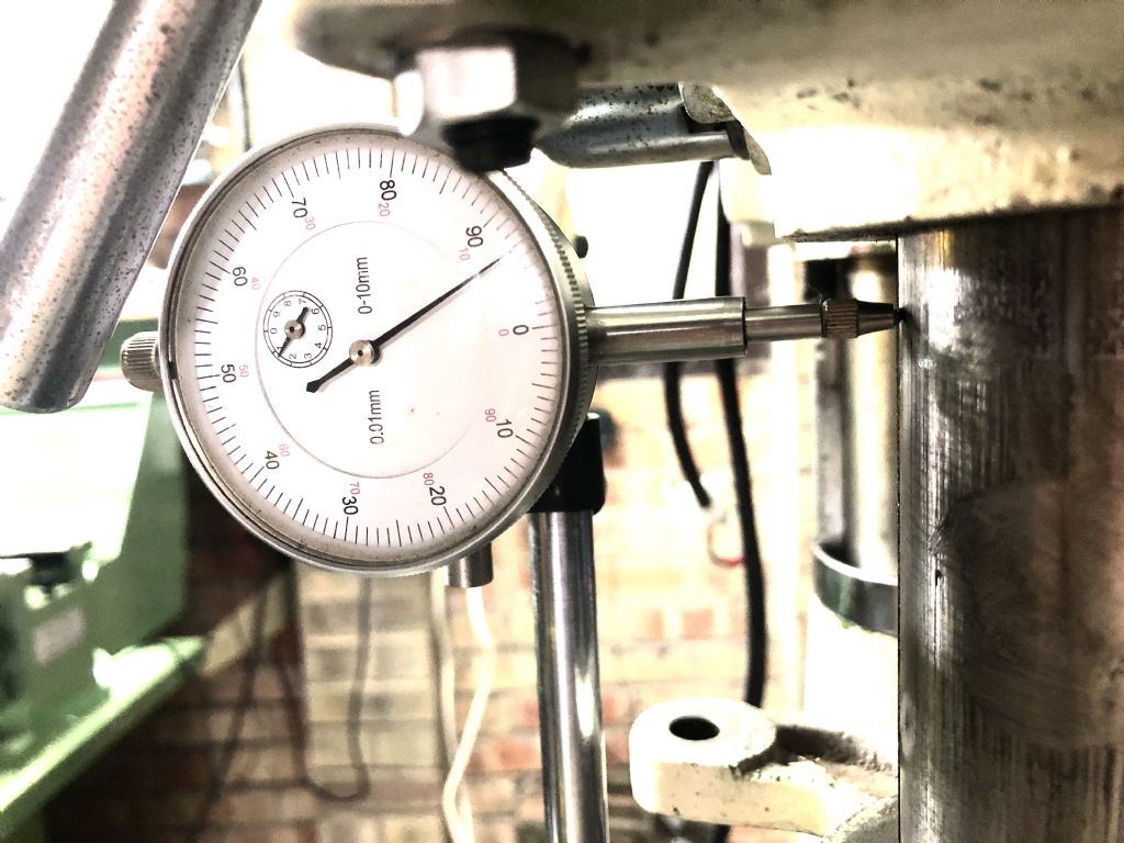

                                                      I have completed the Edwin White 'improvement' on my Chester Eagle round column mill.
                                                      These pictures show results I have repeated several times.
                                                      Lower the quill to its full extent. Place the dial gauge in contact with the lowest part of the quill. Zero the gauge.
                                                      Lower the head using the worm gear. ( Approx 120mm movement ) Read the gauge – 0.07mm deflection.
                                                      I can't recall what the outcome was for Edwin White but for me that is pleasing. ( rounding things for errors in my measurement…about 3 ' thou '  in old money )
                                                      What do you think …? Worth the effort…?
