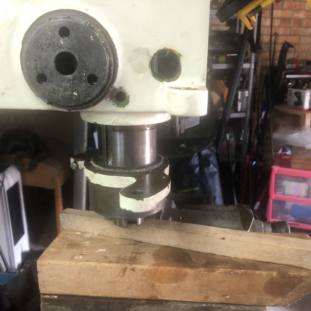

                #557306
                old mart
                  @oldmart
                  As you have exhausted all of the possibilities, I think its time to put a soft pad under the quill, and use an aluminium drift to gently tap the end of the spindle. I would measure as you progress to see if the tapping does move it. There is no great danger from the tapping as the quill is being removed to overhaul things, ie, new bearings. When the quill is out, the nuts on the spindle are left hand thread.

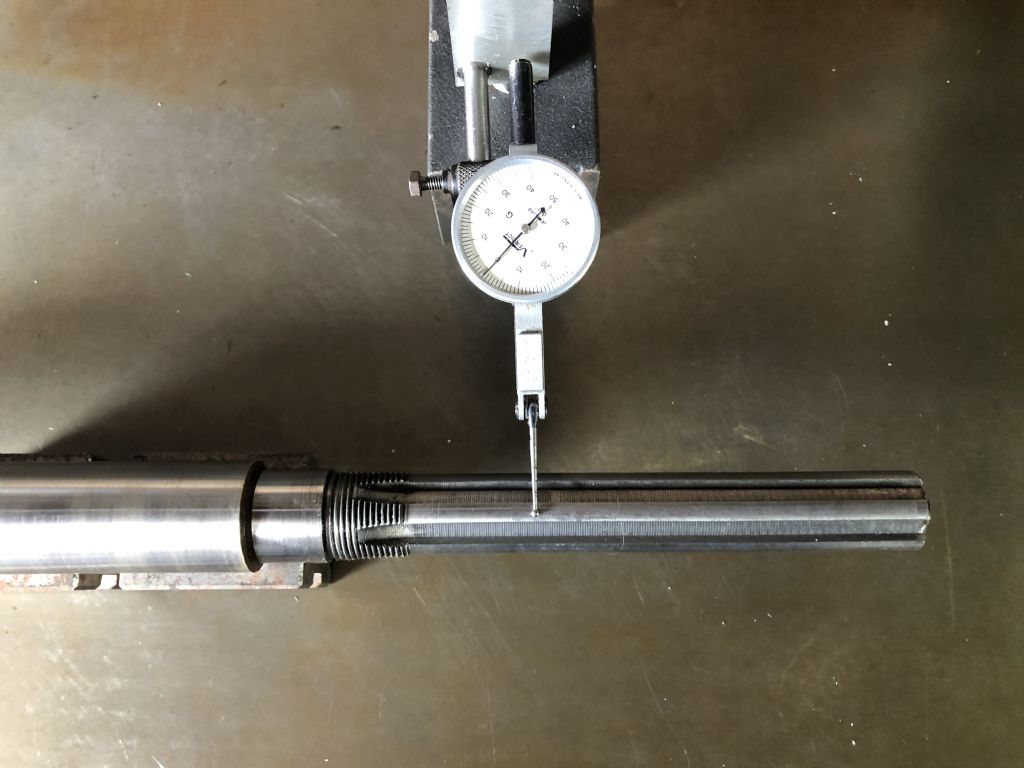

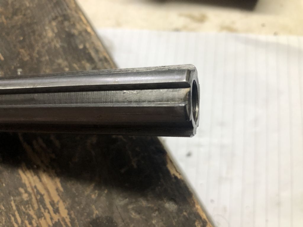

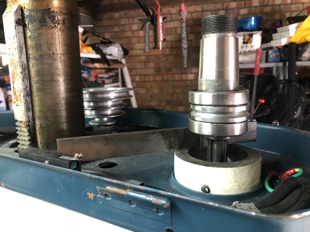

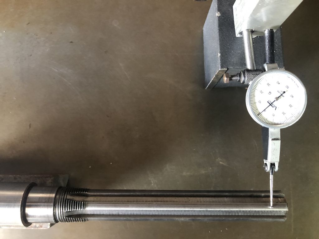

                    The quill is out, the spindle is out and all the bearings removed.
                    The problem….and this is where some of you will say " I told you so"…..there was a bruise/ burr right at the top of the spindle splines which was sufficient to hold the pulley shaft so strongly that after the WD 40 loosened everything and I raised the quill using a wooden lever ( with a wooden block underneath for protection ) it pushed the pulley shaft and bearings out the top of the head….!!!Wooden lever.jpg
                    bruise burr side.jpgI was then able to remove it and all the bearings and spacer using a gear puller and the quill dropped out….!
                    pulley spindle out.jpgI had twice listened to your advice about the possibility of burrs on the splines and inspected those splines but missed what was in fact a flat round edge ' bruise'…? no sharp edges.
                    I did not believe that the 'bruise' was sufficient to jam things that hard so I put the spindle between two 'v ' blocks on my surface place and checked that it was true………it was…………the bruise/ burr was the actual / only culprit.
                    splines true 1.jpgsplines true end best.jpgBoth spindle bearings were in a shocking condition and I am ashamed that I continued to use the mill with that excessive run out and noise…
                    I have owned the mill from new and at some point I had damaged the top of the spindle..I was the author of my own misfortune.
                    Thanks again to everyone who responded and tried to help, Old Mart, DiogenesII and John Baguley who continues to share valuable information.
                    At some point I will put the whole photography sequence together with a narrative as a U Tube video so it is available to everyone…
                    I am truly grateful for your information and interest.
                    Edited By Terry Turner 2 on 07/08/2021 20:17:35

                        Great to hear the good news, Terry. I would advise renewing both bearings, and use a common lithium high melting point grease. Be sure not to overpack with grease, leave at least 50% air within the quill. Hopefully, removing that label at the front of the head will allow fine tuning of the bearing preload. The correct preload is when running fast for 20 minutes only heats the quill/spindle lukewarm. If the preload is too great, the assembly will overheat very quickly. I have bought bearings from this firm several times and can recommend them. While you are at it, don't forget to check those pulley bearings, and see if that little screw is intended to hold them in place.

                          Thanks Howard, and yes Old Mart, I have decided to renew the pulley shaft bearings as well as part of this project.
                          I shall also put new belts on, make a new anti-rotation grub screw and I will do a 'Edwin White' modification to the rack which raises and lowers the head so you don't lose alignment when doing that.

                            Good to see a thoughtful disassembly carried out with care – well managed, Terry – Your plans sound very good to me – I think it'll feel tangibly 'better-than-new' when you have it all done, which ought to make for a pleasing result to look forward to at the end of the job.

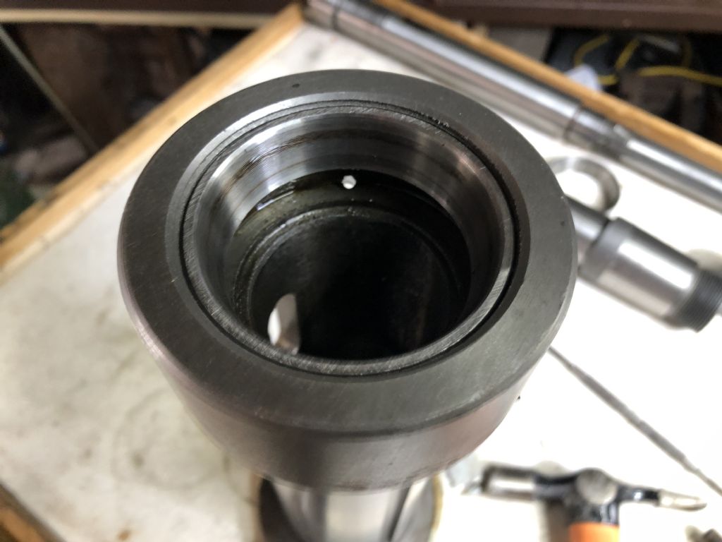

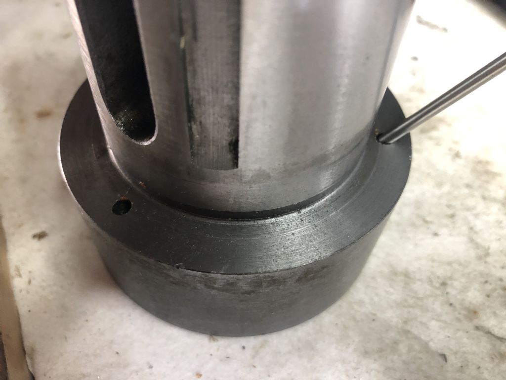

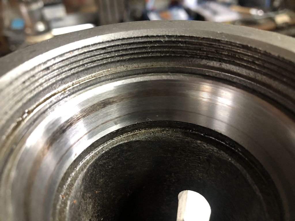

                                                  Chester quill bearings.
                                                  I missed something again….!
                                                  The lower taper bearing race has a pronounced lip protruding into the ID of the quill so it was easy to remove..
                                                  I turned a cylinder the ID of the quill , ( it is a rough casting so a loose fit was all I could achieve) I then dropped the cylinder into the quill so that it sat evenly on the bearing race lip and a sharp tap with a drift removed the seat without any distortion / damage to the casting.
                                                  The upper quill taper bearing race is a different 'kettle of fish'.
                                                  There is no protruding lip and the bearing is completely enclosed within the housing.( see pic )
                                                  I could not imagine what kind of engineer could create such a design…?
                                                  I thought long and hard about the options and eventually decided that some more thinking time was needed and stood the quill up on my table ( I normally lay it down) …….THEN I NOTICED…..three small holes in the exterior/ reverse side of the bearing housing.
                                                  The holes are 3.5 mm did so I put a piece of rod into one and found it was a 45 degree hole which obviously led to the back ( inaccessible) part of the bearing .
                                                  Tapping each in turn loosened the bearing and moved it enough for me to get a drift in and finish tapping it out.
                                                  I now understand that it is quite a common practice to provide such access holes but I have never come across them before and the fact I didn't notice them has reinforced my reputation for having poor powers of observation. ( You will remember that I missed the bruise/ burr on the top of the quill spines that caused me so much trouble )
                                                  The bearings are purchased so the re-build will start any day.
