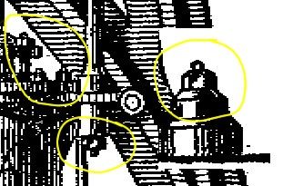

                    Back to the original topic, here's a couple of excerpts from an etching of an engine I'm modelling. As far as I can see the etching is very accurately to scale – but look how thin the screw threads appear compared to the size of the nuts:
                    It may be exaggeration, but I don't think 'one size smaller' BA nuts will be right for this engine.

                      The only nuts used in the Levant engine, (just four from memory) in Cornwall are square nuts (probably made, with the bolts, by a local blacksmith; so unlikely to be a standard thread!)
