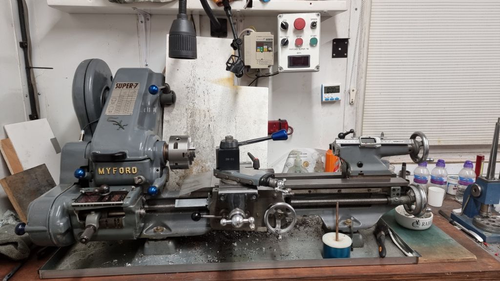

                                                    I’ve just spent a few days installing a Teco L510s on my Super 7B. A challenge for me, and one I would have failed were it not for the kind support and advice from this forum. Setting the parameters was much harder than it should be, and appeared to me to be in parts illogical. I certainly underestimated the complexity.
