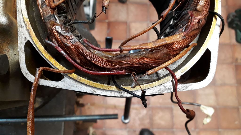

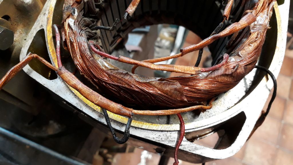

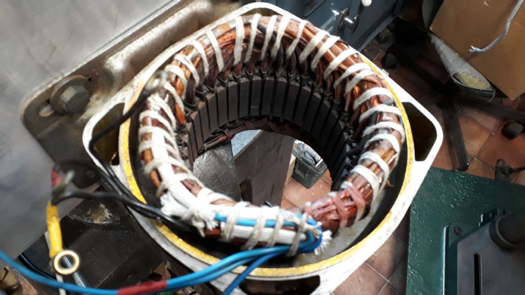

                                William Chitham
                                  @williamchitham75949
                                  I've just rewired an old Newman motor as described by Andrew. First one I've done and a bit nerve racking but it went ok. I found the star point was tied in on the same side the existing 3 tails came out, not surprising I suppose but for some reason I'd convinced myself it would be the other side so I ended up undoing all the binding unnecessarily. The windings and insulation are rather brittle once untied but I read somewhere that the existing varnish can be softened with a hot air gun and that worked really well making it possible to squash the revised wiring back into place ready to tie. I failed to find any of the special binding string within my patience span so I used cotton string but I found a supplier called Brocott who have the special varnish in small quantities and various other winding related supplies including the glass fibre sleeving.
                                  William.

                                    William Chitham
                                      Happy to help Martin, here are a some photos of my motor's innards showing the star connection and the finished job before varnishing. I bought the red varnish expecting something translucent but it was actually opaque, more like paint. If I did it again I'd go for the clear. As Andrew said the connection was soft soldered, it did take quite a bit of scrubbing with fine emery to clean the insulation off the winding ends to get a good joint on to the new tails. There are a couple more photos in my Meddings album.
                                      William.
