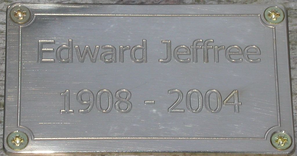

                John –
                Makes the point very nicely.
                Another example of a 1-off that was done using CNC, and which would have been very time consuming indeed using manual techniques, involving a steep learning curve in hand-engraving just as a starter:
                Again, not a single line of G-code was written during this process. As observed in the text, I could have made a more traditional-looking job of the numerals; with a larger table available to me on the mill (or maybe a small CNC router), the answer would have been to draw out the numerals “properly” in CAD rather than using a rotary axis and the in-built Roman fonts.Also, the CAD/CAM tools available to me have much improved from the rather primitive SuperCam package I was using back then, so life is even simpler now.
                A later example is this brass plaque that I engraved using a CAD drawing for the outline/screw holes and DeskCNC’s in-built stick fonts to engrave the text:
                Again, doing the same by hand would have been impractical both in terms of time and personal ability.
                One-off work is just as legitimate a target for CNC tools as is repetition work, and IMHO the former is much more likely to be useful in the average ME’s workshop.
                Regards,
                Tony
