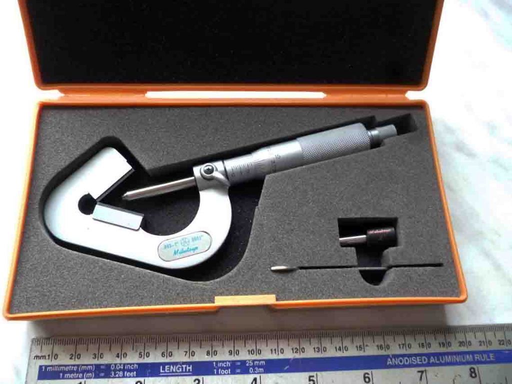

        Hi All,
        Rummaging in the crates of stuff from the auction I found this lovely thing like brand new but it does not show on the MItutoyo site.
        Can anyone please tell me its use, must be for something special?
        Number is 114-202 reads 0.093" to 1" by tenths
        Only another 6 crates to go through…laugh
        Cheers,
        Martin

        Tony Pratt 1
          @tonypratt1
          I think it's for 3 flute cutters
          Tony

          Martin Connelly
            @martinconnelly55370
            Mitutoyu do/did 114 series 3 and 5 flute micrometers in a range of sizes eg 114-102 for 3 flute up to 10mm.
            Martin

            Martin King 2
              @martinking2
              Do you mean for checking them when making them?
              Martin
              #283989
                Mity catalogue more likely to be used when they have been sharpened on the flutes.
                Should fetch a good price

                mechman48
                  @mechman48
                  http://www.msi-viking.com/Mitutoyo-114-202-V-Anvil-Micrometer-009-1-Range-3-Flutes-Carbide-Tipped_p_641.html
                  ​£333.63p new at todays conversion price so worth a few bob Martin… interested to see what you find in the other crates

                    Nick Hulme
                      @nickhulme30114
                      Also very handy for detecting tri-lobal out of round which can read OK with a conventional micrometer
