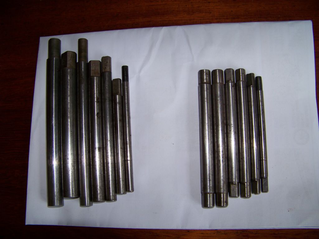

      I have recently acquired a small quantity of scrap steel rods,or so I thought. Upon examining them closely I found that 12 of them were some kind of measuring rod. The rods were of various sizes ranging from 6" long to 4" long. Four of these rods were turned down at one end the others were turned down at both ends. The turned down sections had a flat ground on to them,and on the flat was stamped the imperial diameter of the rod. Two of the rods were wrapped in greased paper, perhaps indicating they were a manufactured item as opposed to home made. I guess they were made to measure holes so that the appropriate drill size could be selected,however there might be a more interesting explanation. Any thoughts ?

          Mandrels? Do they have centre holes each end, possibly slightly counterbored for a shallow recess? Are they slightly smaller diameter at one end, and possibly hardened?
          I used mandrels years ago to grind aspects of cutting tools located accurately located off the bore. For example, grinding concentric registers for truing the cutters up before use, grinding the radial faces of the cutting edges with a thin grinding wheel.

                    Thanks "Bill Davies 2". That is exactly what they are. Tapered mandrels. Some do have a + sign stamped on them.
                    As it happens I have to cut some small gears and these will be just what I want. I am pleased now that I bought those "scrap" rods100_6097.jpg

                      The ones I used were for holding high speed steel gear-cutting hobs, and hardened; some were hard chrome plated.
                      These mandrels had a taper of only a few tenths of thous, as the diameter of the bores were within close tolerance, being ground and honed.
                      If you find tapers of several thou or so, then I would sugest they are for 'soft' work; turning or milling, but remember these are friction fits, so the cutting forces need to go towards the larger end.
                      We used a hand powered mandrel press, but not much force was required to press them in, but as I said previously, this was for grinding operations.
                      Bill

                        Thanks Bill davies2. There is only a few tenths of thou difference in taper on these. Why would some of them have a turned down section and flat at only one end and the others at both ends ?

                          Roger, the flats are for driving dogs, and you might find size and perhaps other info stamped or etched on the flat surface. It is possible, with care, to grind oppposite surfaces by turning the mandrel and work end-for-end, to avoid any changes to the work's position with regard to its centre line. Given the very slight taper, for precision work, the workpiece could cant very slightly, and opposite faces would not be parallel. Having said that, when I was "bossing and facing" the ends and registers of cutters, I pressed the mandrel out, turned the work around, and pressed the mandrel in again.
                          I have a vague memory of one end sometimes having a ring (or am I thinking plug gauges), but certainly one end was often shorter than the other.
