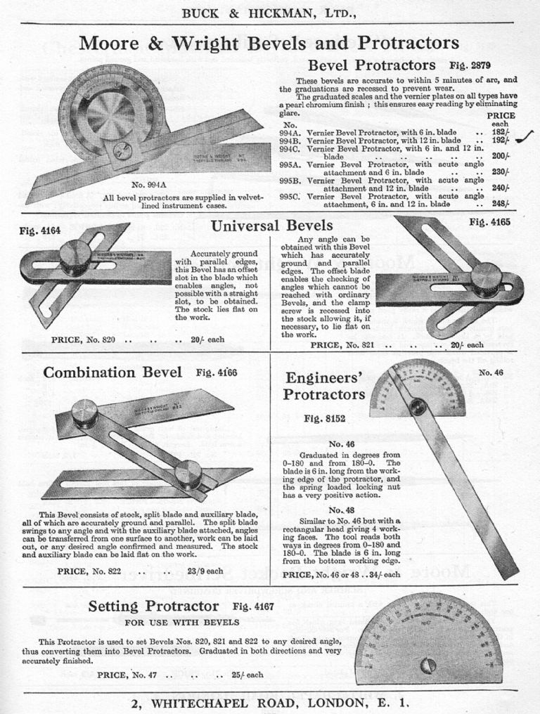

                      Just another tool query. I bought this Moore and Wright sliding bevel but have not seen similar before. Any suggestions as to its main use.

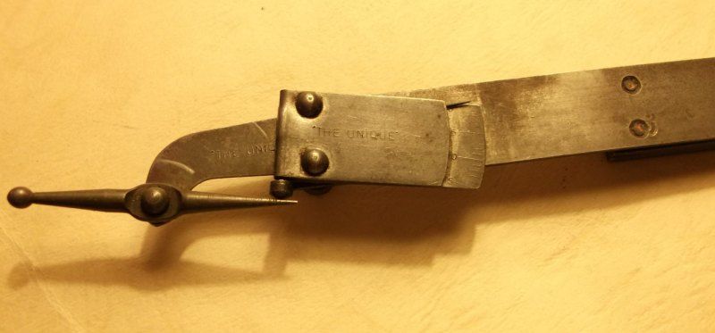

                        Can I add yet another unknown tool – tho this one is labelled "The Unique"
                        #278320
                        Jeff Chilver
                          @jeffchilver13861
                          This would appear to be an indicator , much used when dial gauges were too expensive for the average mortal , was used where a dial gauge would be used today , the most popular one was made by Verdict .
                          #278328
                          Nicholas Farr
                            @nicholasfarr14254
                            Hi Frances IoM, Jeff is correct, it is an indicator, which is mounted on an attachment for internal testing.
                            I have an indicator but not the attachment.
                            Regards Nick.
                            #278333
                            Nicholas Farr
                              @nicholasfarr14254
                              Hi Tractor Man, your bevel is a universal one.
                              Regards Nick.

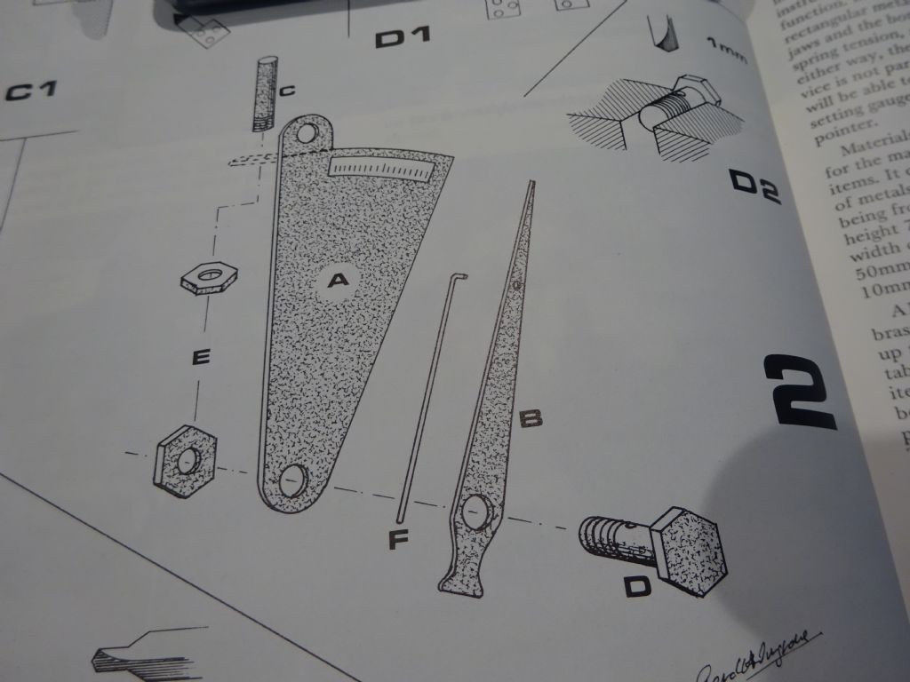

                                #278370
                                  Frances, I remember making an indicator along the same lines when in my teens, it was one of the tools featured in the book "Unimat lathe projects" as I was still at school I could not have afforded a proper dti.

                                    I have two of those Unique indicators (but sadly no attachment). They look anything but precision but are suprisingly accurate. John Mills showed one on one of his Youtube videos a few months ago.

                                    Tractor man
                                      @tractorman
                                      Many thanks to all for their help with the bevel gauge. The tool catalogue pages were very informative. Regards mick

                                        I have two of the Verdict indicators, one based to the left the other to the right. Surprising how useful they are

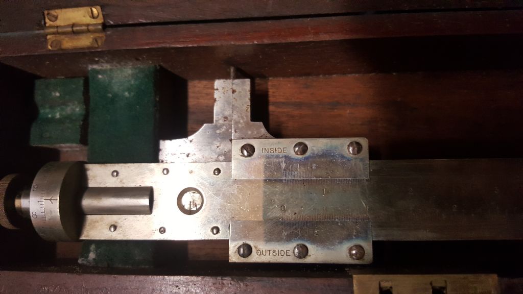

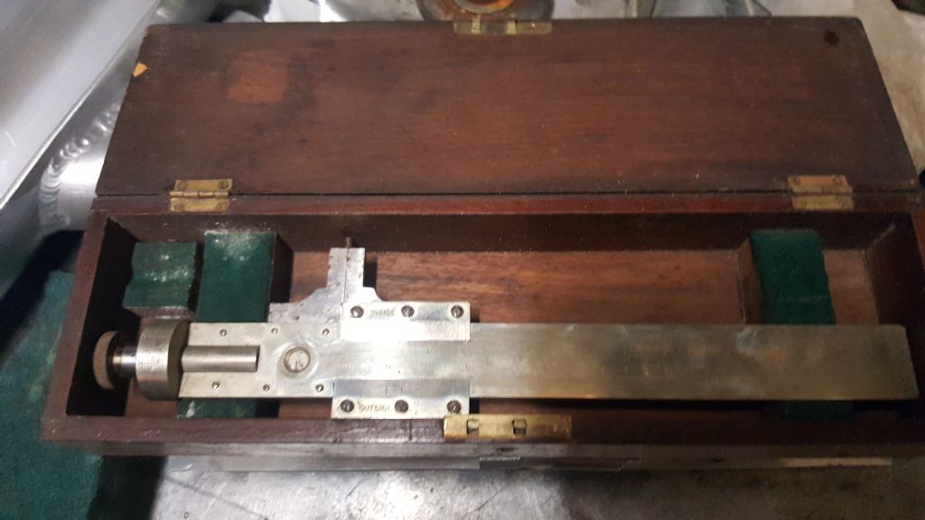

                                          anybody seen one of these before
