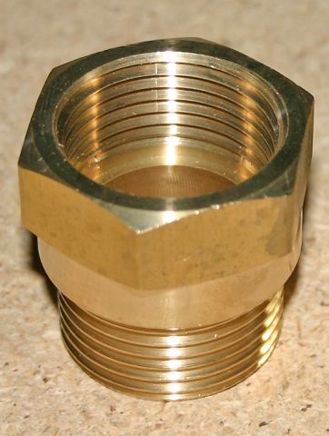

      Can anyone assist in locating a 7/8 (male) x 3/4 " (female) UNF reducing bush. I am blowed if I can find one on Google.

          Have you tried searching for adapter rather than reducing bush?

                  A few results from Google <here> …will need some further lookup from the results, based on the required application (air, water, gas etc).
                  Search term "7/8 male to 3/4 female UNF reducer". You could also try 'coupler'.

                        They are adaptors, not bushes. I expect that is likely what the OP needs, mind.(see Rod’s post earlier).

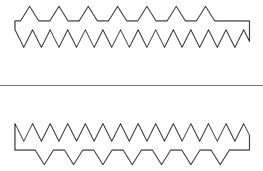

                                In most cases this “thread adaptor” problem is easily solved, provided you have a little proficiency in screw cutting. (I previously posted how I converted M12 threaded Morse parts for a 3/8 Whitworth drawbar). Clearly a wire thread insert works fine, so the problem is to make a similar item if the available wall thickness will be insufficient to support the cutting forces
                                However, we can trade wall thickness against the depth (or percentage engagement) of the external thread by truncating the inner portion of the thread form. Decide the minimum diameter necessary, and bore out the thread which needs converted to this size. Now turn up the adaptor per the sketch. Cutting the external thread is very easy to do using an ordinary V lathe tool, though preferable with a flat on the nose of the V. A pilot length that is a nice fit in the bored out mating part makes sizing easy.
                                Do not set over the topslide, but cut the thread increasing the depth to reach the pilot diameter. Now take cuts at this diameter advancing the topslide until the full thread is reached. You can check this using something with the same (full) thread.
                                Clearly it is best to cut the smaller internal thread first to allow a relatively thin wall.thread adapter.jpg

                                  Because of the thin wall section between the 2 threads, can you do someting like this ? Probably cannot buy a commercialy made adaptor and would have to make it yourself.
                                  Paul.

                                    That`s the obvious way where there is enough room for the extra length, and including any considerations about cross section if there is axial loading. In the case of something like a drawbar thread, it needs to keep within the original profile and also take the tension force.
