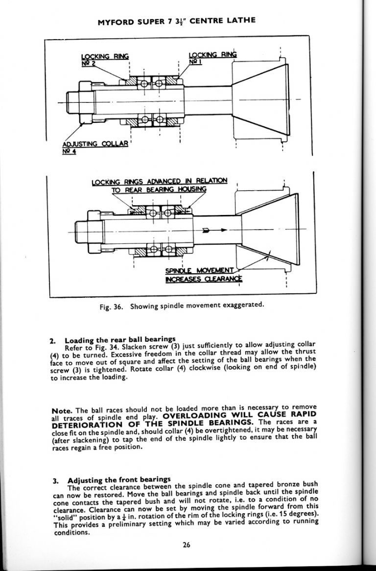

            Hello Peter,
            While Phil was replying I had already copied the pages from the Myford manual, they may be useful to others.
            Best wishes Brian
            myford spindle bearings 1.jpgmyford spindle bearings 2.jpgmyford spindle bearings 3.jpg

              Phil, Brian
              Thank you Gentlemen. Yes I have already removed the spindle and looked at the manual which explains how to adjust them but not how to remove them. From the diagrams it looks like there is nothing to retain them so I will take phil's advice and encurage them!
