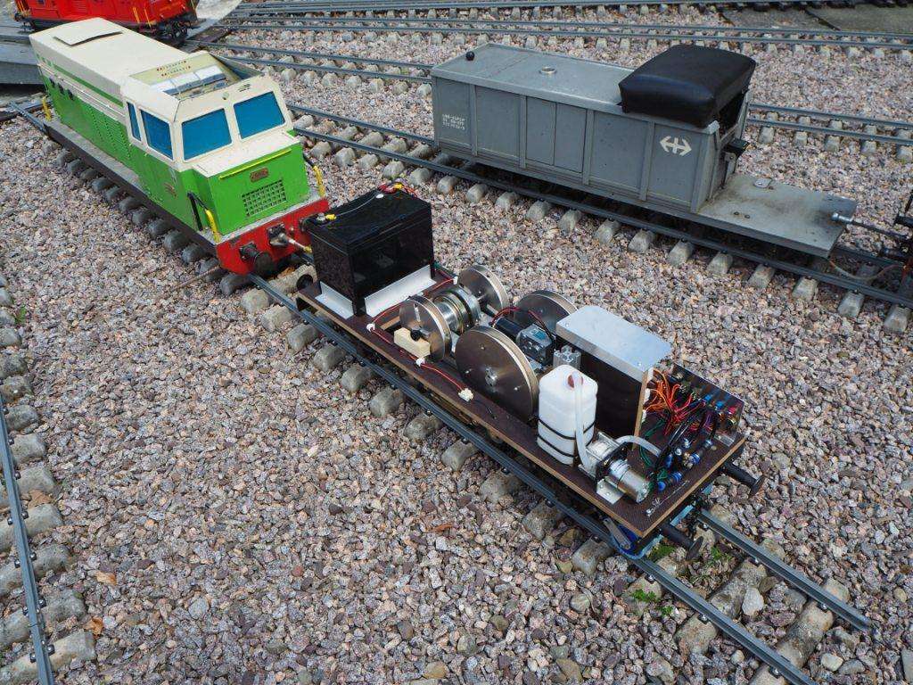

            This is the Swiss Steam Model Club version. It is used to clean the oil/grease residue off the aluminium rails using a fabric band with a solvent applied to it.
            07 Rail degreasing train (2025_08_27 16_25_11 UTC)
