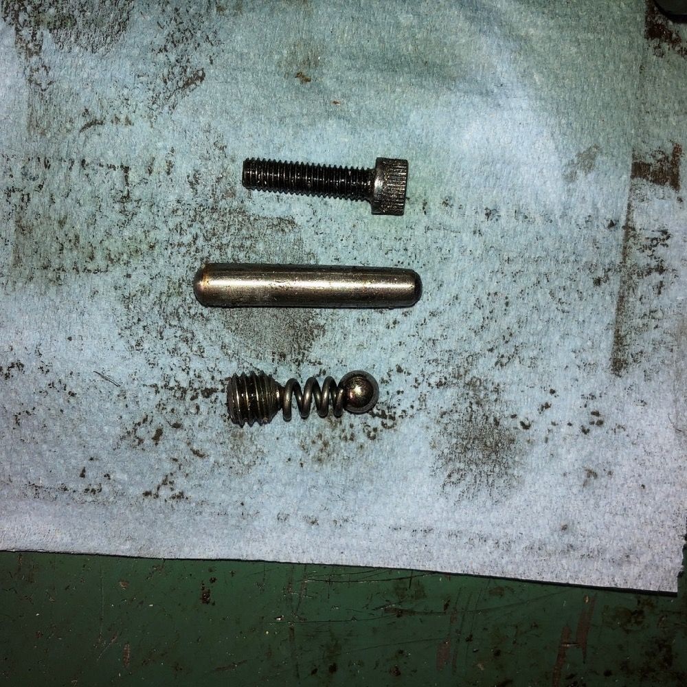

        I am reassembling my Senior M1 saddle after a thorough clean and re-oiling. I must have been on 'autopilot' when disassembling, since I just realised I don't know what the circled torpedo pin in photo 1 and adjacent hex bolt do.
        Photo 1 is the lever to engage/disengage the dog clutch from the power feed gearbox to a key way on the table x axis leadscrew.
        Close up of them in photo 2. (The grub +spring + ball sit in the front hole and hold the lever in 2 indent poisitions for engage/disenage).
        Photo 3 just shows one of the 2 flats on the lever shaft, that this torpedo pin must bear onto.

          The 'torpedo pin' is the table knock-off plunger which, when pushed down by the (adjustable) knock-off dog on the front face of the table, throws the table auto-feed out of engagement, by turning the black-knobbed lever. Sorry, can't remember what the screw does.
            ok that makes sense. So that's why one of the 2 sliding (approx 1" cubes) knock off dogs on the front face of the table, has a convex bottom face – to ride over and depress this plunger?

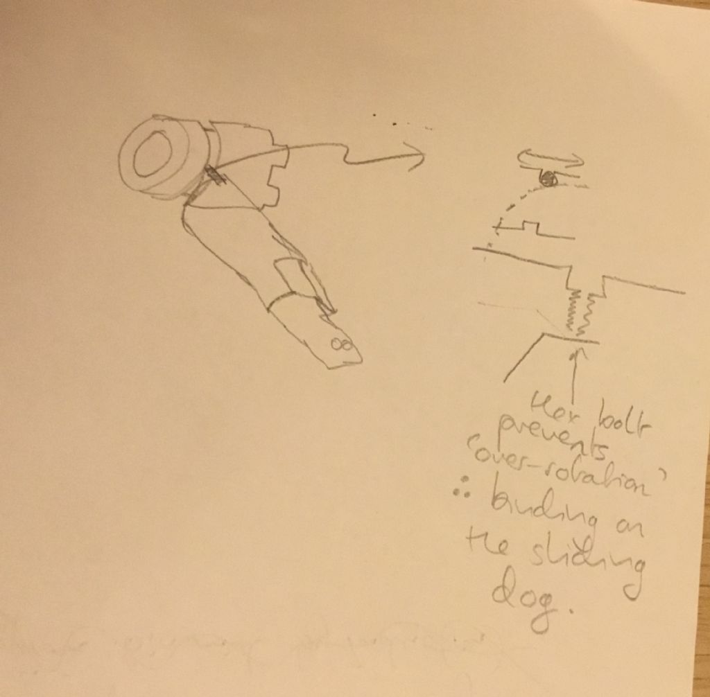

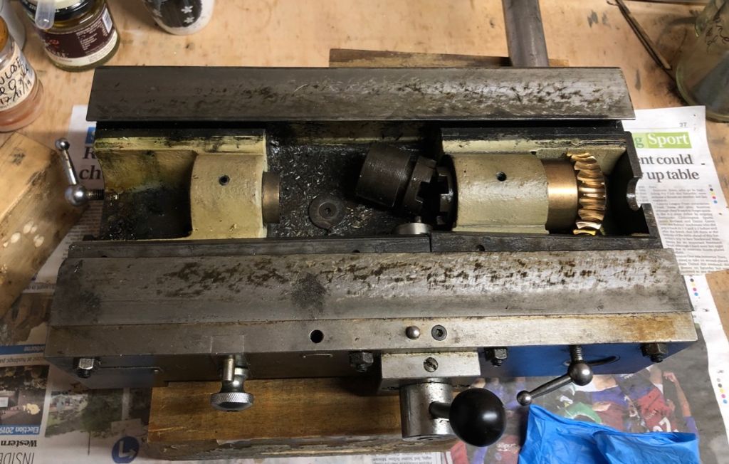

            I reckon I've now got it. My "Nature" standard sketch below (!) explains it. That hex bolt must bear against its flat to ensure the lever isn't push over too far. This therefore limits the L/R sliding of the dog clutch. But why does this need limiting? Second below is a more helpful photo of the complete saddle innards…what do you think?

            Defo an M1; stamped M1 on the CI column and on the brass serial plate on the saddle. An M1 restoration article I've read does stress there were minor variations in fittings within the same models. So what you described isn't unusual Senior practise.

              Yep, you've got it. I'd imagine that the screw is there to limit the arc of movement of the lever to something that looks and feels 'right' rather than to limit the movement of the dog clutch per se.
