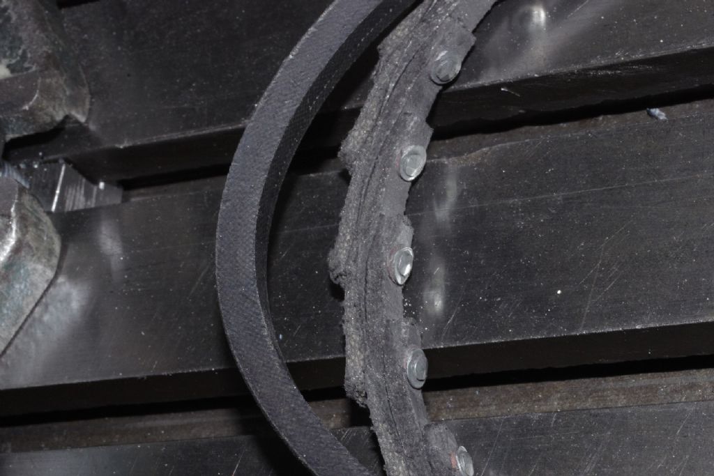

            As anyone who has seen some of my comments on link belting will know, i think they are for temp or impossible exceptions only. Far better to have a proper belt. How about changing the pulleys & using a toothed belt.

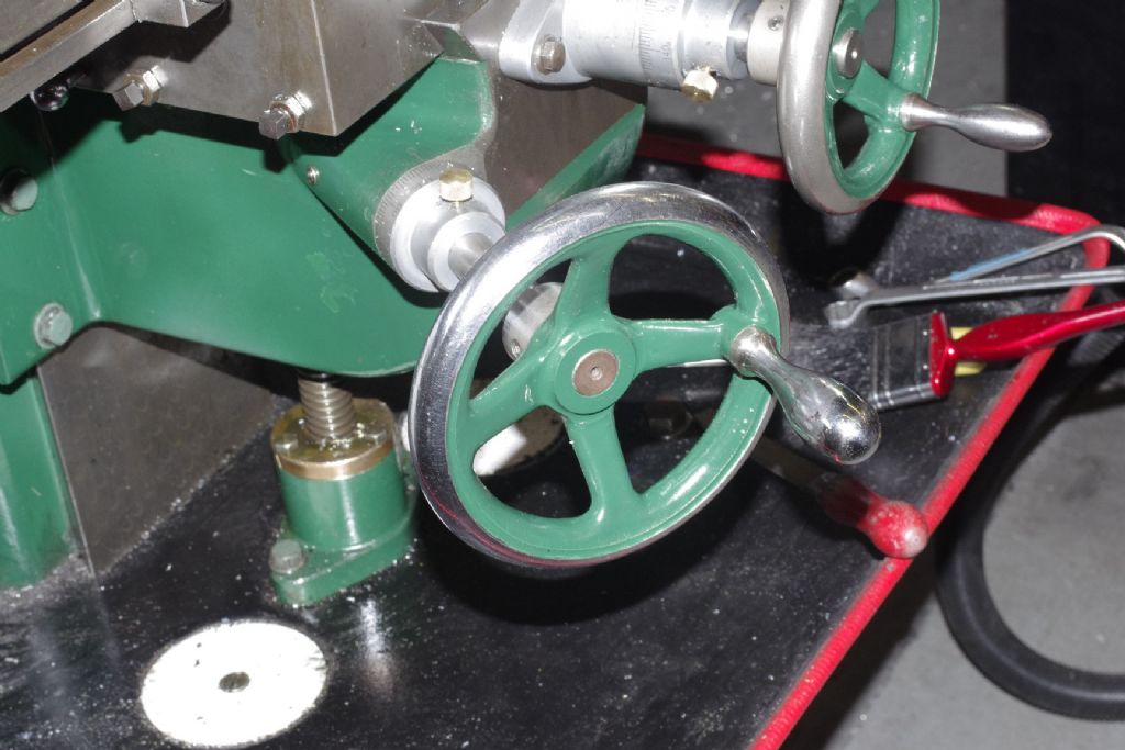

                _igp2673.jpgNot wanting to start yet another TS thread, I have an improved leverage handle for the knee. This helps when there is extra weight on the bed, especially when the knee is near the bottom of its travel as there is less wear and the gibs are tighter. The handle I bought has seven indexing positions and I just made the mating adaptor on the rotary table at the 51 degrees and 26 minutes, which is not exact, but fitted perfectly first time. I was lucky guessing the crank on the handle, as there seem to be lots of variations for sale from numerous old mills. It just clears the tray at the lowest position without anymore than the minimum shaft extension. Most of the time, the original wheel will be fitted, but I like having the choice._igp2672.jpg_igp2671.jpg

                  That's a nice addition. Sometimes when i am moving the knee from low down to much higher up, I always shout to myself dive,, dive,

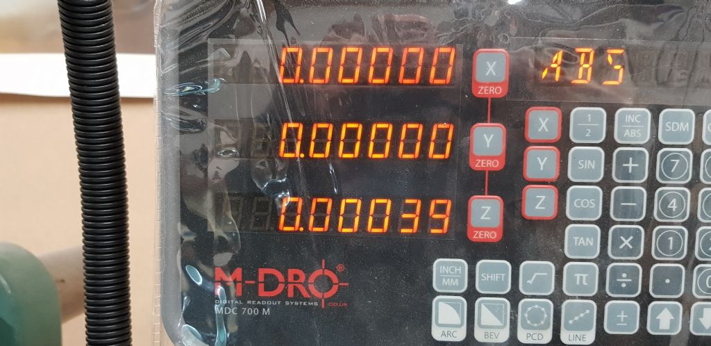

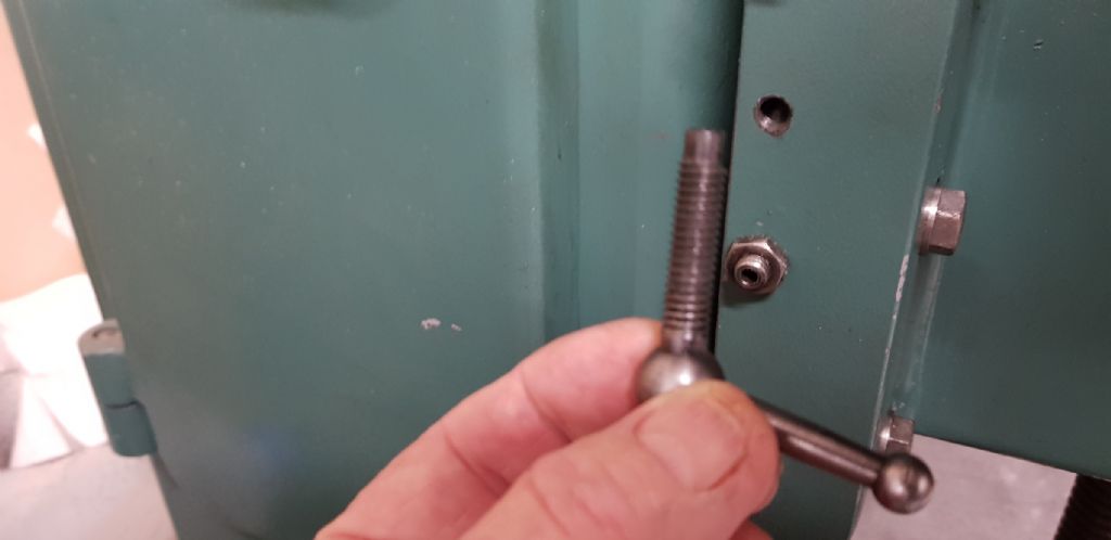

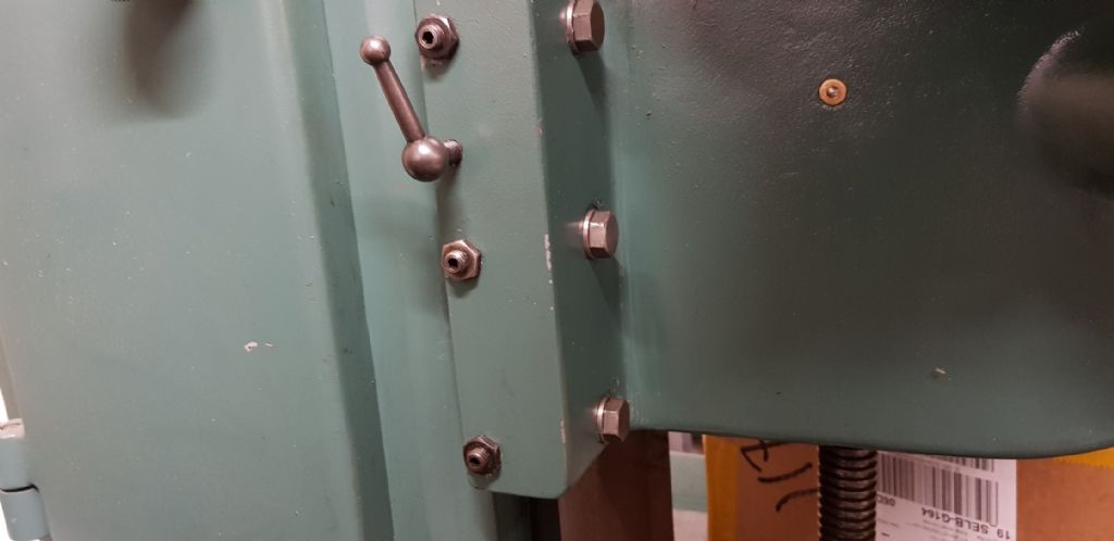

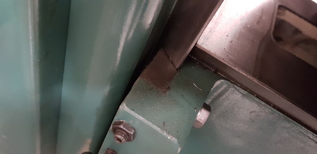

                          Question from the experts. I have tried numerous times to adjust the gib on the Knee of my light. Posting a few pictures to show.
                          The top picture is the whole thing with 3 large bolts holding the quite large steel gib strip in place. There are 3 adjuster screws & a locking lever in the other plane.
                          How i did it was to undo lightly the large bolts & adjust the gib with the 3 adjusters & lock up. Then retighten the 3 large bolts. No matter how i do it there is always some error.
                          Example. I raise the knee using the handwheel & then zero the DRO. Then i nip the gib lock & the DRO moves by roughly 0.00039. I assume that is 0.39 of a thou.
                          It is always the same.
                          I guess i am adjusting the gib strip wrong, Anyone any idea of the correct sequence as i have no manual for this machine. OLD MART, Help. or anyone who knows the machine.
                          Steve.

                          #504453
                            Posted by Steviegtr on 30/10/2020 23:08:19:
                            Steve,
                            With the greatest respect to Tom Senior [purveyors of fine machines to the gentry] … I doubt if they were measuring to hundredths of a thou when they built them.
                            Methinks your DRO is too sensitive for comfort.

                              Posted by Michael Gilligan on 30/10/2020 23:26:00:
                              Steve,
                              Well i would agrre to your comment but the X & Y work perfectly. Just the z that moves every time i nip the locking screw. Maybe you are not the person i need to comment. Unless you have some experience of this fine machine.
                              Steve.

                                    My point was very simple, Steve
                                    0.00039” [which, for the benefit of Metricated readers, is almost exactly ten microns] is smaller than the tolerance to which I suspect the Tom Senior machines were made … and it is very small in ‘general engineering’ terms.
                                    I routinely work in microns on the microscope … but not on the milling machine.
                                    My assumption is that the action of locking your Z-axis pushes a pointed, or rounded, screw into a countersink in the gib strip, which then centralises and thereby moves the table slightly. … The X and Y axes will behave a little differently, because gravity loads them differently.
                                    I look forward to being corrected by those familiar with the machines.
                                    … as I was taught long ago; it’s better to ‘lose an argument’ or ‘be proved wrong’ … because after that, one’s knowledge has improved.

                                      I was just as baffled by the strange gib adjustment on the TS knee. Our one is easy to move in the top 2/3 of the range and then gets tighter in the bottom 1/3. This is the standard wear pattern presumably, and I might try and do something about it when the new knee nut is made. Because the large ammount of backlash in the nut caused by wear would not normally be noticable because of gravity, I chose to ignor it when the mill was put into working order. The tightness of the gib at the lower part of the travel causes sticking and then the whole assembly drops suddenly which I don't like. I don't know yet how much uneven wear there is in the leadscrew until it is removed. I would be over the moon if I could get the knee to 0.00039" on the museum's machine.
                                      I am tempted to cut up the spare Smart & Brown model A leadscrew which I have, to make a replacement for the TS knee, it is 1" X 6 tpi ACME, which would require a new scale for the mill. I know it will never be needed for the lathe, but it seems just too vandalistic to contemplate until the TS knee screw is examined. I can even out the wear by singlepointing on the lathe and then make the new gunmetal nut adjustable for backlash.

                                        Posted by Steviegtr on 31/10/2020 15:04:03:
                                        I thought maybe there was a method i did not know about, due to the gib not only being adjustable from the side, but also locked solid by the front bolts.
                                        Steve.
                                        Having re-read that, Steve … and looked at the photo : I think we need to see some detail of the locking mechanism

                                          As I recall, the bolts have some clearance in the casting and are threaded into the gib. They need to be slightly loose, say a couple of foot pounds only so that the adjuster locking screws can push the gib into the dovetail, then the bolts are tightened. It is one of those frustrating adjustments which would get easier with practice, but with only one knee to adjust, you are not likely to actually get much practice.
                                          That 0.00039 figure with the DRO sounds like some conversion between imperial and metric, 1mm is close to 39 thousandths of an inch.

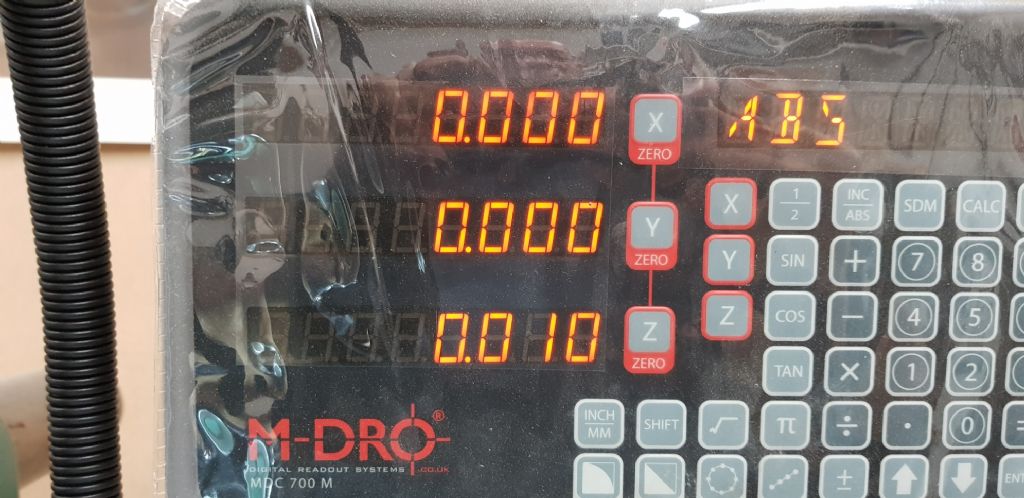

                                            Michael & old mart. Thank you for the replies. I have put some pics below to show the error in metric & imperial. Also the adjuster removed. This adjuster acts against the back of the gib strip as the most others are, there is no brass slug in there.. The strip as seen is a pretty huge chunk of metal. Old mart may have hit the nail. It sounds logical to not have the 3 front bolts set too tight. Which i may have done. Will have to give it another go.
                                            Steve.

                                                    My memory could be at fault, but I thought the knee lock screw pressed against a captive brass piston which was in contact with the main body of the mill. The gib has a hole through it for the brass piston. If the gib is adjusted and then locked by the bolts, the lock screw would not work just by pressing on the gib.

                                                      Posted by old mart on 01/11/2020 16:04:37:
                                                      Will have a look at that tomorrow. I did look down the hole but only saw shinny metal. I think the best way would to block up the knee & remove the gib for inspection & a good clean & lube.
