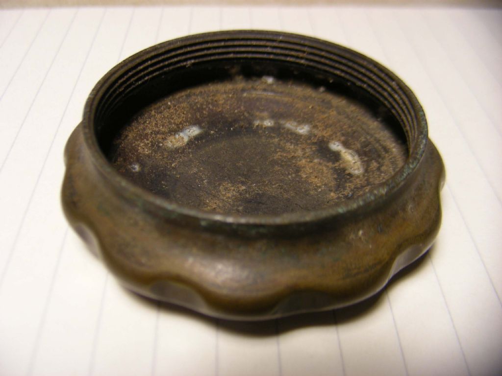

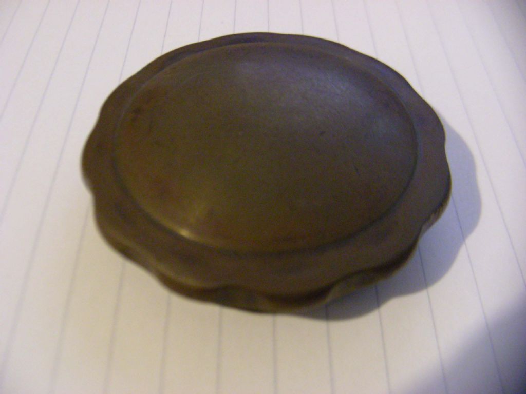

                      I have a couple of larger radiator caps (c49mm OD) both with 16 TPI threads and deduce that this may have been the standard for this kind of thing.
                      I assume that your smaller cap is for an Austin Seven. My own 1931 machine came with a presumably non-standard one with built-in temperature gauge; after this was stolen I replaced it with one that resembled one of the couple:
                      Not an answer to your question I'm afraid but I thought this might be of some interest. In your position I would regard the machining of the body with its pleasing form to be the difficult bit; the screwcutting looks straightforward.

                                              Unfortunately; if the original is like ega showed … I would think it's formed from tube, and then closed with a soldered-on cap.
                                              I would love to see how they actually made that.
                                              #560169
                                              ega
                                                @ega
                                                MichaelG:
                                                You are quite right – apart from the screw thread, the cap in my photos above is certainly formed as opposed to turned and milled. I can't see any trace of solder, however.
                                                The other cap I referred to looks like a brass casting and is much larger in overall diameter.

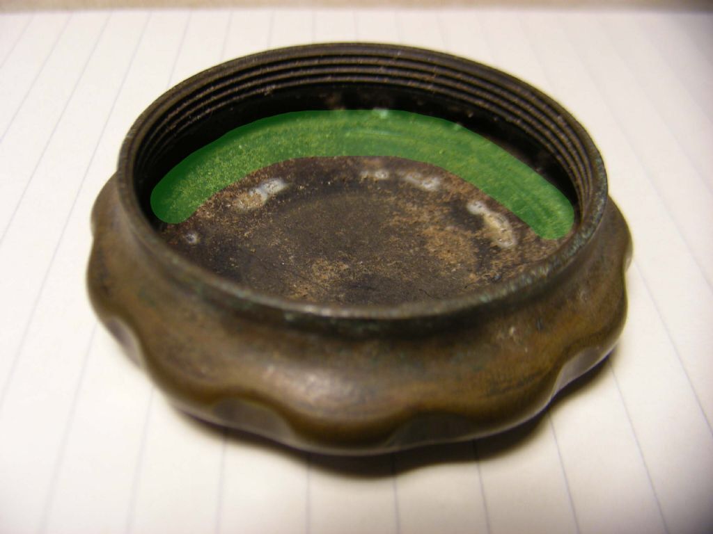

                                                      Posted by ega on 28/08/2021 17:22:01:
                                                      MichaelG:
                                                      Thanks for the confirmation
                                                      I had assumed [always risky] that the highlighted ring would have a solder joint
