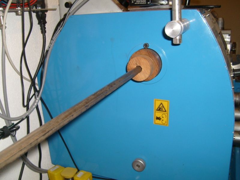

                              I also use wooden bushes at the end of the spindle bore. When the stock is thick and heavy, I use bushes to reduce the load on the spindle bearings, even if the stick out is minor.

                                  Very similar here, but use spirit/port bottle corks. They live on the barstock which effectively colour codes it.

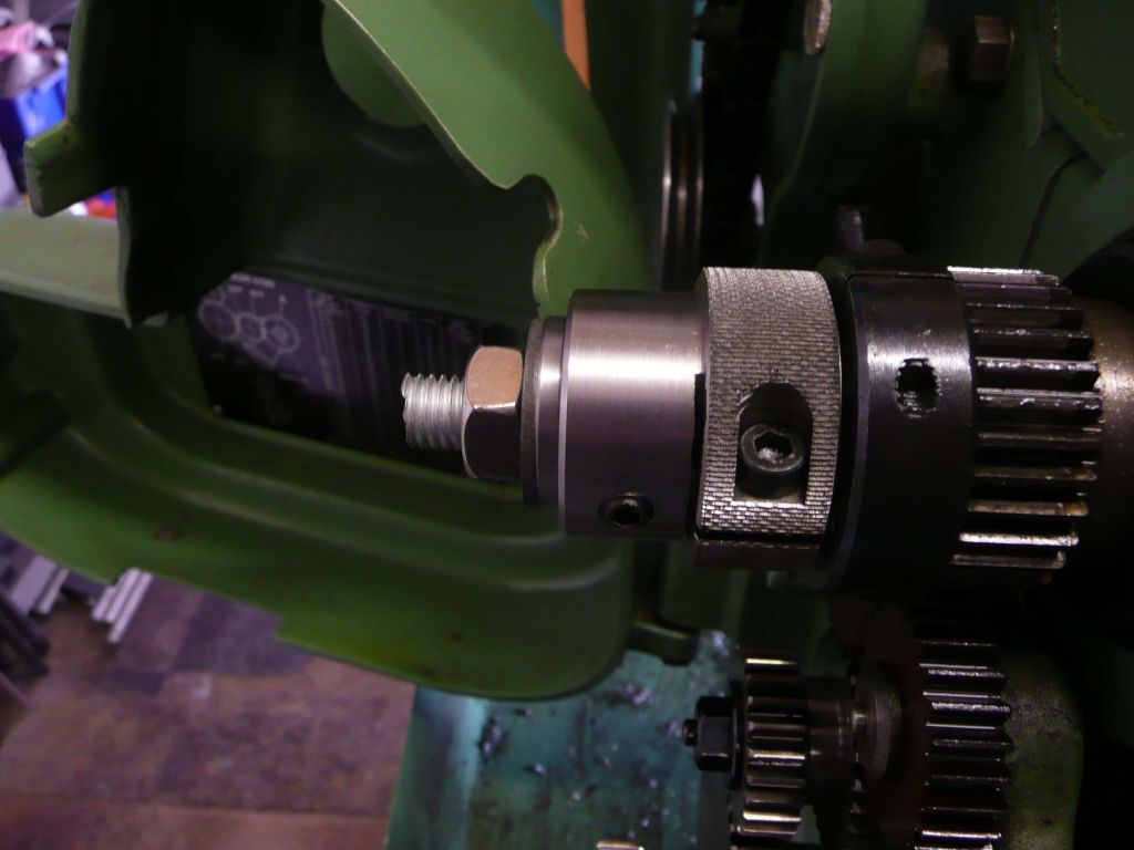

                                          I forgot to mention J A Radford's neat design for the Myford in his book Improvements and Accessories for your Lathe.
                                          He shows a bush holder clamped to the tail end of the spindle. Mine lives there permanently and is useful for other purposes. Here it is supporting an impromptu draw bar:

                                            I wonder if a modern update of the Radford bush would be to mount a ER collet holder (of a different series to the one in the headstock) in the same place.
                                              Good idea as it would positively grip the work; however, it would also likely foul the gear cover when closed.
                                              Incidentally, another advantage of the JAR holder is that chips from boring are less likely to be deposited on the gears.

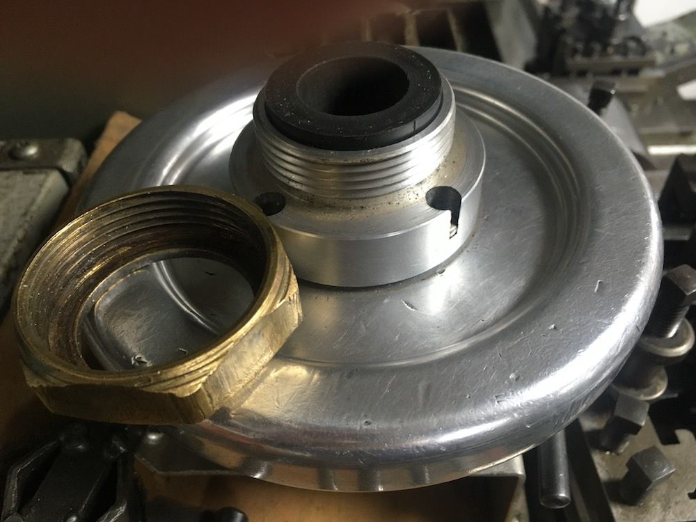

                                                I too went for solid bushes bored to size to support bars hanging out of the spindle.
                                                But mine is a bit more high tech.
                                                A clear out in the plumbing department shortly after doing a batch of long overhang jobs unearthed a brass internally flanged nut whose bore was a little bigger than that of the 1024 spindle. As the S&B 1024 has a native 5C collet fitting spindle nose and I have full sets of 5C in both metric and imperial my habit is to use the collets for slender materials. I made an adapter to go on the hand wheel of my collet drawbar to take standardised nylon or delrin bushes made as needed. Black for imperial, white for metric.
                                                Having made the beast after that batch of slender jobs convinced me that simply shoving a wadded up rag in the end was a bit too bodgy it sees very little use. I just don't seem to get jobs needing lots of slim parts these days so cut first, turn next is fine.
                                                I think the suggestion of using ER collets made by DC31k is probably our gold standard for this sort of thing given that folk like us are generally concerned with relatively modest stick out.
