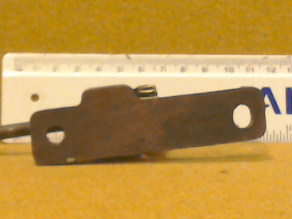

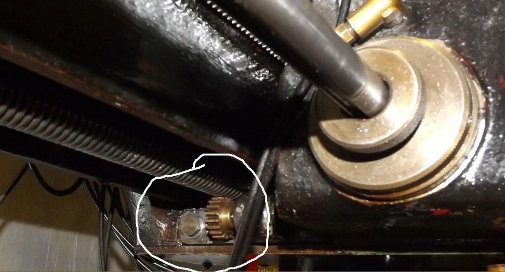

      I'm moving up a bit from the beginners section ! Lathe is a Smart & Brown model M mk2 , my dials drive gear is missing sadly, although the rest is still there .. Probably would have a job to get a new one now and it'll be 50 quid which i haven't got . Would this gear originally have helical teeth , and if i just made bodged a thin spur gear by hand file would it work ? There are good pictures on the Lathe uk site ,of a restored black one and it looks like straight teeth…but it cant be can it , if it engages the lead screw ? If it was thinner though…?

          Straight teeth are normally used
          Thread dial indicator
          #277222
            Posted by Ady1 on 12/01/2017 00:35:02:
            … and the idicator assembly is canted to match the lelix angle of the leasdscrew
            But here is a nice example of a 'worm-wheel' **LINK**
            https://goo.gl/images/tDghfW

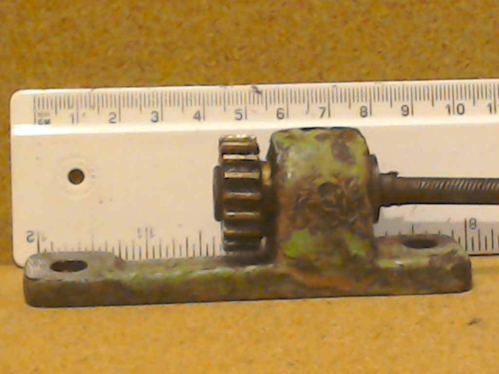

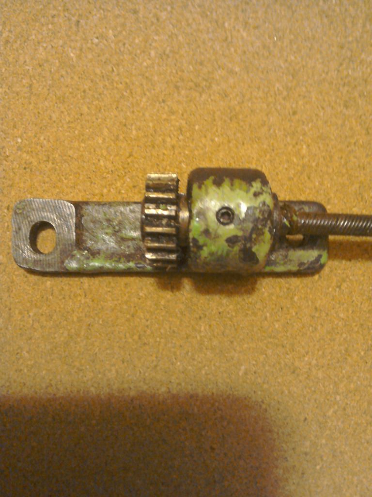

                There is some small angle to the gear teeth. It's a bit late now so I will get more details later.

                  That looks familiar ! An end on photo would be good smiley

                    The gear is 1.04" diameter. The lead screw is 1" diameter with 6tpi so by calculation the angle for the gear is 3 degrees.
                    Hope these are of use to you.

                      Thank you kindly , that is great information thumbs up

                                              18 tooth 20dp has a pcd of 0.9". Get a brass or plastic one and a thin file to open and angle the gaps a bit to let it mesh. There is no need for a great fit, there is plenty of play in the correct part. All that is needed is no jumping of the gear in use. The dial has six divisions marked 1 to 6 which are 1/2" movement of the carriage relative to the lead screw so any mark will work for an even number tpi count, odd numbers only for an odd tpi count (easier to remember than even numbers for an odd tpi count).
