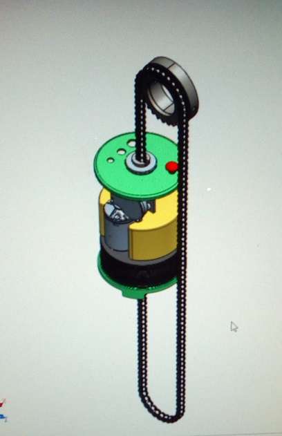

      I designed and built an automatic weight for a tower clock.
      The operating principle is called “Monkey up the rope.” Essentially, the weight contains a gear motor and lead plates. The motor winds itself up the chain when it has descended to a certain level. This system has the advantage of keeping the pendulum constantly loaded. Another advantage is that the application not requires machining or mechanical modifications to the antique clock. I’ve made a dozen of them, and they’ve been working perfectly for over five years. The overall weight is adjustable using additional plates and varies from 12 to 25 kg.

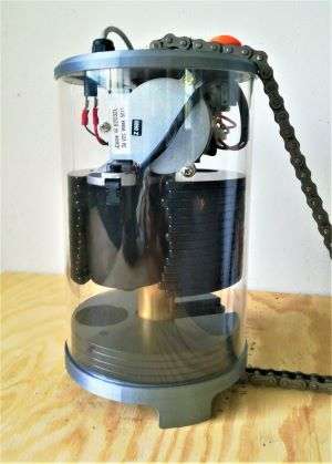

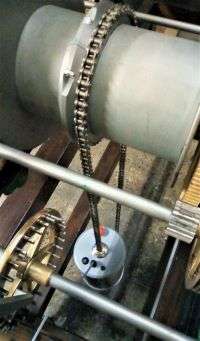

            No problem providing information about this product.This project was born from the need to automate antique clocks without compromising or altering their originality, as required by art heritage laws.
            The application only requires the diameter of the rope barrel to provide the corret diameter of the roller chain crown. BURST001_COVER 10 (002)
            The kit consists of the weight assembly + 5 meters of roller chain + a crown that encircles the barrel + a small 220/12-volt transformer.

              An interesting concept and food for thought. I think I would have a short chain and just attach it to the end of the rope to avoid having to get ‘into the works’.
              #812940
              dk0
                @dk0
                I don’t understand how it could work…. the weight just attach it to the end of the rope .

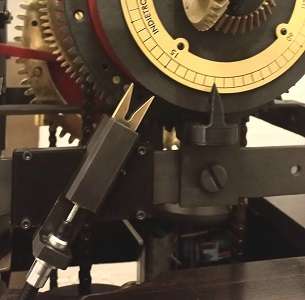

                              Remaining on the subject of restoring antique tower clocks, another aspect requiring attention is synchronization with the exact time.
                              The device designed is an electromechanical actuator controlled by a small PLC. Every 24 hours, the synchronizer activates a V-fork that indexes a pin on the minute wheel, correcting any errors of the pendulum.

                                  Does that forked device cope with both slowing the minute wheel when the clock is running fast and advancing it when the clock is running slow?
                                  Are the limits on adjustment set by the aperture of the fork?
                                  I assume this requires a pin to be added to the minute wheel?
                                  Does the device have its own GPS-locked internal clock? So does it require a GPS antenna?

                                        On Marcus Bowman Said:
                                        That’s an interesting device.
                                        The forked device can correct the error by +/- 1.5 minutes.
                                        Yes, the limits are determined by the fork width.
                                        A pin is mounted to the minute wheel.
                                        The PLC has its own quartz with high accuracy.

                                              On Bazyle Said:
                                              The synchroniser is interesting. Tower clock? Ours takes quite a lot of force to correct but not sure if that is the weight of the hands and gearing or just the friction to lock the arbor and wheel is set high.
                                              The shaft that transmits the movement to the hands doesn’t require much force to turn because it’s highly geared, and the weight of the hands doesn’t affect it either, as they should be balanced, so I think something’s out of place causing this stiffness.
                                              P.S. Please note that to correct the position of the hands, you need to release a minute indexing device.

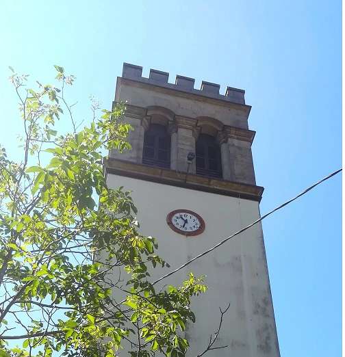

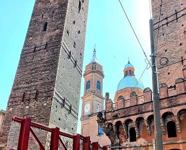

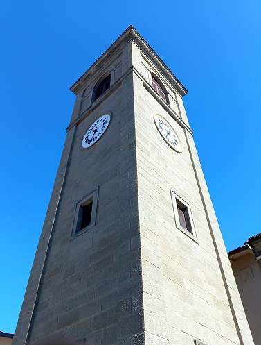

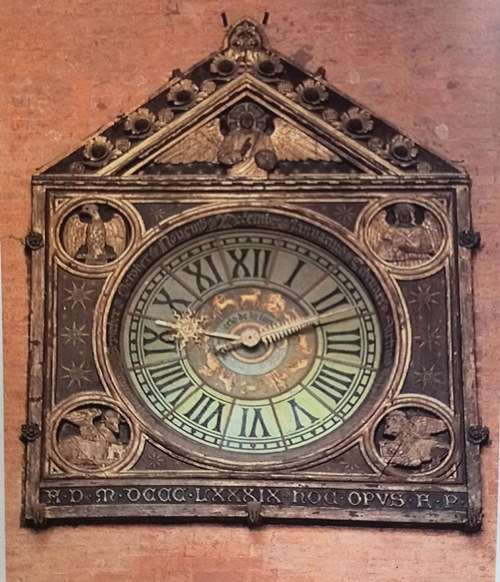

                                                My family produced about 100 tower clocks between 1850 and 1940. At that time, these clocks were located in our region of Emilia Romagna (Bologna).
                                                Of these clocks, 23 are still in working order, they are remotely controlled and I regularly maintain and service them.

                                                    How does the monkey “know” when to start and stop climbing? Are there limit switches attached to fixed points? Perhaps on a seperate rope.
                                                    #813298
                                                    dk0
                                                      @dk0
                                                      Stop climbing with a microswitch mounted on the weight.
                                                      Start climbing microswitch mounted on the weight and activated by the lower radius of the chain or alternatively, by a timer with programmed descent time.
