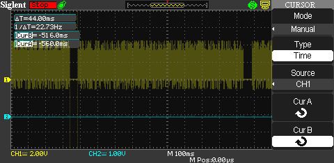

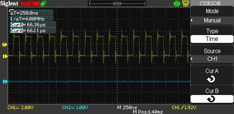

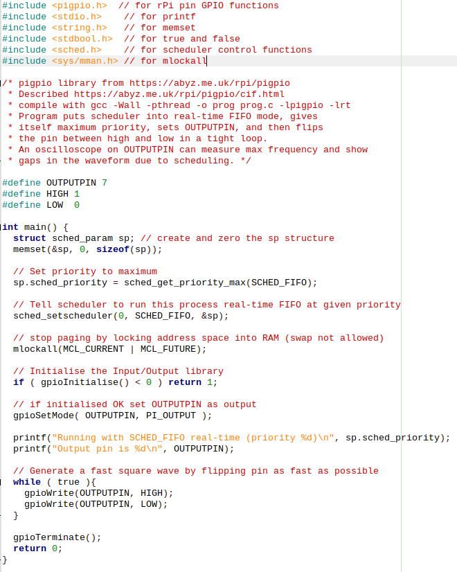

                                                  Sorry about the delay replying – having a busy week. I wrote this user-space code to test rPi output speed:
                                                  Assuming the library is efficient, I believe the program gets close to the maximum General Purpose IO output achievable from a Pi4. About 4.0MHz, two hundred times faster than linuxCNC's 20kHz, but unlike linuxCNC my code does absolutely nothing useful!
                                                  I think the scheduler and memory lock settings used have the effect of dedicating one of the 4 CPUs to my process, maximising the time between scheduler interruptions, and forbidding swapping (admittedly unlikely on a lightly loaded computer).
                                                  Next oscilloscope screen shot shows the scheduler to be working in blocks of 1 second, in which my program runs for 956mS, and is paused for 44mS in every second:
                                                  44mS is too long for my taste – needs investigation. Reading is more difficult I haven't found a quick way of responding to incoming bits in user-space yet.
                                                  Whilst busy flat out pin flipping the pi4 supports other activity more or less normally – the other 3 CPU cores handle business as usual and seem unaware that the 4th core is running flat out. Pretty sure the chip has ways and means of generating faster output in hardware, but that's cheating.
                                                  I looked at the linuxCNC source to see how it manages real-time IO and couldn't find it. There's a lot of code!
