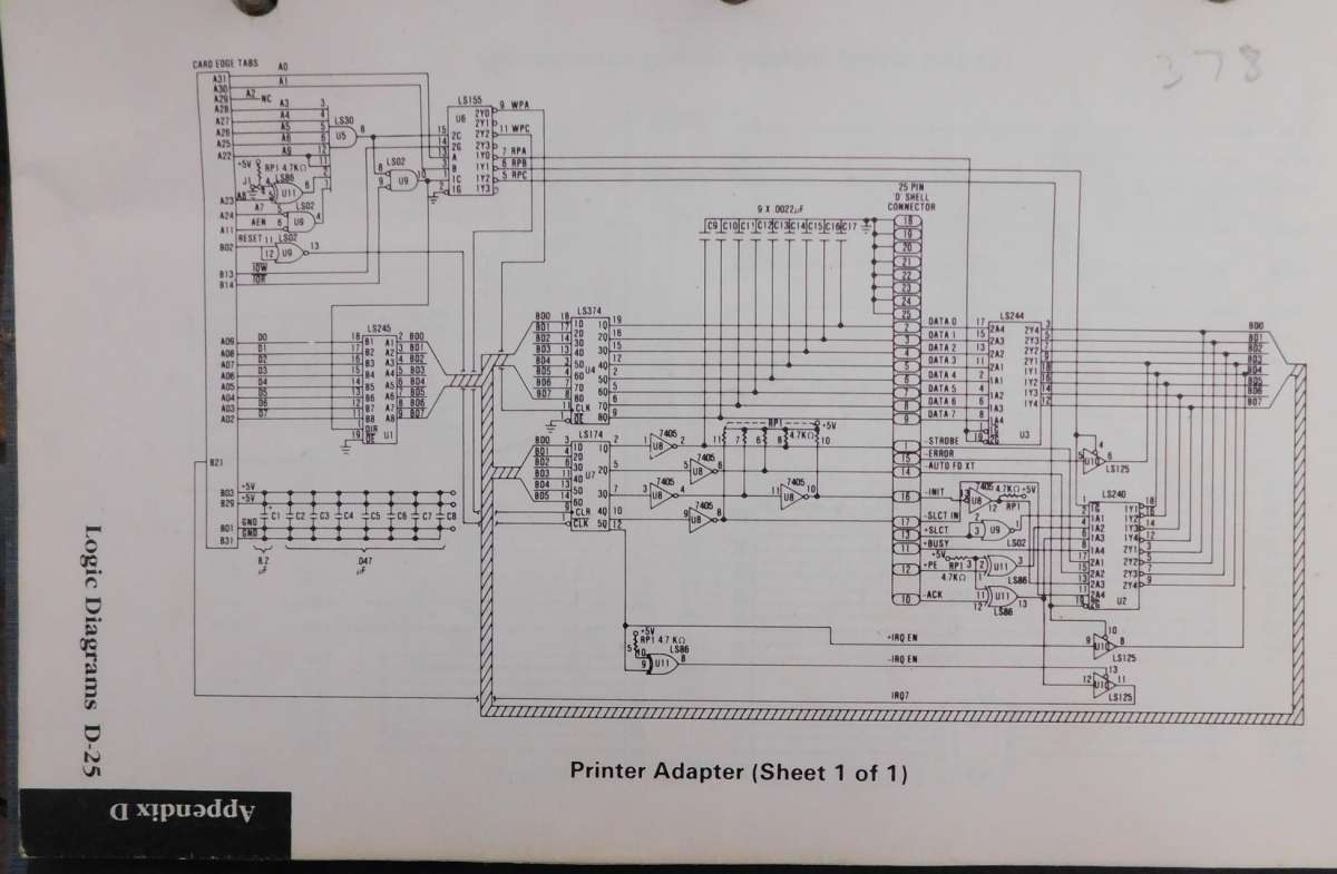

          Robin
            @robin
            Happy days when you could actually take over the timer interrupt with Bill Gates blessing. I still have the original IBM PC Technical reference manual with all the circuit diagrams including the printer port.
            It looked suspiciously like IBM made a motherboard with active low interrupts and expansion cards with active high dont know
            Rather than do a massive trip to the dump they found a weird edge-triggered interrupt and pretended that was what they always intended. Of course you only got one bite of the cherry, miss the edge and it was gone, but that was how things were and everyone muddled through laugh
            bestest
            Robin

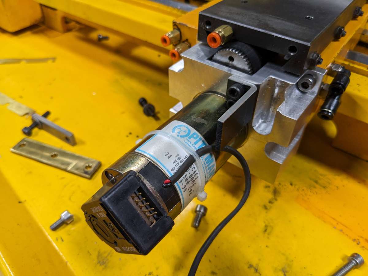

                    #711154
                    sam sokolik
                      @samsokolik60334
                      Kinda a side quest on the emco – automatic oiling…
                      https://www.youtube.com/watch?v=ejFw3V3sy2w

                        Robin
                          @robin
                          Just in case any of you have lost your IBM PC manuals…
                          PrinterPort

                            I drilled a bunch of interconnecting holes to bring all the oil fittings to the front of the saddle…
                            https://www.youtube.com/shorts/1xbJ-e6XY3U

                              #715494
                              sam sokolik
                                @samsokolik60334
                                Getting there..
