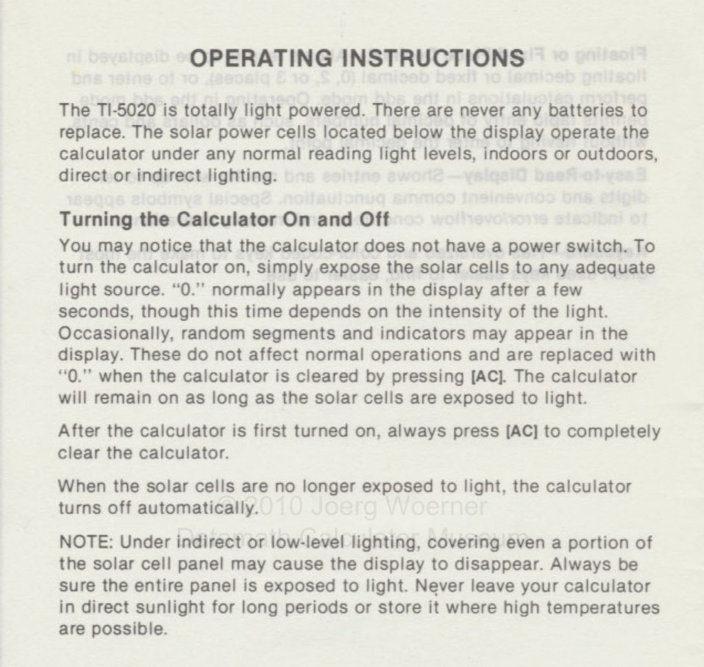

        I believe we have some TI calculator aficionados here, so I thought it worth posting this:
        I bought the calculator out of curiosity but then found that it displayed a lot of ‘broken’ digits whenever it turned on sad
        It is totally ‘light powered’ so there is no battery to replace, and I assumed it was a dud.
        Yesterday, I found the User Manual : **LINK**
        http://www.datamath.net/Manuals/TI-5020_US.pdf
        … which makes interesting reading as an historical document AND confirms [see p3] that such behaviour is anticipated !
        #570922
          Text from p3
          This must have been operating at the edge of what was commercially viable at the time.

                      Any sort of processor with registers in it is liable to wake up with them in a random state. The usual way of dealing with this is to apply a power on reset. Typically this involves holding a reset line low until there has been enough time for the power line to become stable, eg switches have finished bouncing and so on. A common way of doing this is for the reset pin to have a capacitor to ground and a suitable resistor to the power rail. Once the capacitor has charged enough the system comes out of reset in a known state. This sort of scheme is much harder to apply to a solar powered device, where the power may come up very slowly. So it becomes easier just to rely on the user to press reset.
