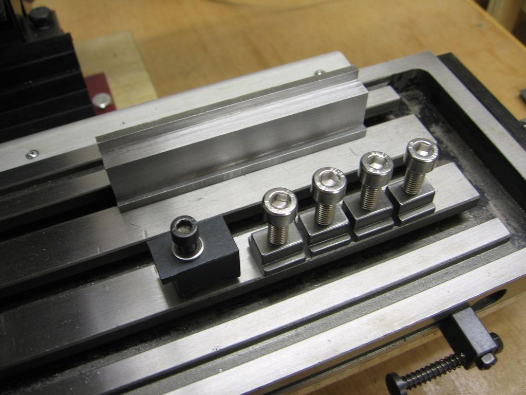

          Who knew threads could be so complex. I note from Harold Hall's tables that a 7.00mm drill gives a thread engagement of 65% which I think will be fine for this application and since I have that size I will use it. The thread is to receive a SS cap head screw which I will measure just in case they are seriously undersize, once again my thanks to all the contributors, I know a bit more now.

                I thought a wee update might be in order. I am making a bigger version of the clamp shown front left, and the piece of steel which started out at 30mm by 20mm has been milled to suit and at the weekend I will access the power bandsaw at the railway to chop off 26mm wide bits allowing a finish to 25mm wide. I bought some blank T nuts, at £1 each it's just not worth making them, to which the drilling and tapping presented no problem at all, Sometimes I think the fear of cocking things up is a too powerful disincentive to progress, and even the power tapping was susprisingly undemanding. Anyway a good result.

                  30 years ago I was involved on a large hard drive LM25 cast aluminium base,round the clock 7 days a week and tapped thousands of M8 holes using 6.8 mm drills,with no problems.If I was tapping stainless steel I would probably use 6.9 or 7 mm,

                    Not sure if anyone else picked it up. but Martin tells us this is for making T-nuts.
                    A tip, if these are for the conventional solid-floored T-slot in a machine-table or accessory.
                    Do not make the thread run right though, or stake the bottom thread, so the stud cannot contact the bottom of the slot. Tightening the assembly with such contact puts an unfair strain on the T-slot flanges, and can break them if cast, or distort them if cut in rolled plate.
                    The flanges should be gripped in pure compression between the T-nut shoulders and whatever is being clamped down.

                      Posted by Nigel Graham 2 on 01/11/2019 20:18:50:
                      The ideal situation – it is very difficult to damage the flanges that way, but unfortunately not always possible. Certainly, vises and suchlike are bolted this way, but on many occasions the holding studs are pulling on T-nuts which have no support above the table. In these circumstances it is simply a matter of using more support, with less force on each T-nut, if a lot of holding power is required.
