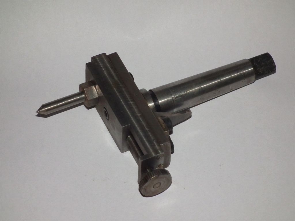

                          I don't know what is so difficult about resetting the tailstock. I just adjust mine so that a razor blade held between the centre points sits at right angles to the bed.

                            Here's one I made earlier ( many years ago )…
                            … only used it in anger once, did the job nicely
                            George.

                                    I made this one a few years ago, primarily to turn the tapered columns on a 'Lady Stephanie', but it's done a few other things (e.g. morse #1 for my wood lathe tools) as well over the years. The arbor was a commercial blank, force-fitted into the rest of the tool (which is mainly bar-stock). The moving slide carrying the centre is dovetailed into the fixed part. The rotation problem Clive refers to is prevented by the piece sticking out of the back besides the taper, which slots into the anti-rotation slot on the outside of the tailstock barrel.
