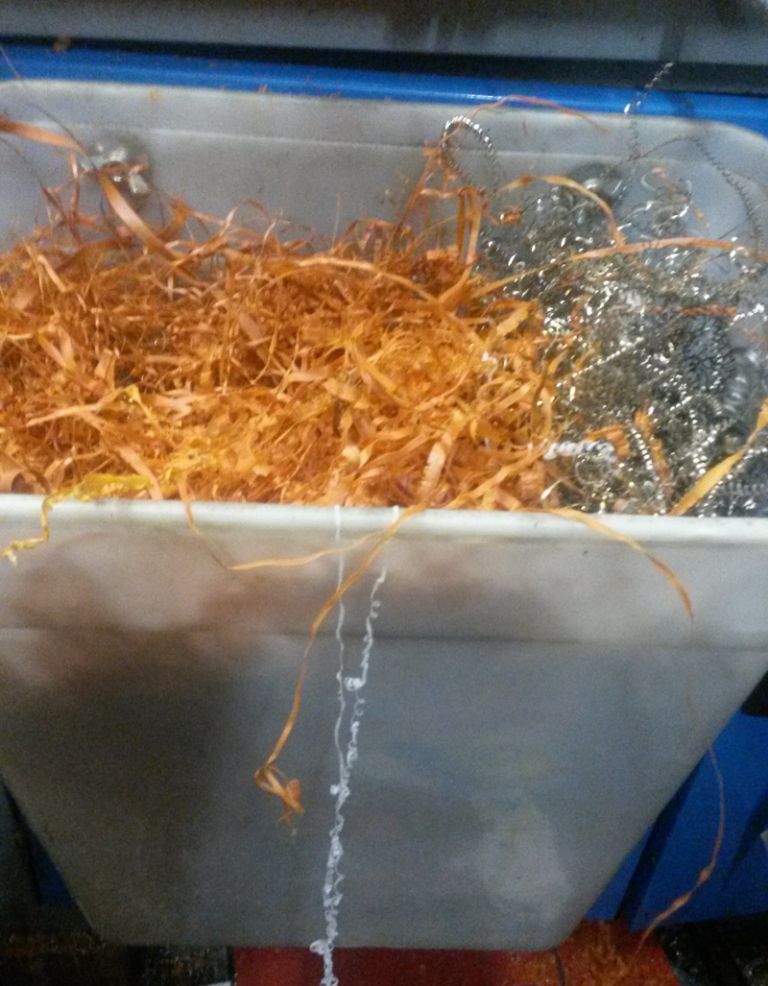

                    P.S. Bucket of Swarf
