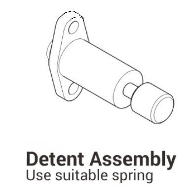

                                              Neil, I`m struggling to make the detent assembly from the detail parts shown on the drawing. Can you also tell me what the purpose of the "finger" and the "flag" please.
                                              Regards, Puzzled Essex
                                              #290213
                                              Journeyman
                                                @journeyman
                                                The "finger" and "flag" appear to be spurious drawing artifacts that have appeared somewhere during the publishing process, just ignore them, should look like:-
                                                The other parts for the detent plunger and cover seem to be quite clear and suitably dimensioned.
