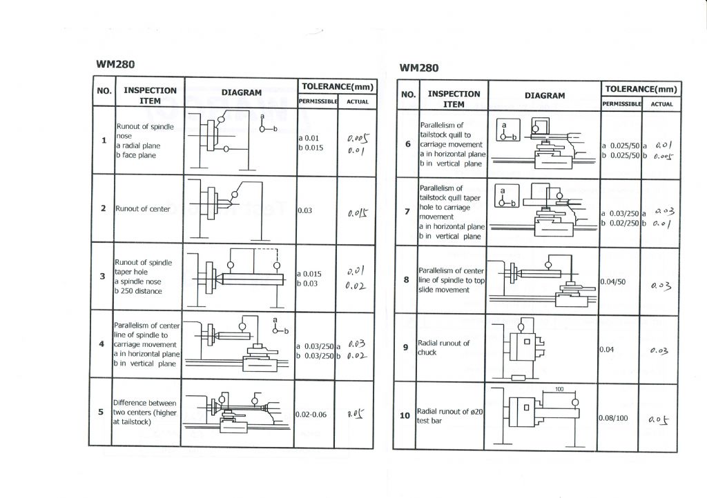

                      here you go, This is for one of the first WM280-VF lathes that warco did dating from March 2008, will be interesting to compare with the new one in MEW.
                      I've not checked any of these things, I seem to be able to make reasonable engine son it so can't be bothered looking for tenths if teh engines run and look OK. Click for larger image.

                        For instance my centres show a similar visual amount of miss alignment as the OP but the test sheet certainly doesn't show that amount. However I don't posses accurate enough centres and test bars to check it properly and I can't be bothered to make them either, the lathe does what I need anyway so I'm happy using it.
                        I can check a few things though so in the interests of fairness I'll check them after I've done the present job in the lathe and compare them to the test sheet.

                          Firstly, I'm more than happy with my WM280V so please don't get the impression from my comment that I'm not.
                          I've checked item 6 on the test sheet "Parallelism of tailstock quill to carriage movement" and I got similar results to the test sheet.
                          a – Sheet 0.02mm mine – 0.022mm so the same with rounding down (0.0009&quot
                          b – sheet 0.03mm mine – 0.015mm so better than the sheet (0.0006&quot
                          I'll upload my test sheet to my album – I got the impression that these tests are done at the factory in China and not by Warco in the UK
                          I used an imperial dti and guestimated the movement due to it being less than one division.
                          Non of which helps the OP in his quest for better accuracy on his machine.

                          #195754
                            Posted by Bowber on 04/07/2015 14:59:18:
                            Steve,
                            Just out of curiosity, I had a look at Warco's site
                            For the WM 280V they make the following statement:
                            • Each lathe is fully run and tested by a qualified member of our team before leaving our premises, and will be supplied with an individual accuracy test report.
                            As 'Contracts' man, I find this ambiguous regarding 'location of test' , but at least it does seem clear that the lathes are individually tested for accuracy.
                            Although this is [to me] of academic interest only: It may be useful if Warco could clarify the point at which the 'individual accuracy test report' is generated.
