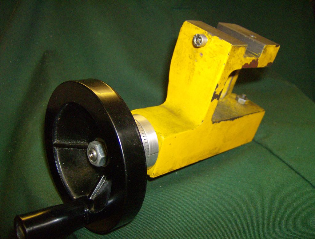

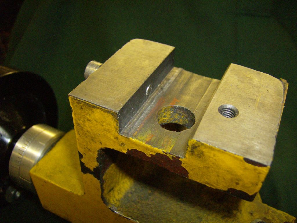

                      For clarity this is more or less the arrangement Nitai is looking at.
                      This is the upper part of the tailstock (as standard the slot is narrower and the cap-head is a grub screw):
                      Although the base of the casting appears to be ground on my lathe, the slot isn't – note I have milled another 1/8" off the left hand side here.

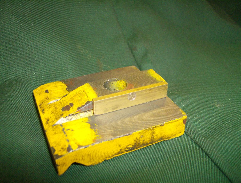

                      The finish of the base looks like it has been crudely milled and ground, but not enough to remove the machining marks. Note stray paint… Bear in mind this is an early-ish machine, my impression is that SEIG QC has improved since 1998!
                      Much easier to adjust side to side with that brass gib instead of a grub screw bearing on the side of the tenon!

                          laughSounds to me that the OP will persist in doing what they have read on the web what ever any one else says. Often the case.
                          Whether I shim the head or scrape/lap the tail… either way I go with it's what I read on the web
                          In the case of bolting the lathe… I'm not going by what I read on the web…
                          I did try to follow some of Neil's and your suggestions. I scraped a bit off the tail top part, especially a few obvious high spots in the the front side (i.e. the right side in Neil's second photo). The paint is thin enough that after lightly scraping a few high spots I can't even see contact on the paint on the front side, only the back side.
                          Now that I can adjust side alignment accurately and I'm happy with all other measurements, I think I'll just carefully lap a bit more and check and measure often that I'm not ruining any other alignment. If I see something is starting to move in the wrong direction I'll just stop and check.
                          Neil, yes that is the same exactly as my lathe. That brass gib is a good idea, I might add something like that at some point. I thought of adding a screw from the side, but I'd probably never want to move it out of alignment so only open it if it moves out of alignment to correct it.
                          It's hard to tell from photos but eventhough my lathe is pretty new, the surfaces the tail contacts don't look significantly better than on yours.
