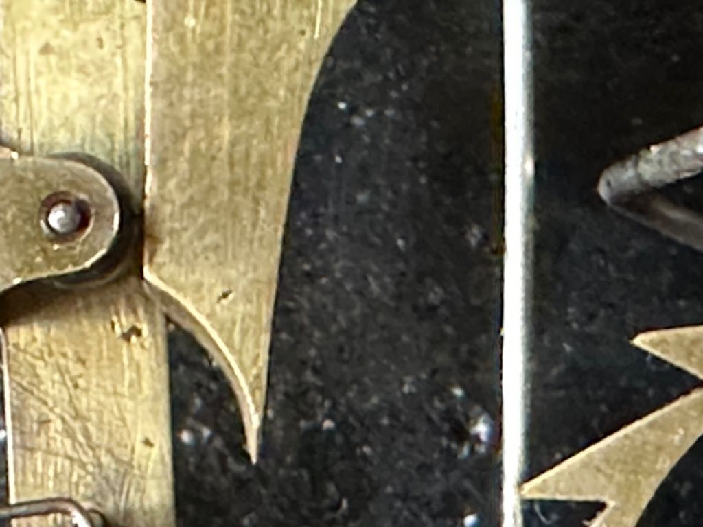

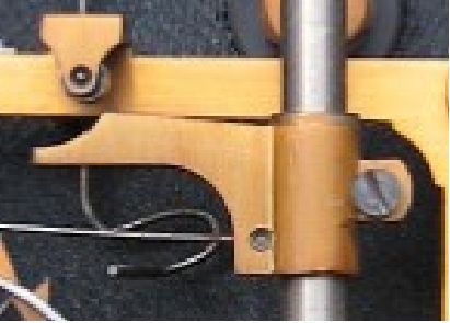

      I've been trying to get a syncronome master clock going as an occasional project for a while. Previously repaired them with great success. The clock is set up according to instructions I've found and everything works as it should but as I suspect it was a home built version from Syncronome supplied castings I'm getting suspicious of some of the dimensions’ and detail.
      I believe that Elliot Isaccs described building one in Engineering in miniature but cannot find it. Does anyone know of the issues or have access to them?
      Thanks Peter

                Thanks everyone. The impulse ramp looks different to other clocks when I search around also the latch arm which the "escape" wheel trips to drop the gravity arm. Sorry, cant rotate the 2nd pic!

                    Posted by Peter Bell on 12/05/2023 13:12:28:
                    Thanks everyone. The impulse ramp looks different to other clocks …
                    Please have a look at my posts in this recent thread, Peter: **LINK**
                    https://www.model-engineer.co.uk/forums/postings.asp?th=184730&p=3

                                Many thanks Duncan, got them all of and look really useful reading. The latch in the book Electric clocks and chimes looks very similar to the one on the clock, perhaps this was an older style latch.
