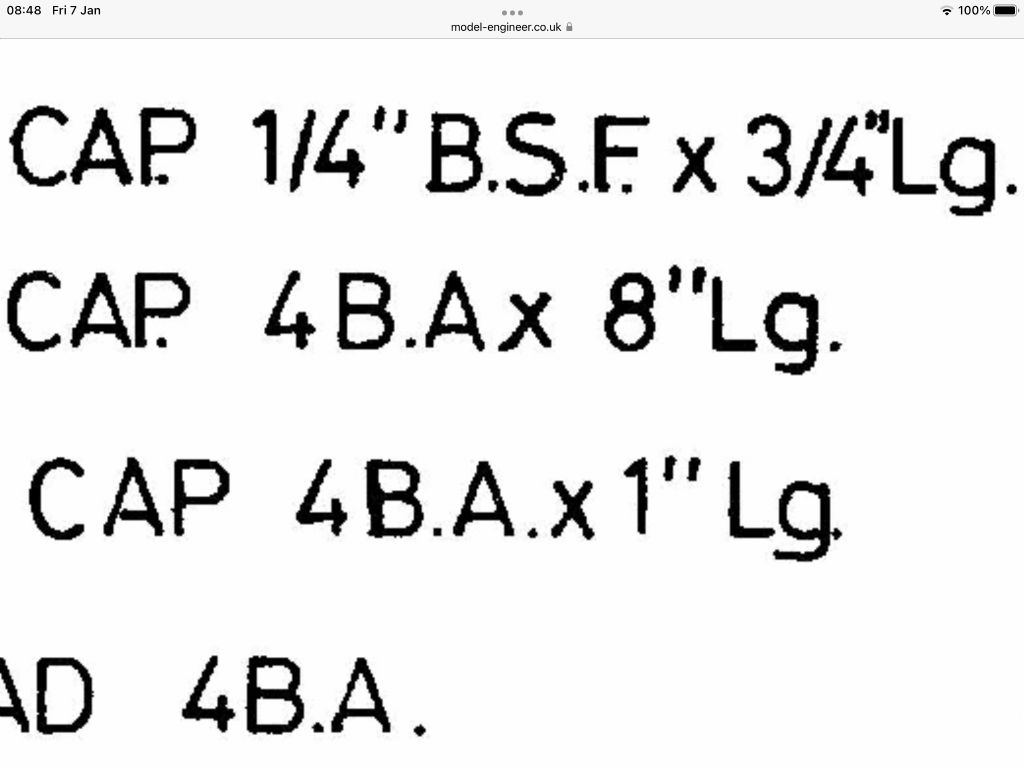

      Has anybody made the Rotary Table described in the Summer 1990 issue, please?
      I have looked at the drawings and carefully read the article.
      The list of screws on Sheet 2 of the Drawings mentions an EIGHT INCH long 4BA socket cap screw but I can't see where this is used in the finished article.
      The photograph on page 56 of the article doesn't have sufficient clarity for me to see how it's used.
      I intend to replace 4BA with M4 throughout but cannot find a 200mm long M4 Cap screw from any of my usual sources.

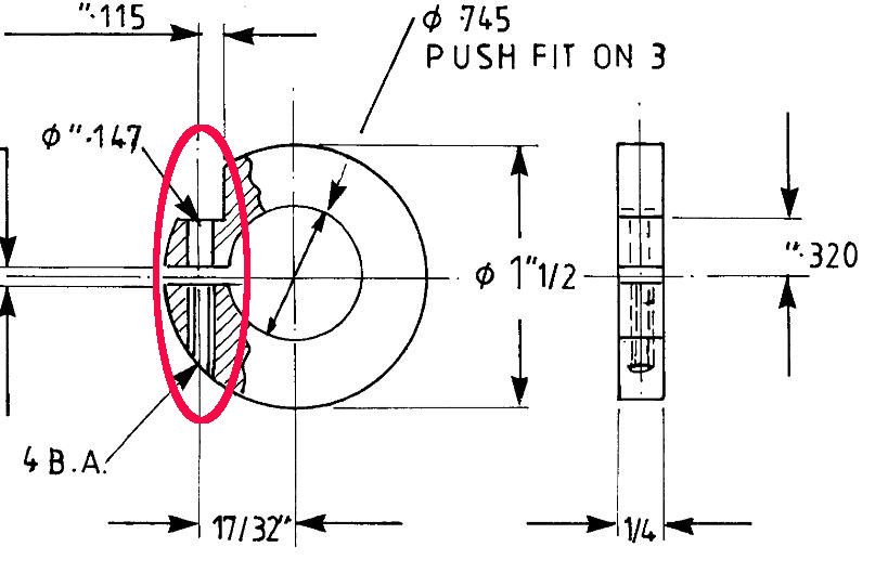

                Certainly says 8" lg but can;t see where it goes, second drawing here

                  Appears to screw in to item four the bottom collar, I wonder if it should be 5/8 or 7/8 and not just 8?
                  #578985
                  Peter Cook 6
                    @petercook6
                    Agree with Durham builder as to location. Suspect the length is [0].8", and the scan has made the decimal point invisible.
                    Edited By Peter Cook 6 on 06/01/2022 20:53:48
                    #578986
                      Another vote for Durham Builder.
                      Looks like the 4ba screw that clamps the collar, a bit over twice 0.320" long. Typo: could be 0.8" or ⅞"
                      #578988
                        I agree with Dave. I'd guess 5/8".

                          Beat me to it, Assy drawing states Item 4 and B for location. Made mine way back in Stainless (cos I had access to some), all metricated, my item 'B' is M3 x 20mm SHCS.

                            Hi, the socket head cap screw B nips the collar item 4 on page 2 of the drawing, which Durhambuilder suggests is 5/8", a 7/8" would protrude through the the threaded hole, though that may not matter. The socket head can be seen in the top drawing, shown by the circles 4 & B on page 1. So a M4 x 16mm should be OK.
                            Regards Nick.#
                            Well everyone beat me! P.S. there is no decimal point on the original drawing for the scan to miss.

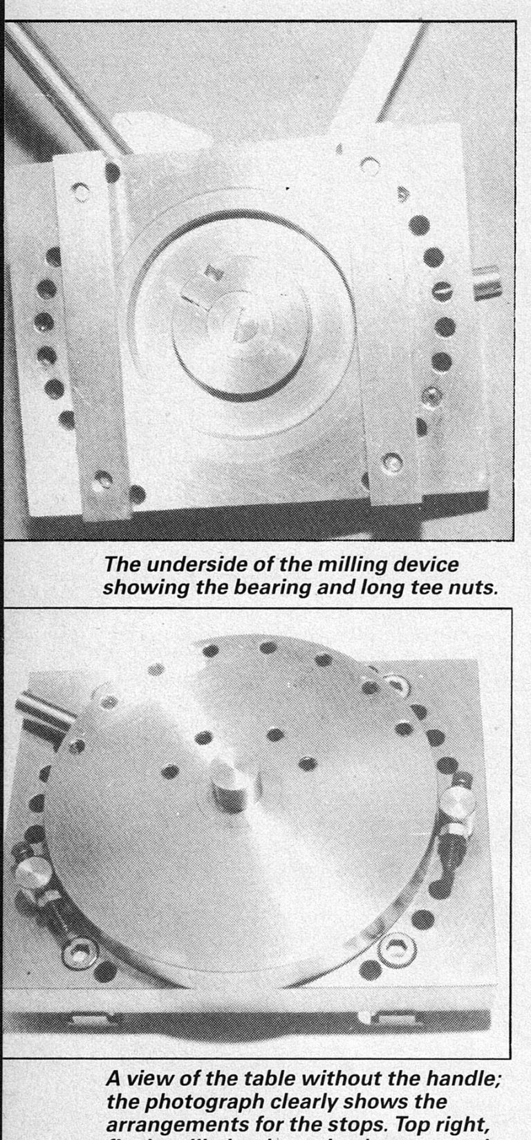

                                    There is a photograph of the underside of the assembly in the article but it has reproduced poorly.
                                    That would give confirmation of the way that the table was constructed.
                                    If anybody has a copy of the printed magazine it would be very helpful to have a high resolution colour photograph of the top of page 56.
                                    Although I have a digital and print subscription, the scanned image in the magazine in the archive is rather "washed out"

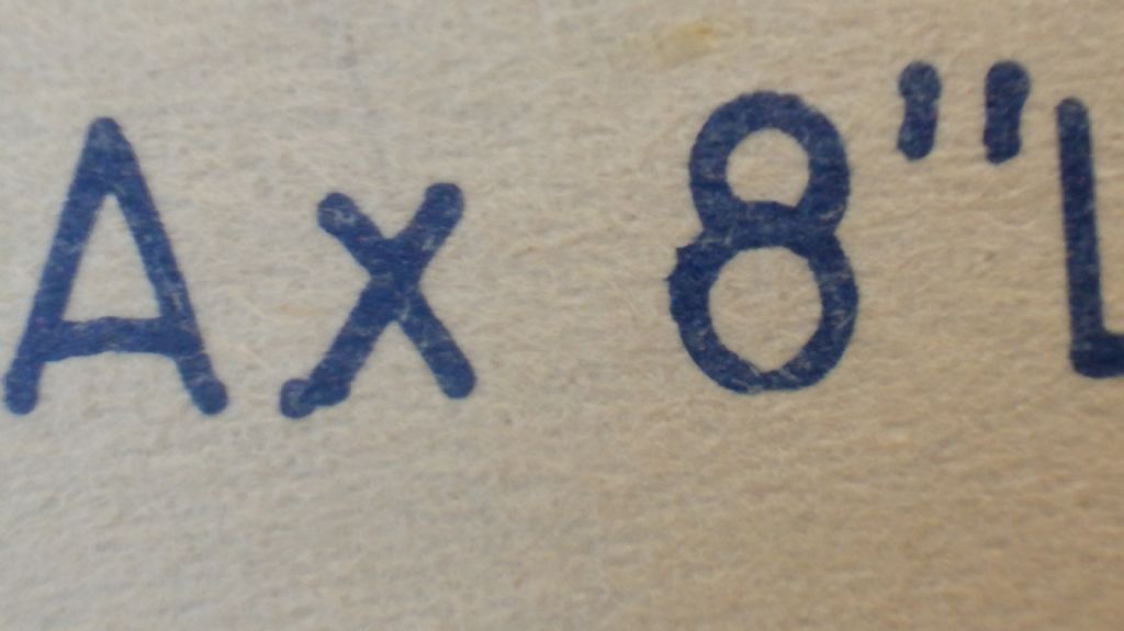

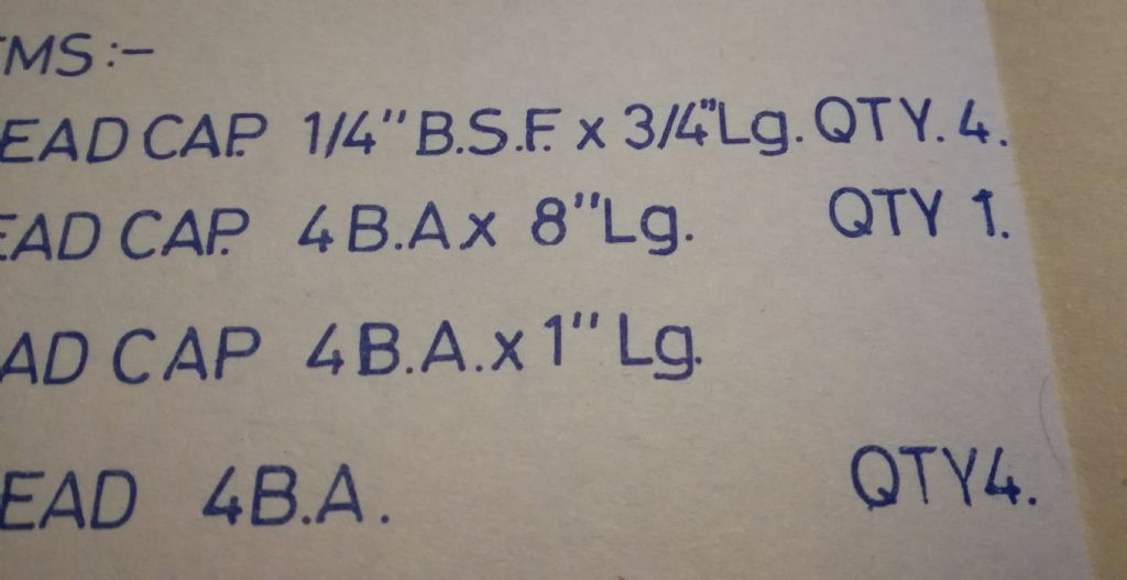

                                        Hi Dr. MC Black, don't know how they compare, but the photos in the magazine are not brilliant.
                                        For those that don't know, the free plans were printed on each side of an off white sheet of paper measuring 793 x 296mm and was folded three times and stapled in between the centre pages of the magazine.
                                        Below is a photo of the original drawing from the magazine, showing similar to the grab that MichaelG has posted.
                                        Regards Nick.
                                        #579027

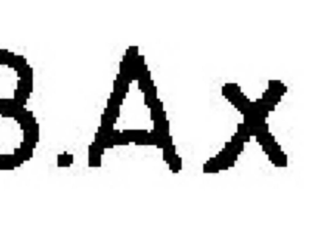

                                          Thanks for the post, Nick yes
                                          You are a star
                                          The resolution of your scans is now evident for all to admire:
                                          Comparing your photo of the print with my screenshot of the PDF we see that the dot which follows the A has not been fully resolved from the x [which is, of course, mis-placed]
                                          Edit: Demonstrandum
                                          Edited By Michael Gilligan on 07/01/2022 10:40:10

                                              Hi MichaelG, well spotted, I have never noticed that myself.
                                              Regards Nick.

                                                #579089
                                                  Posted by Dr. MC Black on 07/01/2022 01:04:29:
                                                  I was always taught … never to write a number less than unity without a zero in front of the decimal point.
                                                  Clearly the draftsman who created the scanned drawings never heard of that convention.
                                                  Clearly he knew the convention because it's used throughout the rest of the drawing! Just a typo I think. He made another minor mistake in the copyright notice, possibly not corrected because it's too much work by handargus_specialist.jpg:
                                                  I found it surprisingly hard to suss out Ⓑ. I didn't tune into the drawings well. If I were building the table, I'd redraw it in CAD to make sure I understood it.
