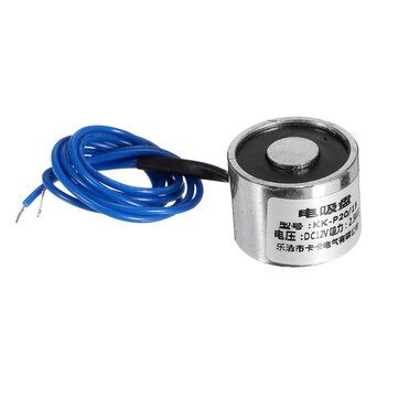

      Hello.
      I wish to make some levers to be operated by electro-magnets. The electro-magnets are a small version of the type that are used to hold open doors. What would be best metal to use for the pad that will be attracted to the magnet? I know that some types of metal retain less magnetism than others and are more suited to this use, but I cannot remember what. It is somewhat annoying, really, as I used to work with solenoids and electro-magnets all day long at one time and simply cannot remember.
      Thank you.
      James.

        #577085
        Tim Stevens
          @timstevens64731
          I would start by experimenting with mild steel – as it seems you are not sure of proportions etc yet. And – it seems that your application is not critical about size or weight, so although MS is not the most magnetic material, it has a major advantage as it is easy to machine, and some of the 'clever' magnetic materials can be difficult.
          When you know more about the factors applying to your application, such as the degree of magnetism left in the material when switched off, which may be critical, you will find it useful to look at a reference such as Machinery's Handbook, which list material with special magnetic properties. Then, of course, you will need to take advice on where to get such material without having to buy 30 tonnes at a time …

          #577090
          Robert Atkinson 2
            @robertatkinson2
            Steel. Mild is OK but when doing this sort of application in the day job we used gauge plate. We had it electroplated but the environment was fairly agressive. Don't go too thin, the force will be reduced.
            Iron will get magnetised.
            Robert G8RPI.

                @brianwood45127
                As you say the " keeper" plate will be a pad of some kind, I suggest cast iron might be suitable. It will still be attracted by the electro magnet but it will not become permanently magnetised in use which makes a clean release when the electromagnet is switched off.
                #577129
                Robert Atkinson 2
                  @robertatkinson2
                  Note that iron is more easily magetised than steel. It is also more easily de-magetised which is why it is used for transformers. As the holding electromagnets are DC they will not demagetise the armature (moving part). This will eventually result it it sticking even with the electromaget de-energised.
                  The armature should be STEEL not iron.
                  Robert G8RPI.

                      @bazyle
                      The harder the steel the better it is at retaining magnetism. The best iron for the job is pure iron, like genuine wrought or puddled iron from days gone by. (not the modern 'wrought' iron from blacksmiths which is just mild steel). You might find a bit in an architectural recycling salvage yard where they have a bit of Victorian ironwork that is going to be cut off and is too small for anything else.
                      With lots of old electronic items being scrapped there are transformers in them that might be useable. Transformer laminations are specially made from pure iron but with silicon added to increase its resistance to heat generating eddy currents in AC applications. Unfortunately for the same reason (eddy currents) that is why they are made from lots of thin bits insulated from one another.

                        @johnhaine32865
                        Mild steel should be fine unless the application is demanding. You can reduce the propensity for the lever sticking "closed" due to remanent magnetism by arranging that the air gap between the polepieces is kept very slightly open when energised, for example by a small non-magnetic rivet. This will reduce the holding force somewhat but greatly reduce the flux and so the possible permanent magnetisation.

                          Thank you for all of the suggestions. I should have given more details in my original request.
                          On and off, over a couple of years or so, I have been playing around with plans for a clock which uses solenoids to pull levers which will, in turn, pull the the clock wheels around. There are multiple solenoids, one each for the hours, seconds and minutes hand. The solenoids are controlled by an Arduino Uno.
                          I plan to make the mechanism from brass, but with magnetic pads for the solenoids to attract. I shall need to keep the weight to a minimum as the solenoids are quite low power and will need to overcome the weight of the mechanism and pawls. Maintaining an air gap is a good idea and should be easy enough to include in the design.

                                @johnolsen79199
                                It seems to me that what is wanted is a material with high permeability and low remananent magnetism. In less technical terms, you want a high amount of suck when the electromagnet is on, and a low amount when it is off. If it retains too much magnetism when the electromagnet is off, it will tend to stay in the same position even when released. Some relays had to have a little brass pip that made a gap when the moving part was pulled against the pole piece as otherwise they would pull in and never release despite the springs.
                                Anyway, soft iron is generally the most commonly available material that will fill the bill. Transformer laminations are also a very suitable material, and readily available from scrapped transformers, although only in thin sheet form. You may want to stack up a few pieces if you use that source.

                                              @robertatkinson2
                                              Do your "solenoids" have magnetic cores? I read the original post as they had. If they have fixed magnetic cores technically this makes them electromagnets, not a solenoids. A solenoid has no fixed magnetic core and the moving part is normally Iron. This works because there is nothing ferromagnetic for the core to stick to if it retains magnetism. The moving part attracted to an electromagnet, the armature, is normally made from a material thati s harder to magnetise. This is typicall steel.
                                              I think this subtle distinction between soleniods and electromagnets has caused some confusion as to a suitable material for the armatures.

                                                  Just to clarify any potential confusion that I may have caused:
                                                  For the clock that I am trying to design, there will be one electro-magnet operating a set of levers which will operate one wheel. There will be a separate set each for the seconds hand, another the minutes and so forth for the hours, AM or PM, day of the week, 1/4 strike and hourly chimes. Other than the hours and minutes, each other time division will have a separate dial, like a regulator.
                                                  The picture below is the type of electro-magnet that I am proposing to use and have bought.

                                                    @robertatkinson2
                                                    Use steel. If there is not a lot of force to pull it off put a thin nonmagetic (plastic aluminium etc) shim on the electromagnet to maintain a small gap. I'd expect maxium force in the contact positionfor you application so shim should not bee required.

                                                      Thank you, Robert.
                                                      I was curious about the strength of the magnet. A quick test shows that it can easily lift up a 4g nut vertically from a distance of 0.5cm. With levers, this should be enough for my purpose… with luck.
