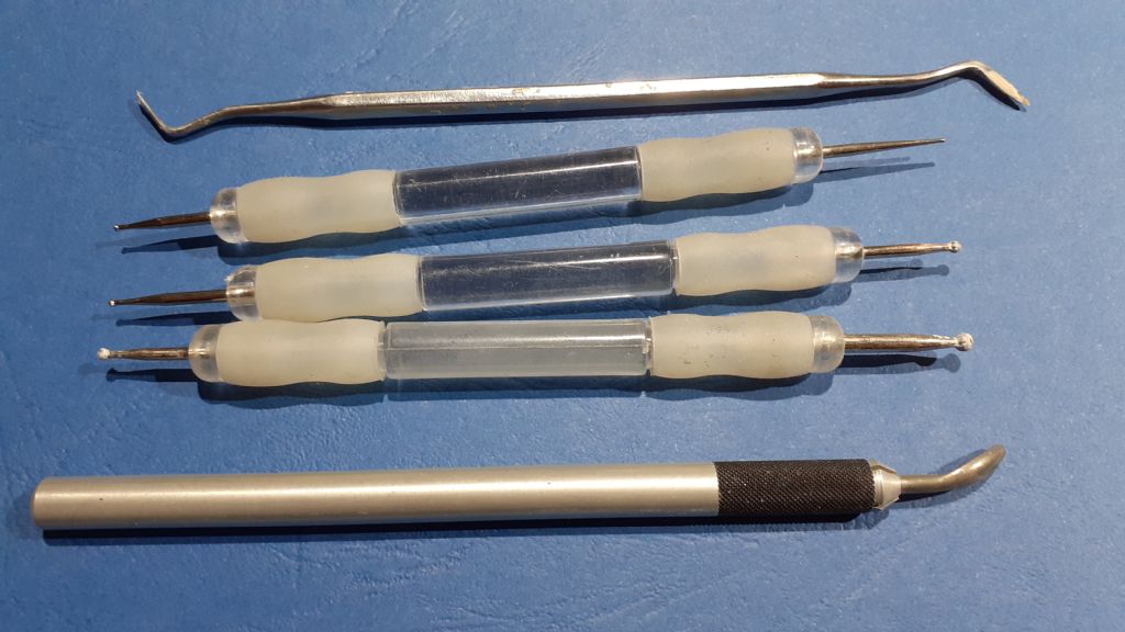

                              3) Finally – the radiused internal corners. I know previous advice was to use JB Weld with a thickener. Having now used JB Weld, and finding it's a bit messy, is there any disadvantage to using white Milliput? I'm comfortable using it from plastic modelling experience, and I think I can sculpt it quite easily into radii with some basic tools and a damp cloth. Is Milliput robust enough for this application?
                              Thanks!

                                I use Milliput quite a bit for internal fillets as it's easy to shape with a ball ended tool and wet paintbrush and there is almost no sanding. If you do go with JBW you may find it slumping to the bottom of all the vertical corners if you do plus there is then the filing and sanding to do a thickener or letting it sit for a while after mixing should see it stay where you put it. Car body filler is another alternative, better adhesion than Milliput and easier to sand than JBW,
                                Couple of items filleted with Superfine white.

                                  Ok thanks Jason. I’ll use Milliput for the fillets.
                                  I suppose the trick with JB Weld on the joints is to keep it off the screw threads so I can nip them up. I wonder if coating in Vaseline would do? I suppose no threadlock will be needed, since the counterbores will be full of JB Weld / Milliput eventually. Then again I could sequentially remove the screws after curing, then remove-fit with retainer?
                                  What ball tool do you use for smoothing? Ball bearing stuck to a stick or something?

                                    You can stick a ball onto the end of a suitable handle or just round over the end of a rod. I tend to use these which are from my figure modeling days. Top one is used to apply a run of Milliput then dip the ball in water and draw along the corner. With luck you will get a nice fillet and two strips of waste material which are easily picked off and put back onto the pile. Wet artists paintbrush for a final clean up.
                                    Yes some sort of release agent will allow then to be used to line things up but still turned when you need to tighten. I'm not keen on Milliput for filling over screw heads, usually opt for body filler, U-POL Easy was nice but now hard to get in smaller tins so have gone over to U-POL rapid but it lives up to it's name and is also a bit runnier so watch out.

                                      Thanks Jason – I'll get a set of those FWIW, they only seem to be a few quid off Amazon.
